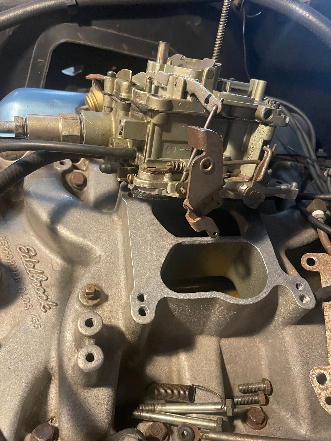

Hi All,
Looking to swap out a rebuilt but worn out 750 QJet and want to try something new & reasonable - Holley, Demon, Edelbrock. Prefer vacuum secondary's & electric choke. Want something that will get off the line quickly and smoothly, and will still get ok mileage if right foot behaves.
71 Cutlass Supreme Conv. with a rebuilt '73 - 455 bored .030 over, forged 10:1 pistons, 3 angle valve work on stock heads
Compression: originally 8.5:1 - approx. 9.+:1 now
Comp Cam: 42-208-4 (everyday perf dual pattern) Lift: I=.472 E=.486 Duration: I= 265 E=273
Exhaust: Hooker Headers w/ 2.5” pipe & turbos
Carb: 750 QJet on Edelbrock Performer Olds 455 alum intake
Trans: 1971 TH350 w shift kit & perf clutches; higher stall T Converter
Open 2.73 rear end (& yes a 3.31+ posi would be better for sure, but not in the cards currently)
Tnx for your recommendation & expertise!

Thanks Folks, much appreciated. I do love the stock QJet look and spread bore design. My 750 QJet is worn out - fuel inlet JB welded, runs dry after a couple of days (even w/epoxied plugs). I just want to get in and go w/o having to pouring gas into the carb. Afraid a new QJet might have same issue. Ok to go with straight bore Holley or Edlebrock? My performer intake will accept either bolt pattern.
I'm leaning towards either a Holley 4160 750 or a EB 1411 750 (prefer vacuum secondary's and this one is not).
