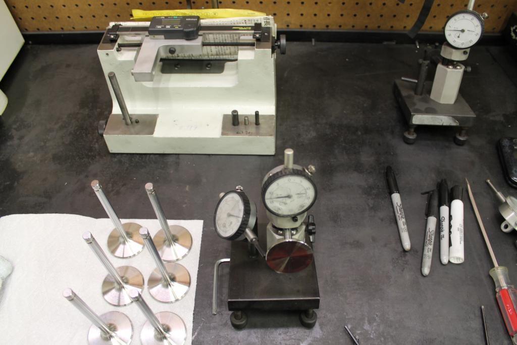

Post up some pictures of your valve checking equipment, I'd like to see what you use? I've run a machine shop for 27 years, I've seen valves for all types of engines, SI is in Simi Valley, next to Thousand Oaks, it was very easy to go over there and get what I needed, more often than not the quality was not up to my standard, usually stem problems. It all comes down to the type of work you want to do. Maybe things have changed over there? Post up some pictures of what you use to ck valve dimensions.

Do you set size on valve guides yourself? Do you cut seats yourself? If not how do you ck the work?

Can you post up some pictures of your valve checking equipment? Maybe SI is better now.
