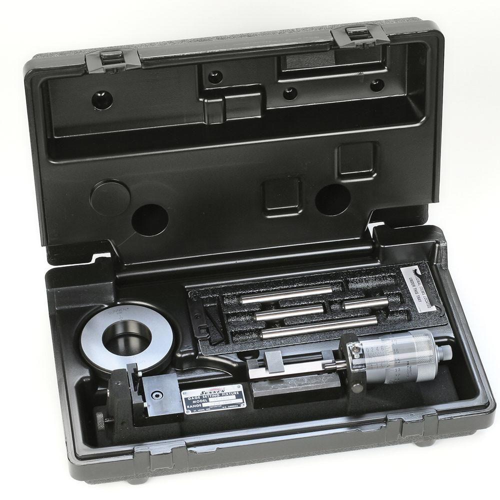

1. Measure the main housing bores and make sure they are in spec with no taper
2. TQ up the mains with the bearings installed
3. Measure the bearings with a SUNNEN dial bore and note sizes 1-5
4. Have the crank ground by a competent shop based on your measurments, I give the # 5 main journal an extra .0005 clearance
5. Ck the clearances again after the crank has been ground and CK the run out on the snout, rear main seal journal, and #2 #3#4
