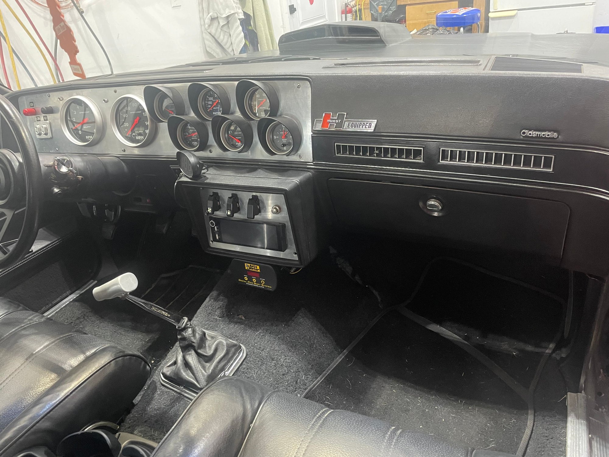

well I don’t really know what or how these were set up inside as far as duct work but I do already have the box and controller
I’m hoping if I can get the air conditioning in and it blows out the main duct should cool down the car somewhat
