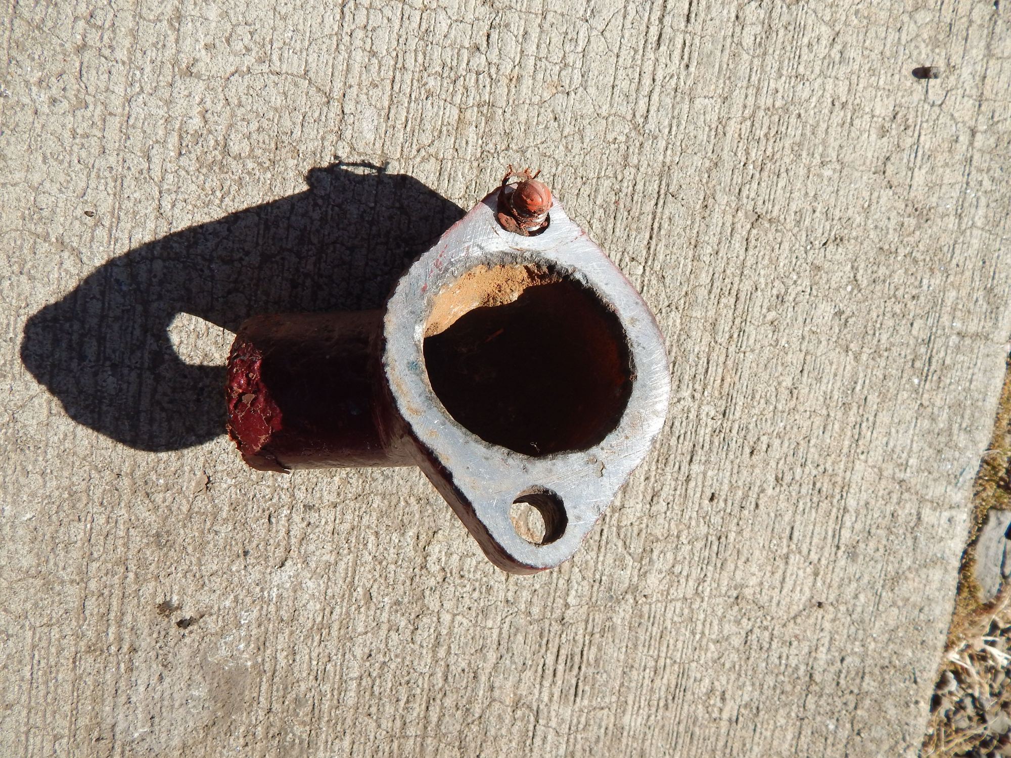

I got around to pulling the water neck off the 394 this weekend. LOL yea this casting was "weeping" a bit. Once cleaned up the damage was a lot more visible. Pretty bad corrosion.
I've got an add in parts wanted for one - 1964 4 barrel 394 please.
I'm pursuing a another avenue also though. Seeing as I work for a company that sells 3D metal printers I'm trying to get a favor done. Maybe I'll be the first guy running a custom printed titanium water neck soon. I'll keep you posted ...

I may be in the same boat. Got the '63 out of the garage Sat and found a coolant puddle on intake around the housing.

A couple of skim cuts on a milling machine would clean that right up.

Those are holes Paul... I don't think milling it will help those.

I didn't see the holes at first.
When I changed the thermostat on my 64 Olds 98 years ago, I apparently used a 5 ft. breaker bar to tighten the bolts. This caused one of the flanges on the thermostat housing to crack. Luckily I was able to get it repaired by a welding shop. Perhaps a good welding shop can repair that?
Let us know if you get some time on a 3D printer.

Yea the mating surface is no problem! The top is paper thin and holed. The underside pic doesn't show as well, but its really ate away in here. Maybe a really talented welder could puddle something in there, but I think the whole top would just melt off.
It can be fixed, anything can. But I hope my other plans work out first. I AM taking this car to the homecoming come hell or high water, so I got 6 weeks get it done.
