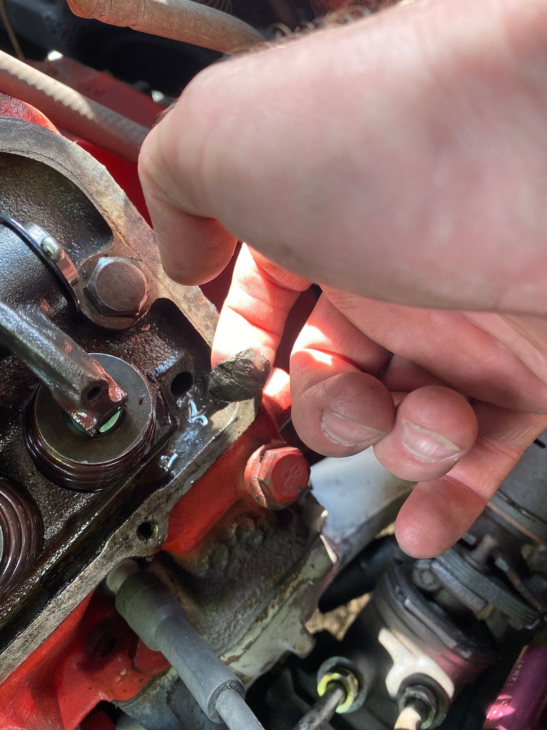

Now the actual problem... Once again I felt like I needed to have a closer look, simce the tapping kind of increased, dissapeared amd came back.

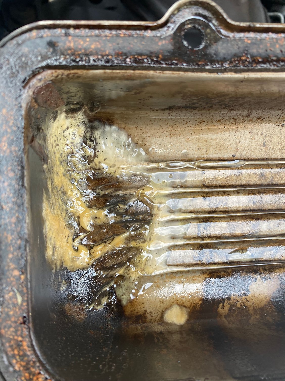

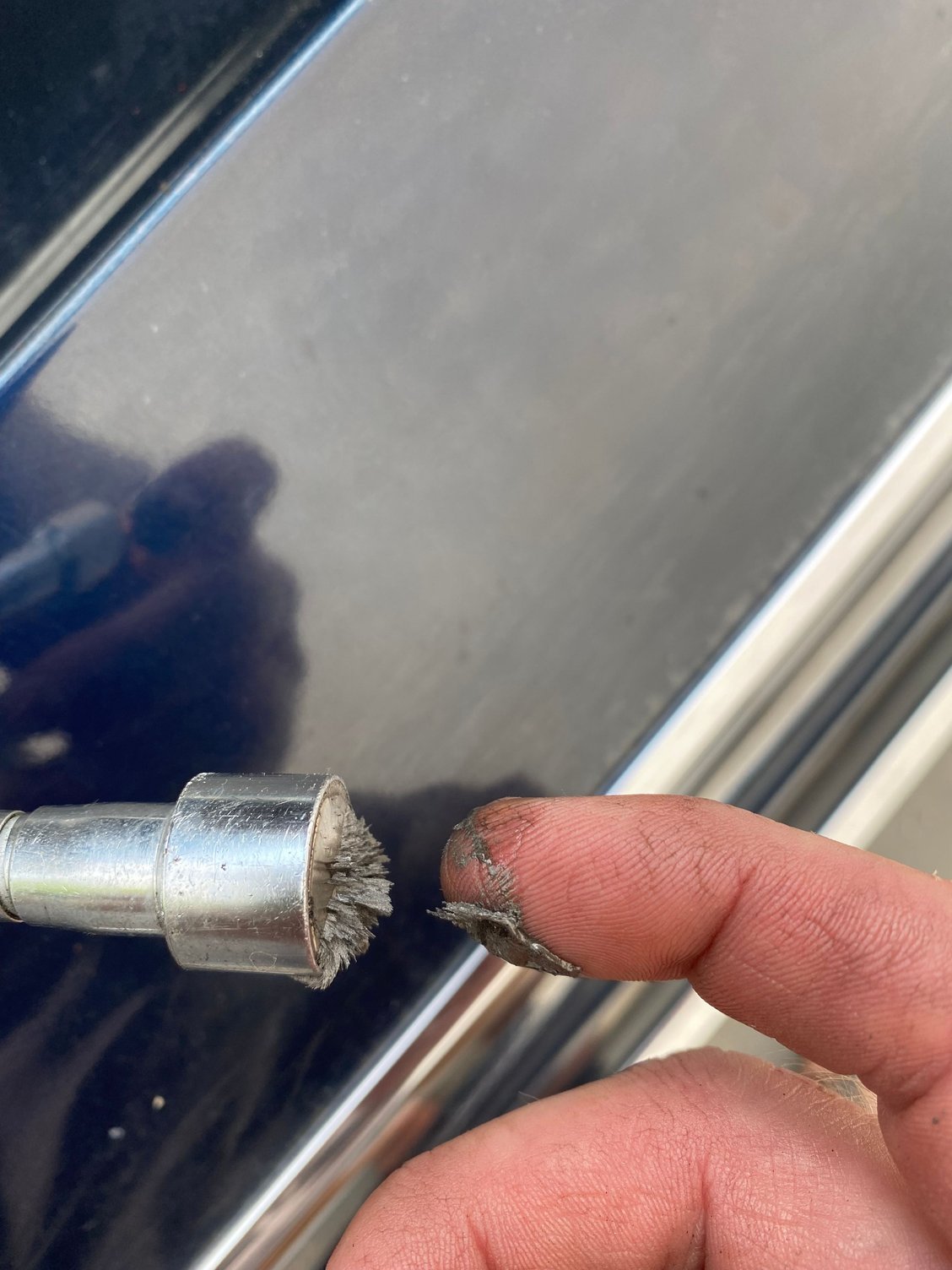

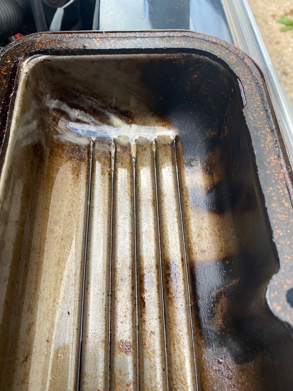

I removed the valvecovers. At the drivers side I found the white snot which Imassume is cause by bad ventilation since there is no breather in this valvecover. Then I got sad as I found a grey creamy paste of metal in the rear of the head by the oil drain hole.. without discussion it was worst in the drivers side. The paste was tested with a magnet.. it was metal for sure!
I have replaced the engine oil Very often, and have not found any glitter in the oil surface, I even had a finger up the drain hole in the pan a few times without getting sludge on my finger.

One thing I did notice before and after the start up was cylinder 3 was different than the others... the spring for the exhaust valve can be moved a little bit under the rocker arm, and the pushrod for the intakevalve can be moved up and down a tiny bit. All other rocker/valve/spring are firm... pushrods can be turn with fingers, but are not looses.
