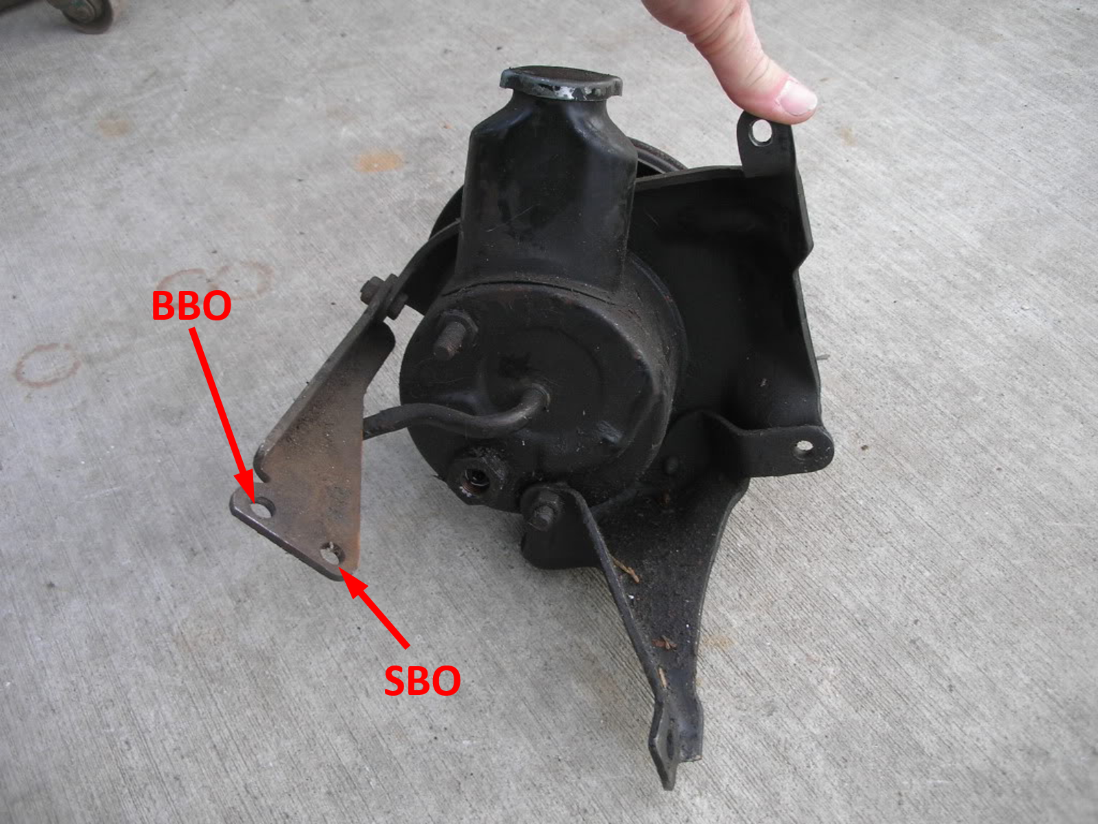

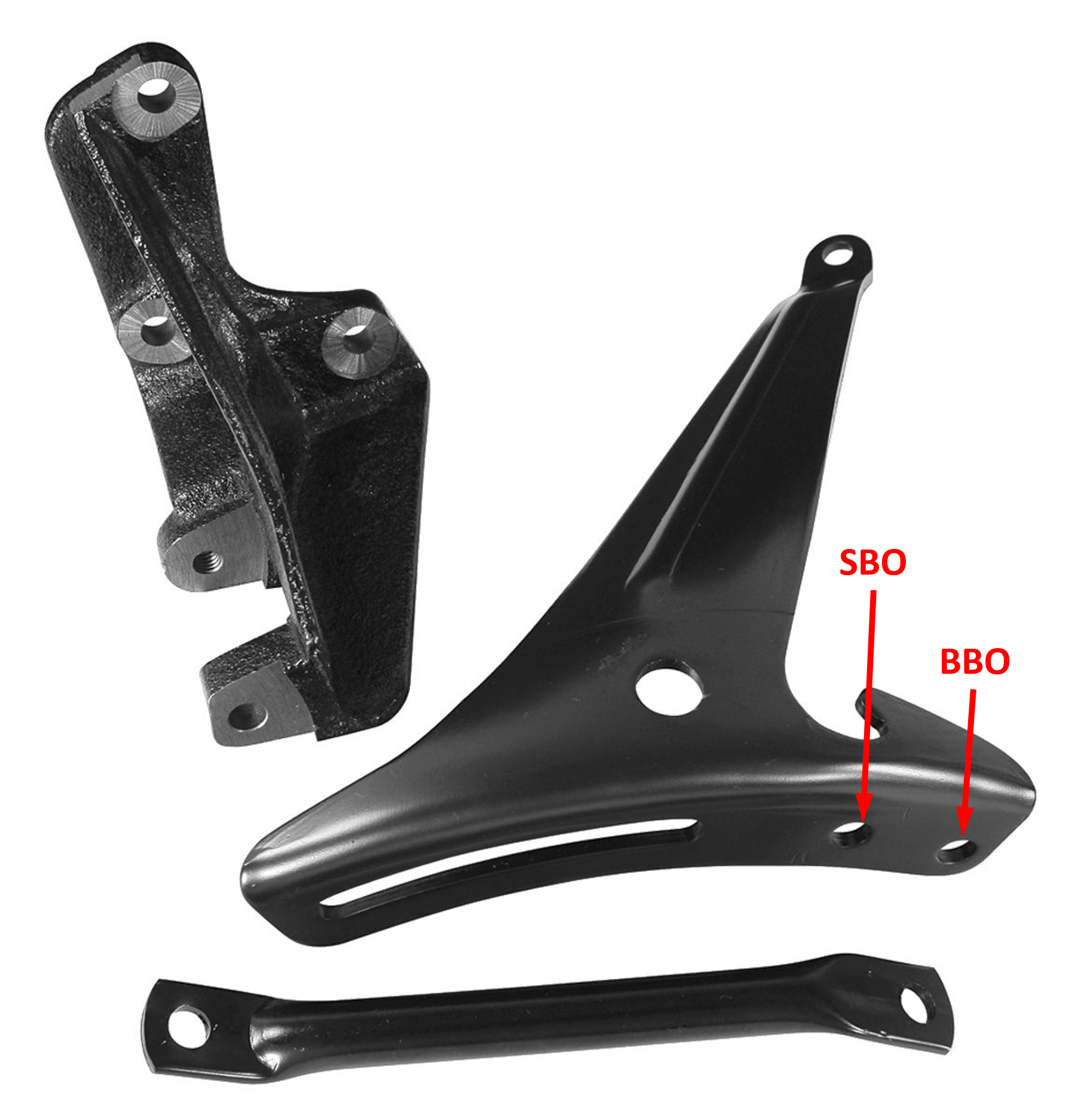

Those water pumps are the same. Most vendors show them as 5.1". Be sure to use the pulleys that match the pump. The non-A/C alternator top bracket has two holes where the strut that runs to the water pump stud attaches to the bracket. You need to use the hole that is closest to the pump for a BBO. Same thing for the triangular bracket that runs from the back of the PS pump bracket to the first exhaust manifold bolt. There are two holes where it can bolt to the manifold bolt - one for BBO and one for SBO - to account for the deck height difference.
