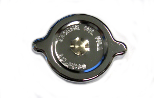

Paul, being concerned with originality, look into why your engine has the wrong oil filler cap for 1970. It should be the AC FC-60. (I grabbed this image which shows the correct look but that chrome finish and rivet indent style were not used on OEM caps.)
1969 Oldsmobile Cutlass/442/F85 CUTLASS 442 ENGINE OIL FILL CAP AC-FC60 CORRECT - NEW CHROME OIL FILL CAP AC-FC60. USED ON ALL 1968-70 OLDSMOBILES WITH 350 400 OR 455 ENGINES. AC-FC60 IS STAMPED ON THE CAP ALONG WITH ENGINE OIL FILL | EN10965T
Also check your engine's VIN derivative code because a serif "F" indicator does not rule out the block being made later than the 1970 model year.

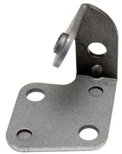

Repro dashpot brackets are available....here's one of them...
https://www.inlinetube.com/products/...T2RtHPzFcKxVrU
As far as the dashpot itself....there are various versions out there in the aftermarket parts business....none are EXACTLY correct to original (I believe) but may suffice. You'll have to do a search. Or you may be able to find good used originals or NOS (big $).
Is that a 442 and/or 455 thing? My 1970 350 has the style cap in the OP's picture.

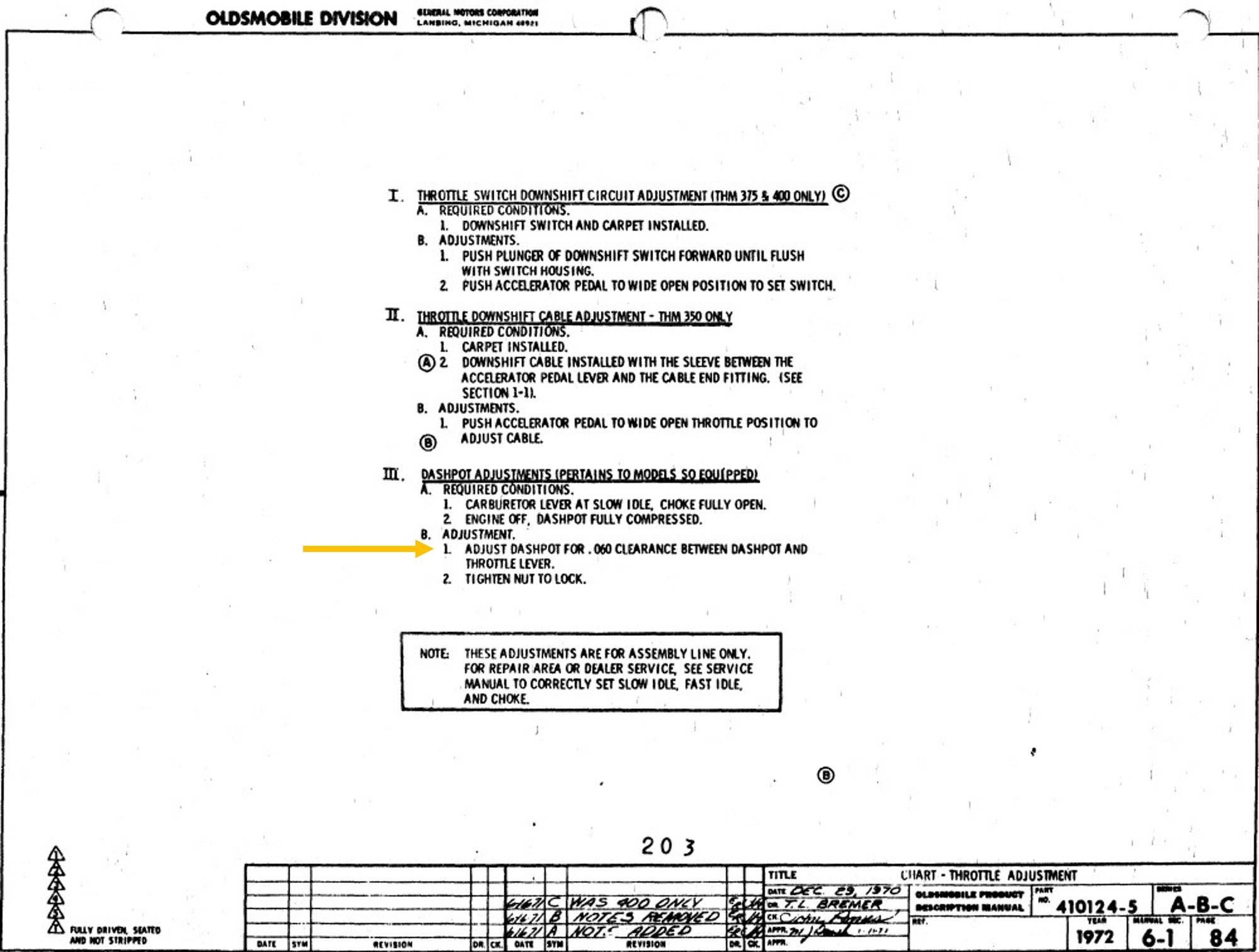

Curious what operates it? Vacuum or electrical
Old Mar 6, 2026 | 07:09 PM
Posts: 25,789
Neither vacuum nor electrical - it is not actively controlled.
https://classicoldsmobile.com/forums...st#post1430987
Old Mar 6, 2026 | 07:11 PM
Posts: 25,789
As explained (by Joe) in the link I posted (above) ^^
That particular dashpot isn't actively controlled. It's just a spring-loaded plunger with a diaphragm. It has no idea if the A/C is on or off. All it knows is that when the throttle arm on the carb hits it, the spring compresses, the plunger moves, and the diaphragm slows that process.
Old Mar 6, 2026 | 07:30 PM
Posts: 25,789
Anticipating your next question might be an adjustment for fitting this dashpot. I'll save you the time hunting...

I found a dashpot, looking for the bracket - would prefer an original - anybody happen to have one I could buy?
Old Mar 7, 2026 | 05:36 AM
Posts: 25,789
1968-72 Oldsmobile Cutlass Dash Pot Bracket 1pc
