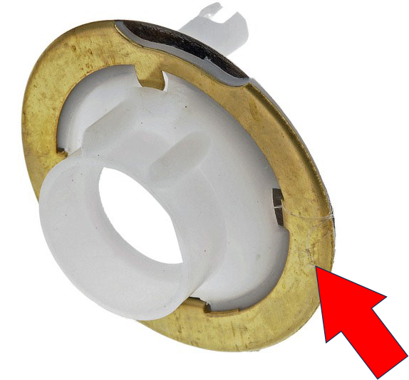

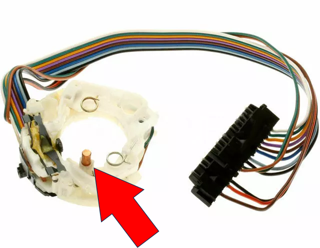

Gentlemen Apologize for the long delay. A couple of issues have devoured my time. To answer Joe's query the bearings in the column were shot so we attempted a new column. The column fit but the horn was inop. This continues to be the issue we are trying to solve. My mechanic has tried a couple of remedies but the horn continues to be a frustration. The issue seems to be centered in the upper structure with the contacts not meeting to make the circuit that allows the horn to work when the horn button is pushed. Do you have any suggestions on our next step?
Old May 27, 2024 | 06:19 AM
This is not a complex system. The turn signal switch has a spring-loaded post that is the horn contact. This post contacts a circular conductive ring on the bottom of the cancel cam. The top side of the cancel cam has a post that holds another spring-loaded contact, and this is what makes contact with the steering wheel horn button. All this system needs to do is close the circuit to ground between the post on the turn signal switch and the steering shaft. Start by removing the steering wheel and cancel cam and seeing if a jumper between that post on the turn signal switch and ground causes the horn to blow. I assume you've verified that simply grounding the terminal on the horn relay that the black wire connects to causes the horn to work, right?

Joe My mechanic has done all of what you said but he relates that the the contacts are "short" by about 1mm. when he puts it together, Have you experienced that in your years of Oldsmobile wizardry?
Old May 29, 2024 | 12:43 PM
Then it isn't assembled properly. And "short" where? Between the turn signal switch and the cancel cam or between the cancel cam and the steering wheel? There are different length pins for the latter, but the former isn't possible if the column is assembled correctly.
