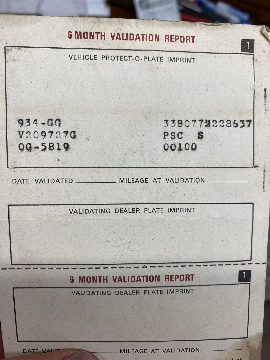

Hi All- I have a 67 442 and have the original protecto plate for it. Other than the VIN, I’ve never known what the other markings mean. Can anyone decode this for me? Thank you for any help

The V and OG are the engine and transmission numbers for warranty purposes. Also useful to document presence of original drivetrain.
I'm not 100% on the other fields but someone here will know.
Old Jul 9, 2023 | 07:50 PM
Posts: 12,796
934 GG should be trim and paint.
Do not lose that card.
Hairy Olds's Avatar
Shoveling Snow
Joined: Aug 2008
Posts: 2,731
From: Yoder-Hey-Land
OG-5819 is on the trans ID tag
V209727G will be on the pass side head facing forward
934 is the trim code and GG is the paint code
Old Jul 10, 2023 | 06:23 AM
Posts: 50,800
I'll add that the V209727G and OG-5819 engine and trans unit numbers are both consistent with a 1967 442. FYI, this is the only way to prove that a 1967 Olds is "numbers matching", since the numbers don't actually "match" the VIN. The P-O-P ties those unit numbers to the VIN, however.
Trim 934 is a Champagne bench seat interior for a Sport Coupe
The GG paint code is Gold lower and upper body colors
The 338077Mxxxxxx VIN is a 1967 Olds Cutlass Supreme Sports Coupe from Lansing. In the 1967 model year, all 442s were based on the Cutlass Supreme model line, thus the Cutlass Supreme VIN.

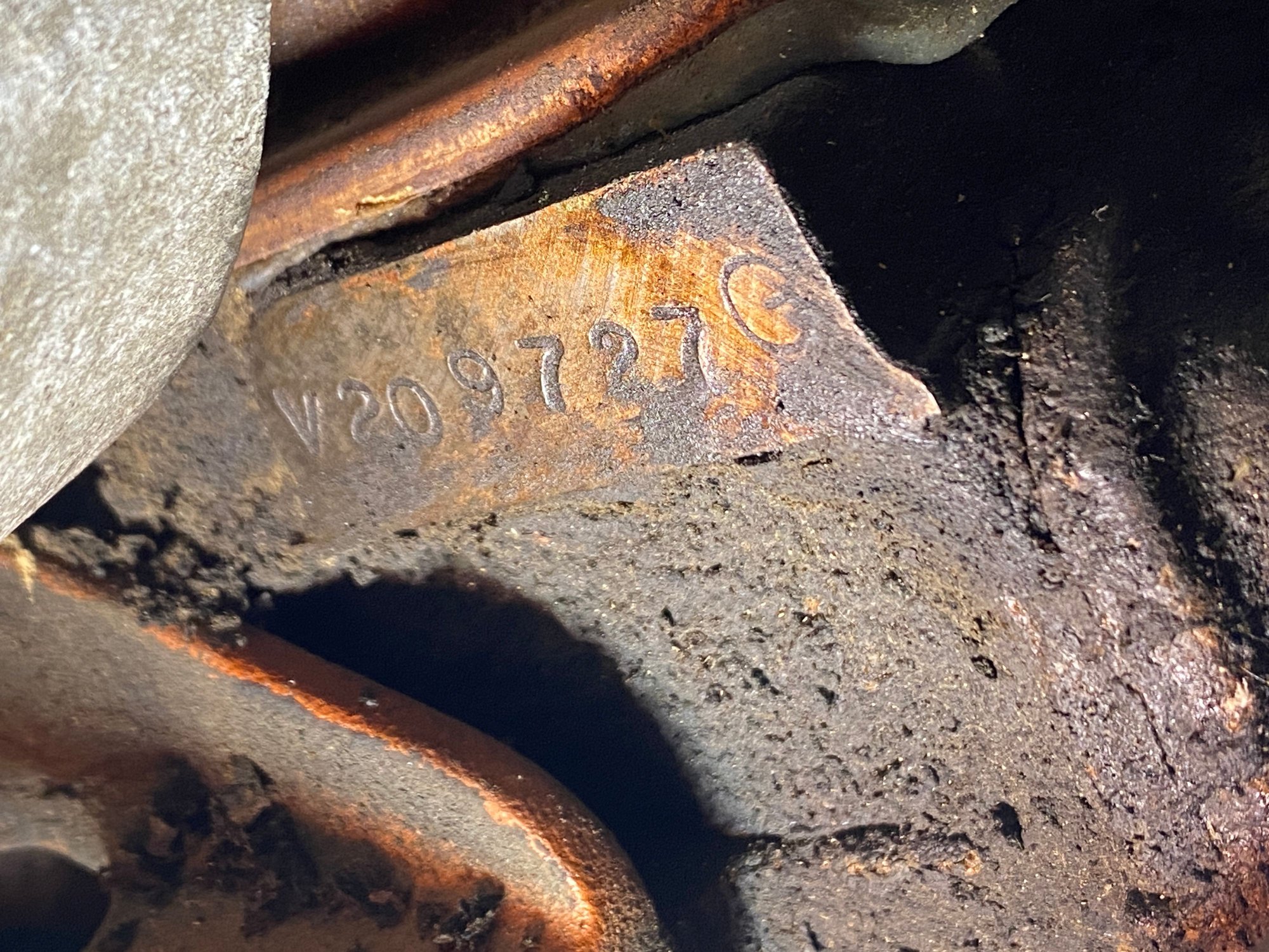

Thank you guys for the clarification. I will have to get out there and check the ID on the trans and block.
Old Jul 10, 2023 | 06:26 PM
Bigdibbs88's Avatar
Joined: Jul 2023
Posts: 27
Found the matching engine number, will have to do some serious cleaning of undercoating to see the trans tag
Old Jul 10, 2023 | 06:28 PM
Posts: 50,800
Very nice!
