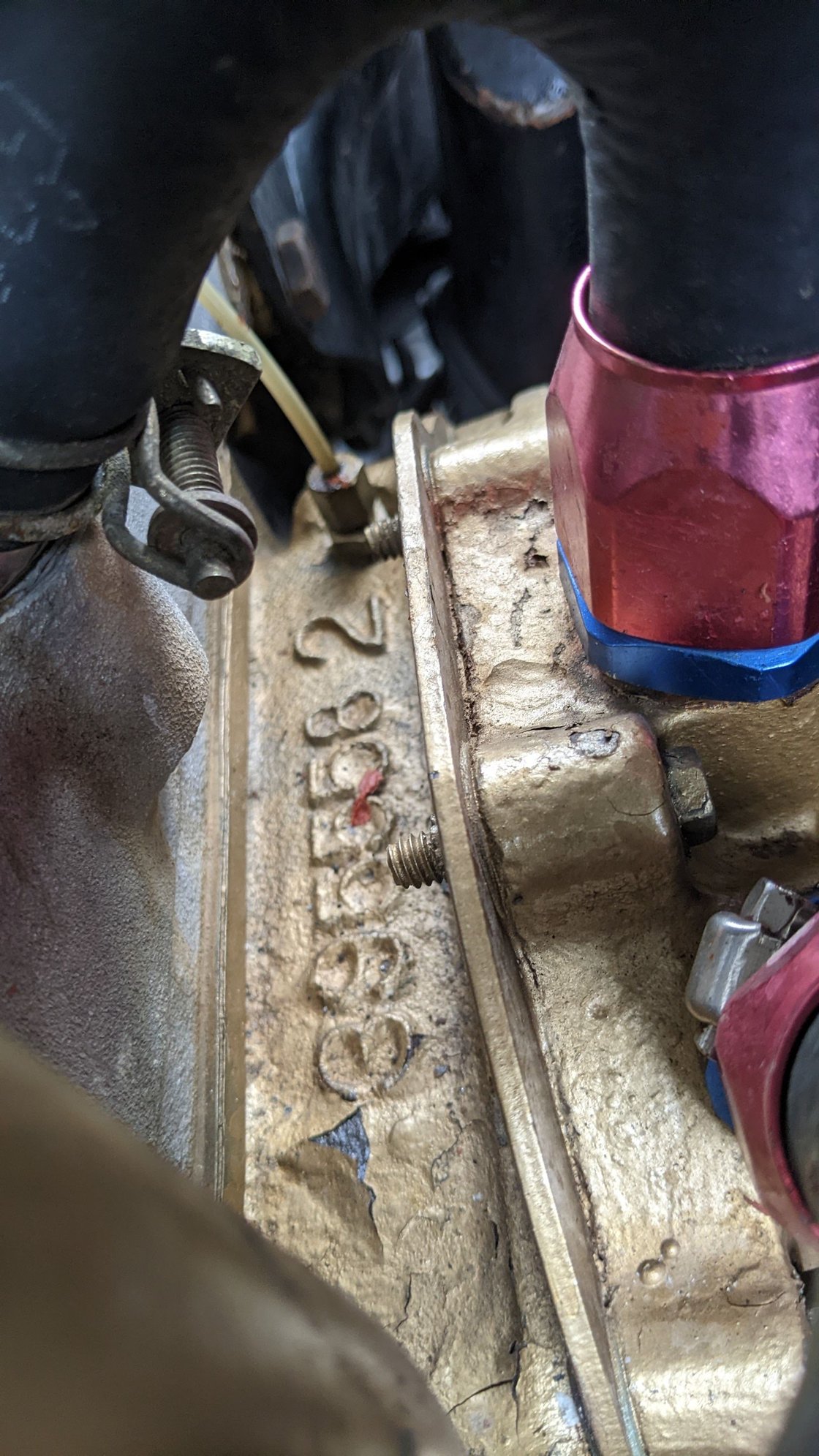

So one more question, the 3955582 casting number means its a 310HP 4BBL correct? Asking because its got plugs(R43S) for a 325 HP and the ignition timing would be wildly different.
Thank you!
Old Dec 27, 2021 | 04:55 AM
Thank you!
That casting number was used on every 1968-1976 Olds 350 block. Assuming it has the high compression pistons and is an original 4bbl and not converted, then yes the only 4bbl 350 motors available for the 1969 model year were the 310 HP L74 and the W31.
