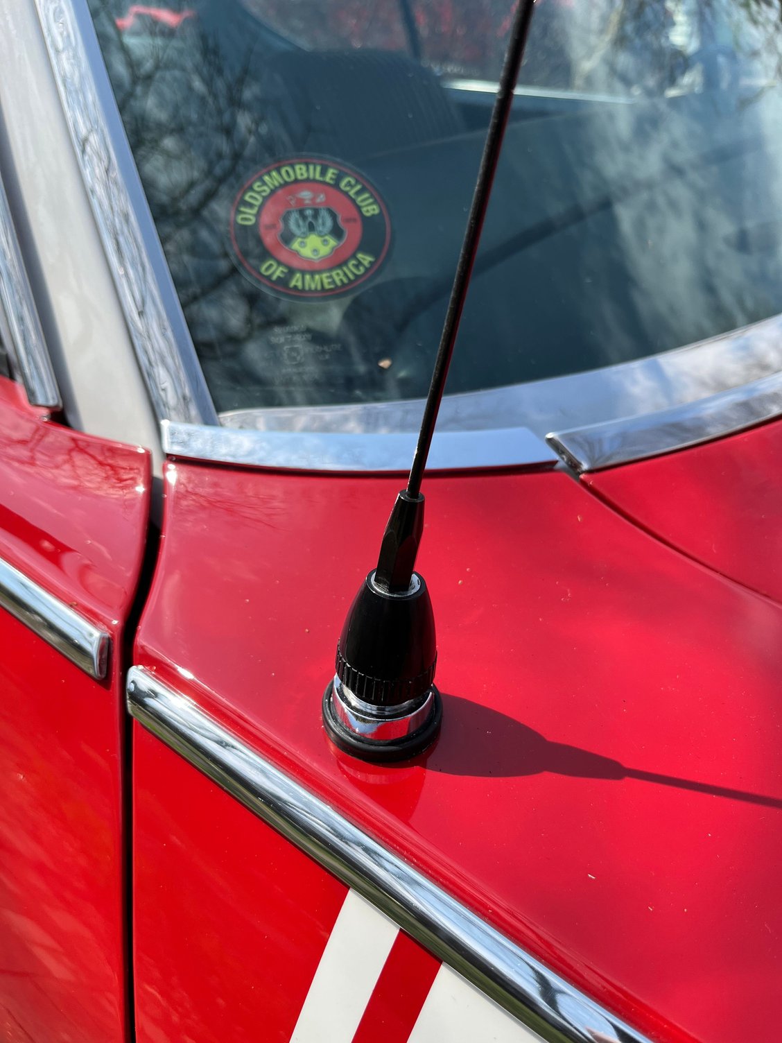

Thanks. Here is what I have. I guess I just have to change the mast. —Billy

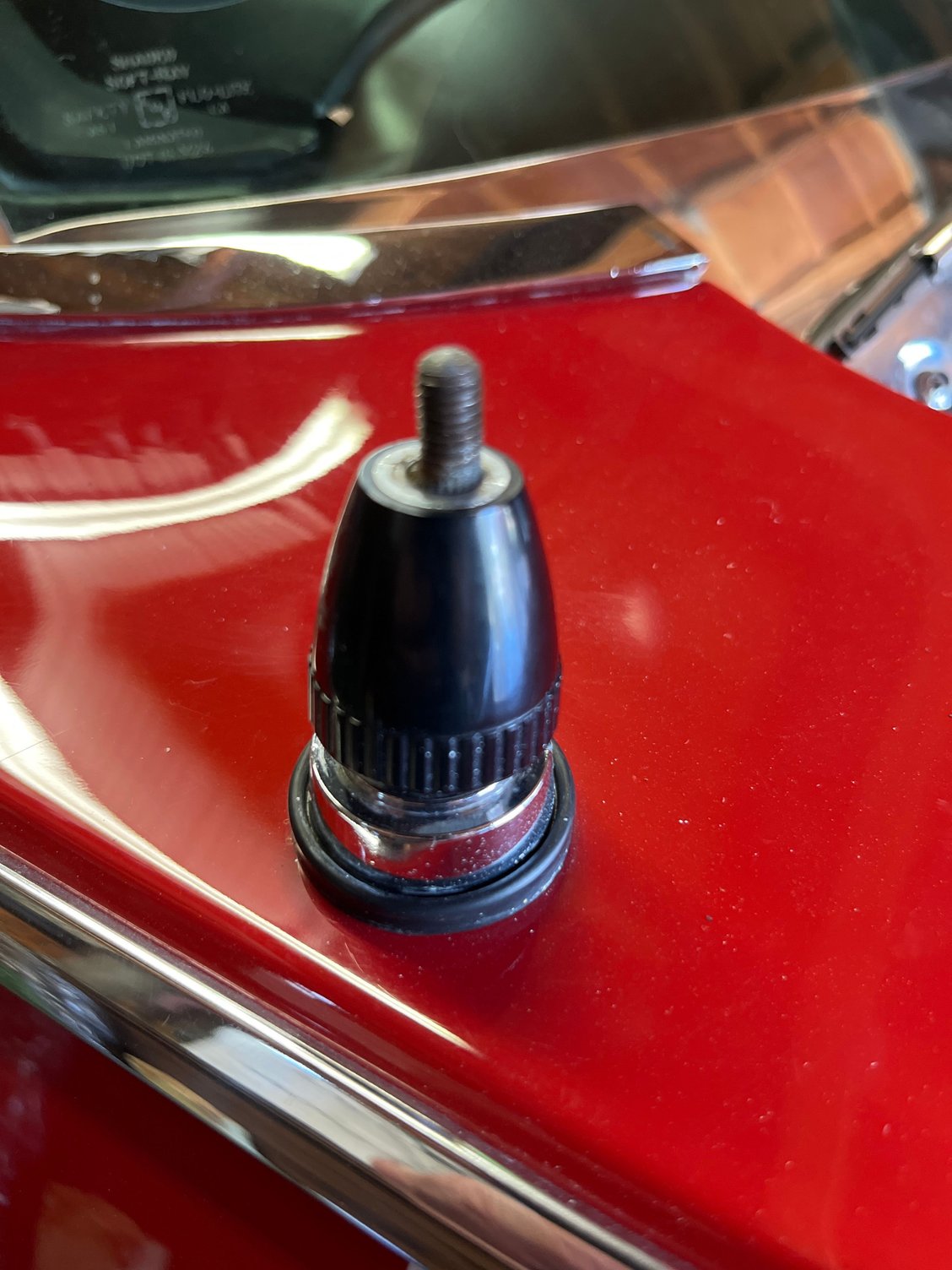

If I acquire the original mast will it screw on to this? —Billy

alleyolds68's photo is correct. My Cutlass had the same antenna, black base, oval mast, bullet tip. I bent mine because the first section is taller than the roof, and when I first attempted to park my Cutlass under my lift (which leaves only ~1.5" of margin above the roof) I bent it bad enough to need replacement. I ended up w/ a generic 3-piece mast antenna that can be lowered into the fender to avoid that mishap again. I never realized that an OEM replacement was so difficult to find.

Funny story. So do the original masts that don’t retract into the fender have a thread that I’ll be able to make an easy change to go original?
