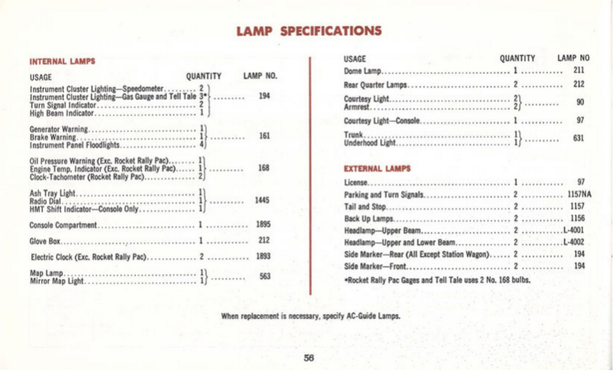

Which are the correct bulbs for the Instrument Cluster? Who sells them?
I just need the panel lights, not blinkers, warning lights or brights indicator. And which ones are the panel lights?
Same for the Tach, what bulb do I get?
Any help would be appreciated.

Evidently you have a 4-4-2. This may be some assistance...

The instrument cluster in the photo is 64-65 F85

At the risk of sounding like a broken record, this is yet another reason why you want a Chassis Service Manual. The bulb table is on the last page of Section 13 Electrical
