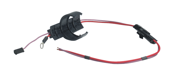

I found a 3 gal plastic bucket upside down works about right height. I also splice the small wires and put push together connectors, and make it easier to take off and install.
Old Feb 9, 2023 | 01:26 PM
I use the Moroso starter harness that comes with the connector. It clips to the solenoid and helps keep the wires away from headers.
