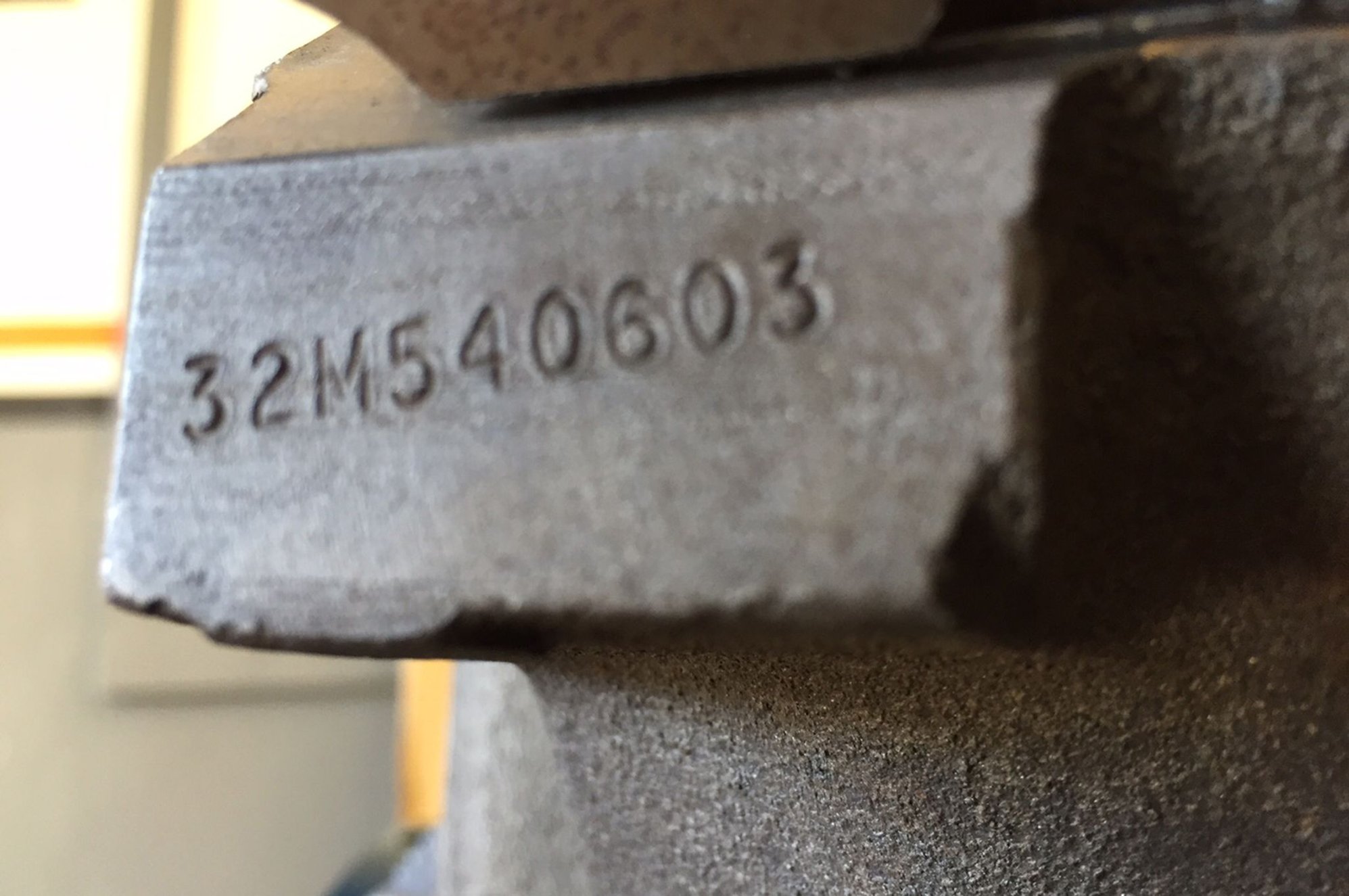

..... A factory VIN derivative stamp is nine characters on one line and looks like this:
Wow..obviously no gang holder involved there. Can't imagine the logistic element of whacking EVERY production engine 9 times just to put a Vin derivative on that pad. and then repeat the process on the transmission.
I'm struggling with this.
Yeah, I don't understand why this one looks so crappy. Of course, that's the first image I grabbed. Most others do look like they were gang stamped with a holder.

Ahhh, now my spinning mind is slowing down. thanks for that. BTW, would that 32X stamp be from a 72 "L77" ?
X Fairfax Assembly Kansas City, Kansas United States
1947 1987
Big car plant. The X on the engine denotes the assembly plant, not the engine code in the VIN.

This is either a rebuilt or replacement engine that was not stamped per the factory requirements. If the dealership replaced the block, they were SUPPOSED to transfer the VIN derivative stamp to the new motor. Of course, that frequently did not happen. Repair shops often used their own code that was somehow tied to warranty info. A factory VIN derivative stamp is nine characters on one line and looks like this:
The M in this sequence does not look like the M in the other stampings, looks more like an upside down W.
It's a random picture I stole off the web.

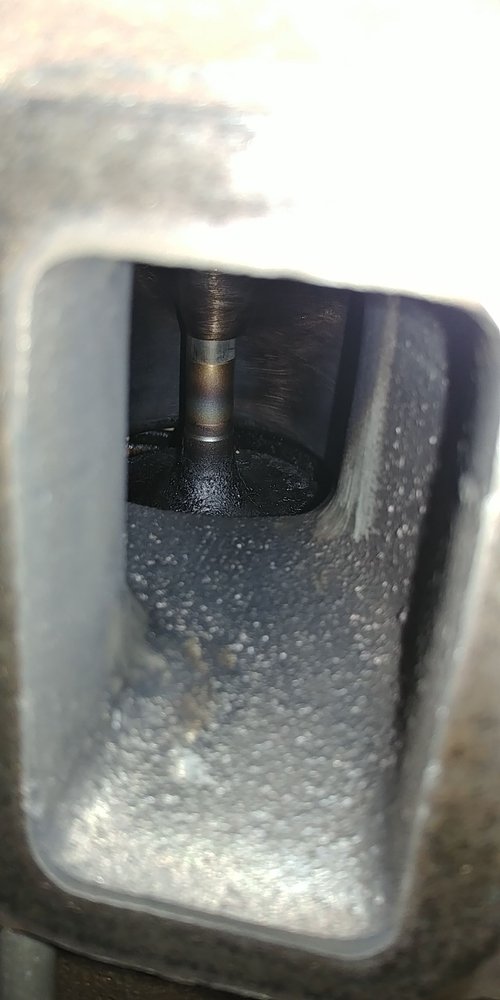

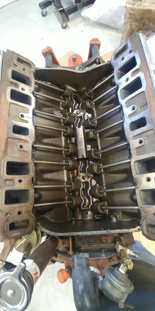

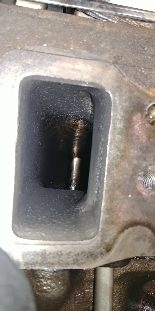

I also popped off the intake manifold and valve covers since this is a 'mystery motor' and found someone's been in it since it has ARP head bolts, and the intake chambers look like they've been ported some.
There's a little carbon buildup on the valves, but overall it looks pretty good to me. It ran great with good oil pressure and I checked cold compression that ended up being around 120 psi after sitting for about a month.

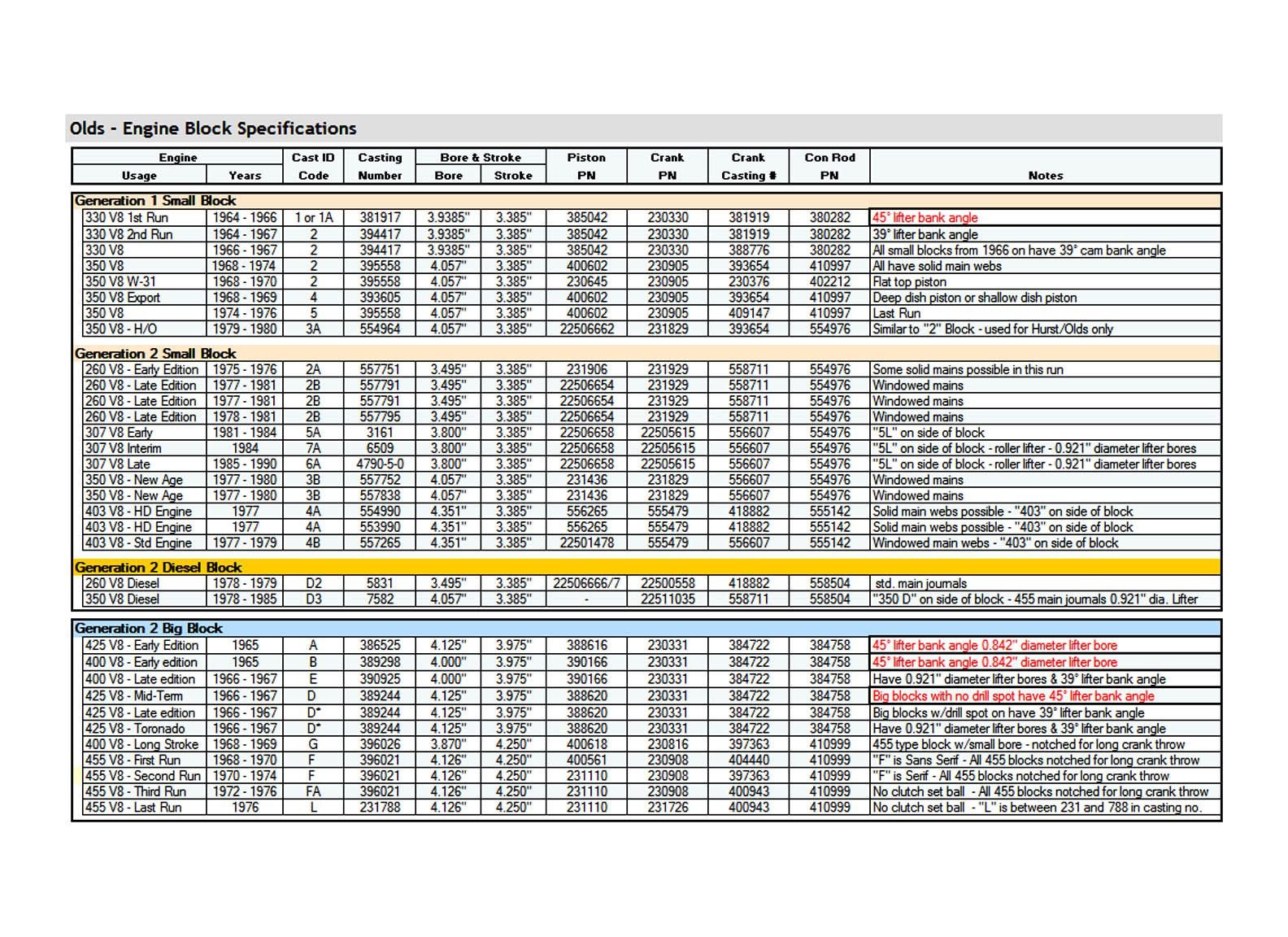

This reference says "396026 G" is a 68-69 400 block.
wildaboutcarsonline.com/cgi-bin/pub9990262549620.cgi?fullimageflag=1&imagenumber=1 &itemid=9990378649894&categoryid=9970399476565

It would be nice to have a chart for heads.
