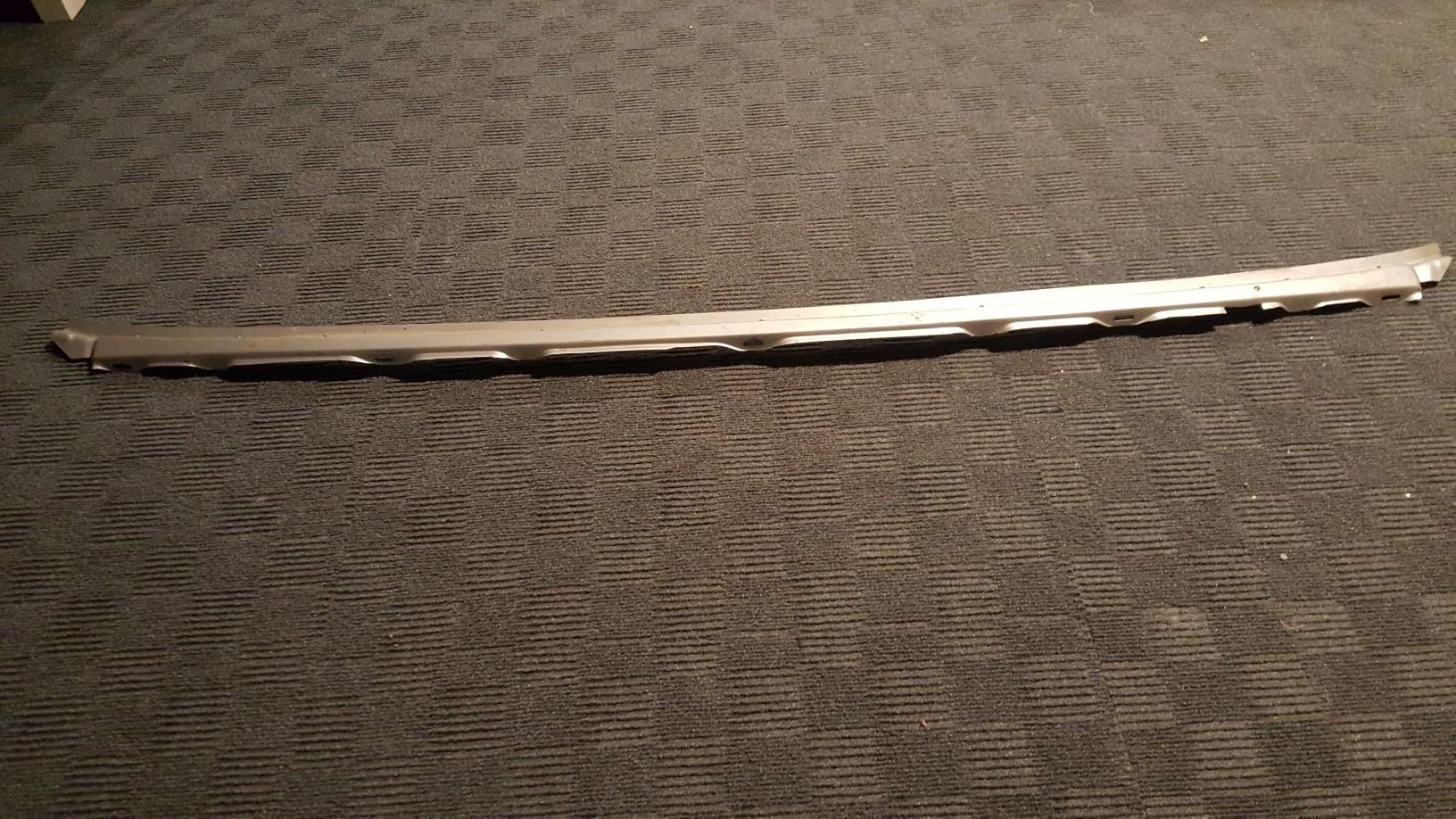

I believe that lower channel is reproduced, saw some on Ebay....
Old Sep 3, 2019 | 07:17 AM
Posts: 50,802
You can get the windshield channel repair panel. It's the same on Chevelles.
http://dynacorndepot.com/windshield-...chevelle-64-67

Maverick, I got this from Tamraz a few years ago for my 67. The fit to the wiper grill is perfect. You do have to tweak it at the A pillar covers a bit. What I did like about it and nobody else had one like it was that it had the rivets for the molding clips built into it.

Thanks for all of the great info, everyone. I got a new channel ordered off of eBay, today. Will see how it goes. Thx!
