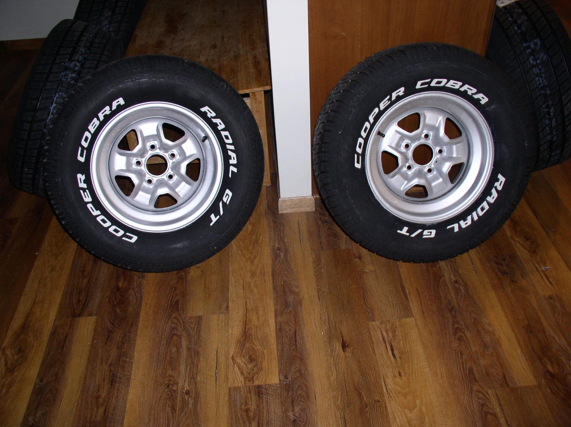

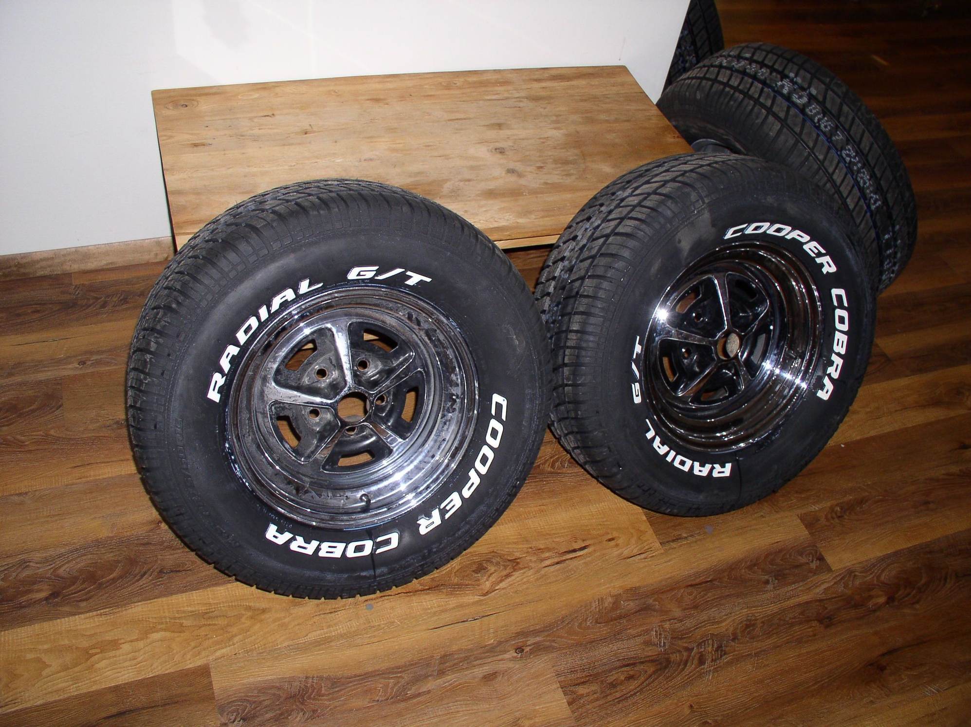

I was able to get 275/60R15 mounted on 15x7 steel wheels.. WILL SEE How they work on the front..... AND SS1 or SS2..??? decisions decisions
