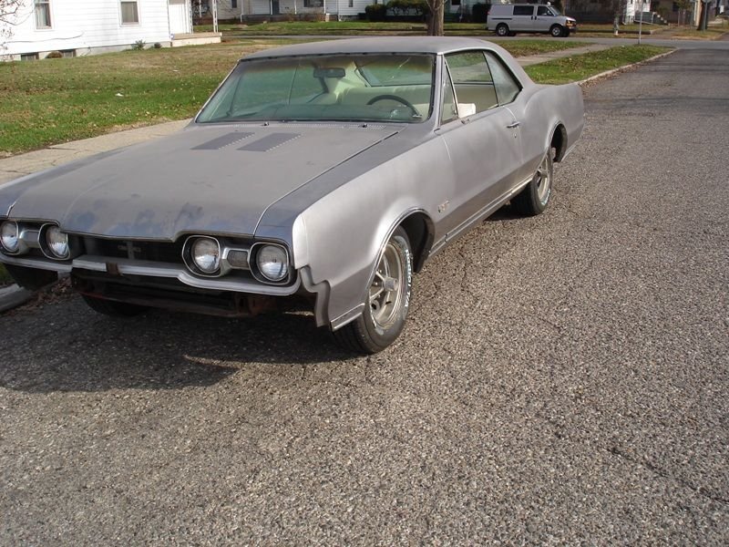

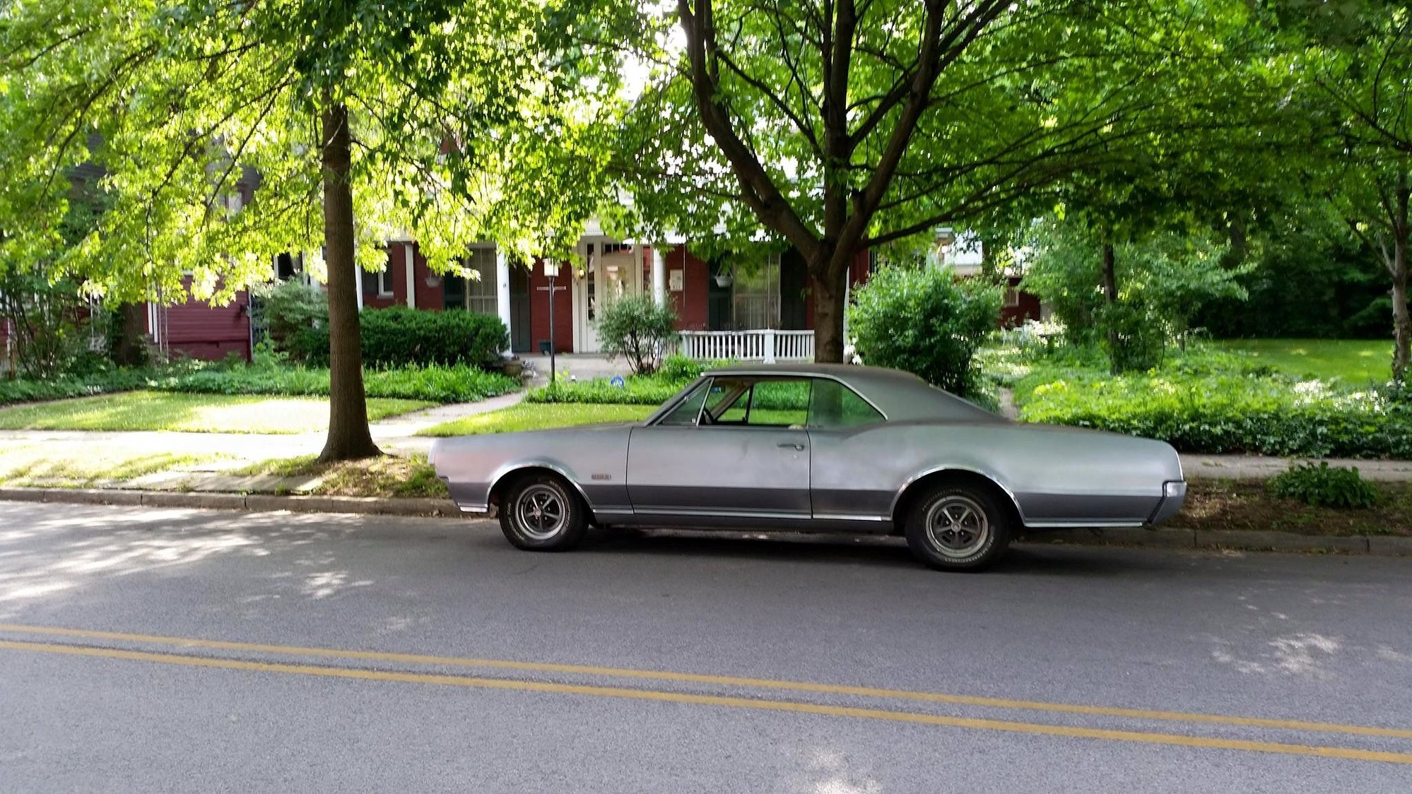

My project car has those tires and those rims.
