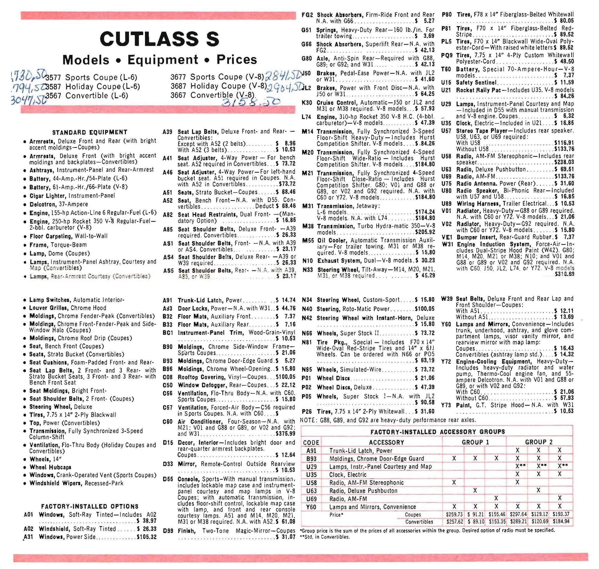

I have a 69 Cutlass S convertible. Which wheels came standard, the SSI or SSII?

Dog dishes were standard.
PO1 & PO2 wheel discs and N95 wire wheelcovers were optional, as were PO5 (SS I) and N66 (SS II).

Despite what you see on the interwebs today, SuperStock wheels were NOT particularly common on these cars when they were new. Back in 1974 when I got my first Olds, it took me a while to source a used set of SSII wheels. And while dog dish caps were standard (note "Wheel Hubcaps" in the standard equipment column on the left), nearly every car you saw on the road came with the P01 or P02 wheel disks.
