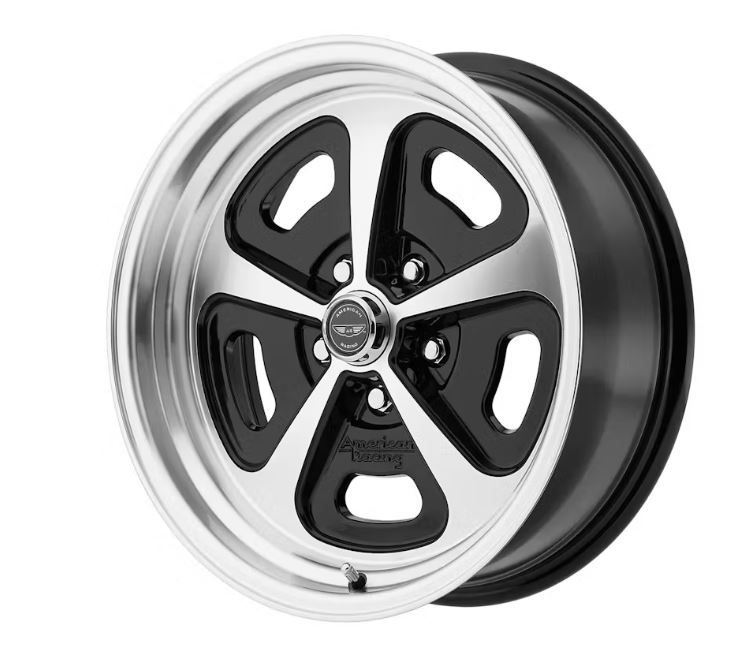

Ok I have narrowed down my choices to two wheels:
The parts place has a 15x7 black steel wheel with 4.75 BS or +19mm offset.
American Racing has their vintage looking wheel in a 17x9 5.47" BS or +12mm offset
I Like both of these wheels, but with the 15" steel wheel there are very few tire options.
Has anyone run either of these? I would like to run something like a 235 to a 255 tire.

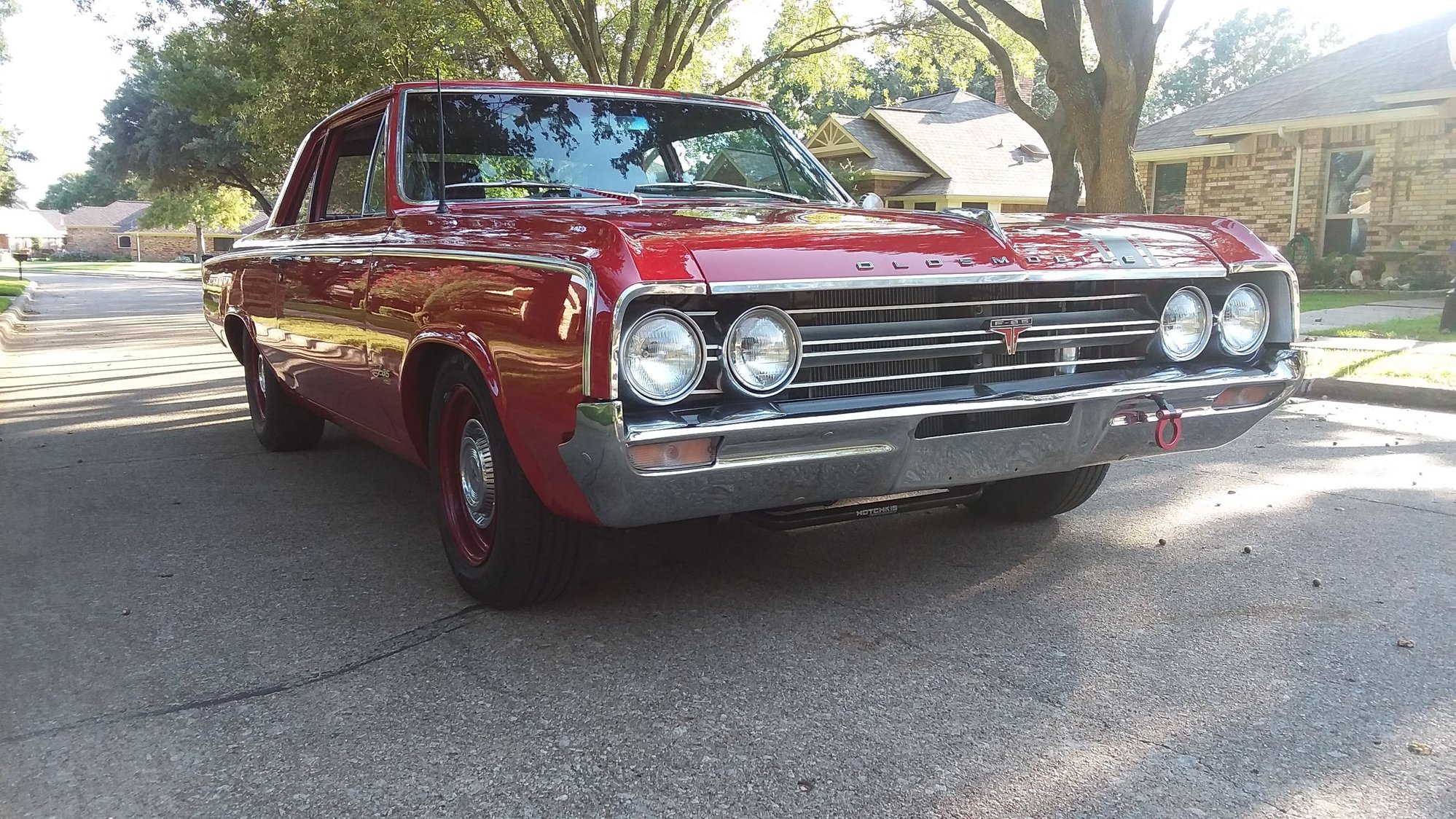

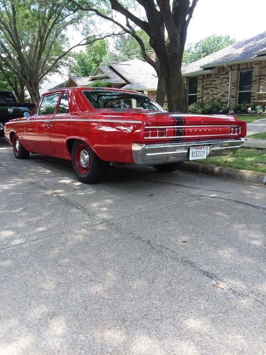

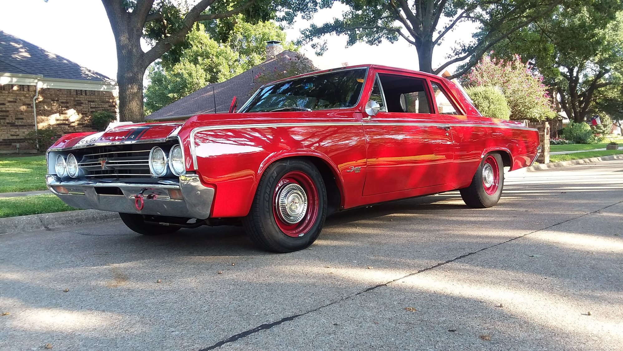

Here is the look with stock GM 15x7 inch big car steelies on my 64..

Old Feb 16, 2024 | 08:13 AM

It’s close but I prefer the look of the steel wheels. Especially when they are color matched like on your car. These come in powder coated black and that works for me with the dark green paint I like.
Right now I can find radial t/a s cooper cobras and a milestar tire in a size that would work. I’m agnostic as far as the raised white letters but I really wasn’t impressed with the t/a s on my 70.
