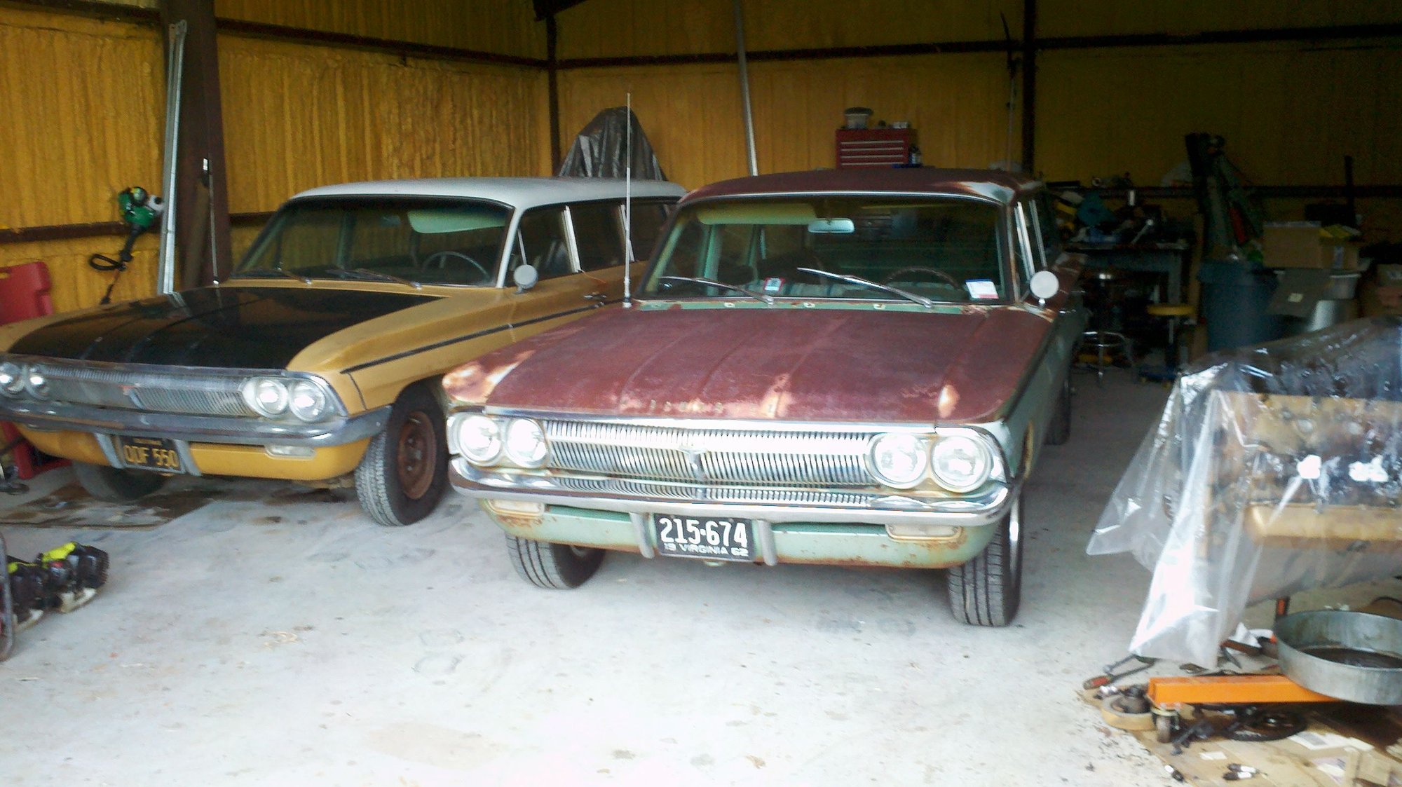

Welcome. The 4 x 4.5" bolt pattern was also used on 1960s-vintage six cylinder Mustangs, Comets, and Falcons. Also on the early Datsun Z-cars, the early RX-7, and a host of other RWD cars. I got these vintage slot mags from an early Mustang. They're 14x5.5" wheels. I just scored a second set at Spring Carlisle earlier this year.
Old Jul 28, 2022 | 06:36 PM
Posts: 25,789
Is that the NV desert car or the San Jose car?
Old Jul 29, 2022 | 04:58 AM
Posts: 50,768
That's the NV car. The yellow one is the SJ car.
Thanks, Joe. Nice picture...
