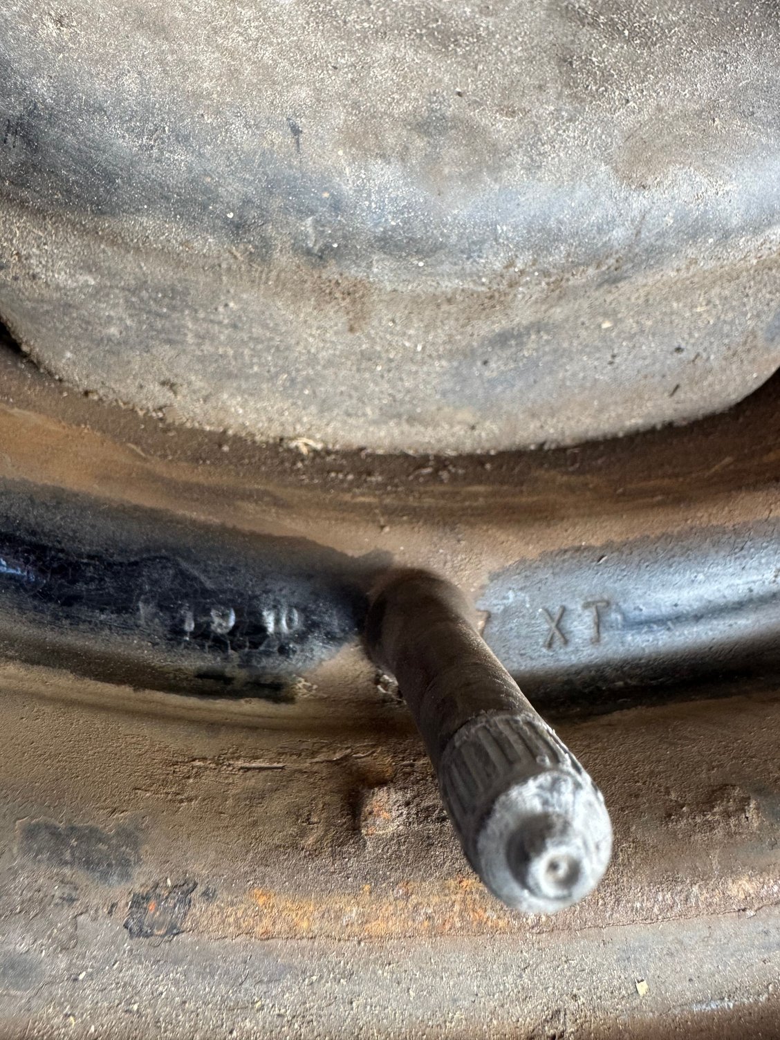

Was wondering, how could I check if I have the correct steel wheels for this car i am buying.
Supposed to be original steel wheels.
I did some quick research is XT for 1970 steel wheels and is it found by the valve thanks!

Should be a page in either the PIM or CSM...been awhile so I don't recall which book. Most are XT coded but you may have IF or a third (starts with a U, IIRC). The dates should also help. To the untrained eye, they'll look the same.

You could have XT's Or IF's(at the valve stem location). These also have dates stamped into them at the valve stem local to further determine if they are original

OK, they are XT 14 by sevens. What is
1-9-10 for the date???
[img alt="So they are XT the date says 1-9-10. ?
"]https://cimg0.ibsrv.net/gimg/classicoldsmobile.com-vbulletin/2000x1504/img_2012_628b6f6222b60eda833bc866241034bd0d49626e. jpeg[/img]
car was purchased 10/2/70

K is Kelsey
1 is Plant 1 Romulus, MI

9 = 1969, 10 = Month, On the other side of the stem is day looks like a 4???, Then of course the wheel code XT
looks to me like an upside down 4 next to the XT
here is the other code 14 x 7 JJ
