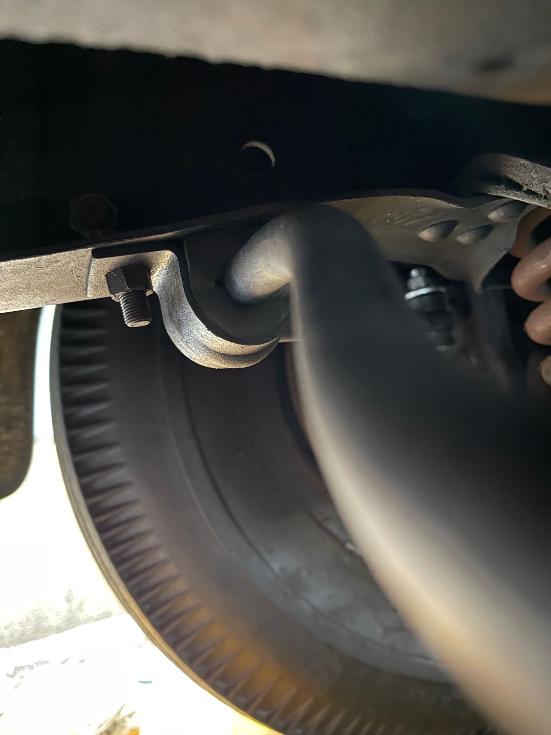

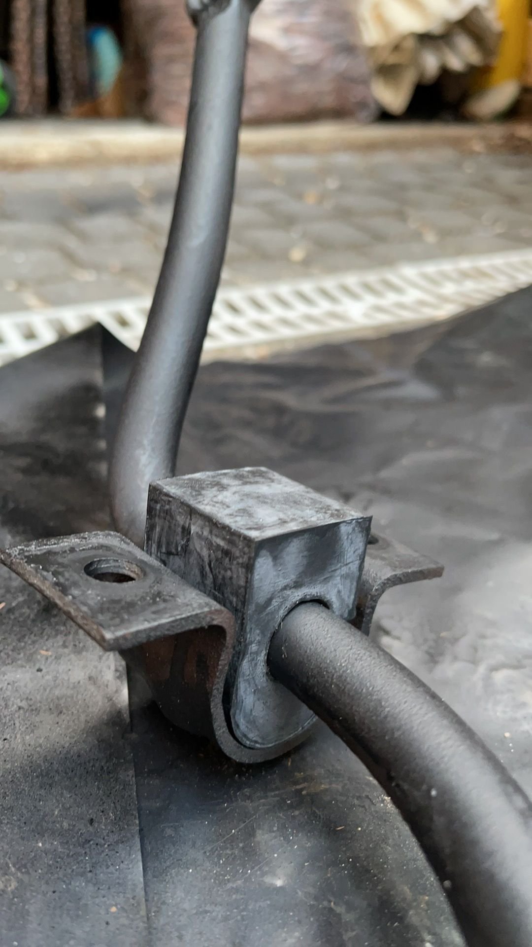

New body bushing tightened down nicely

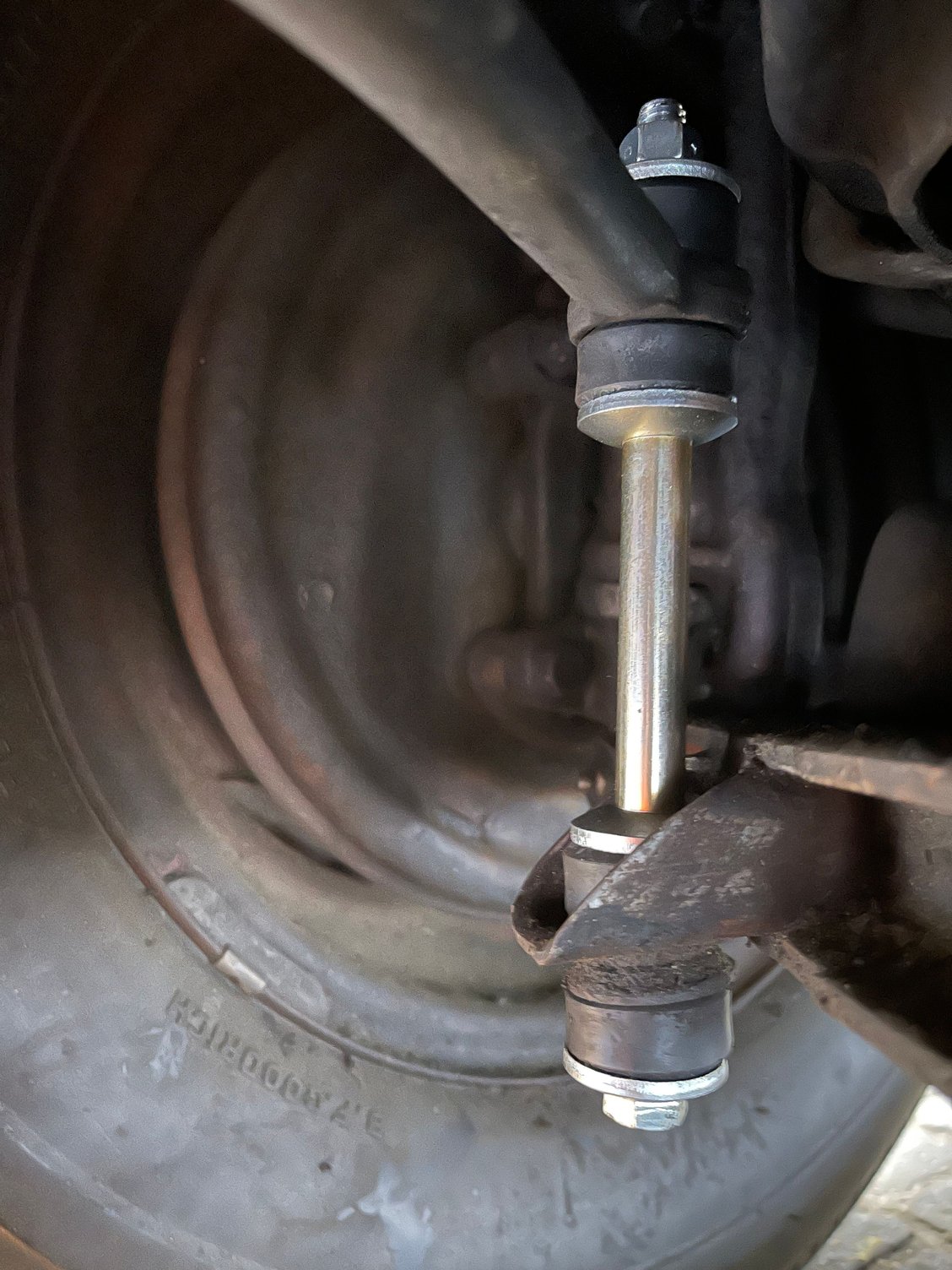

New set up tighten just to point when rubber starts to squish not to much. Keep thread above nuts same or similar to original.
New set up rigged down
