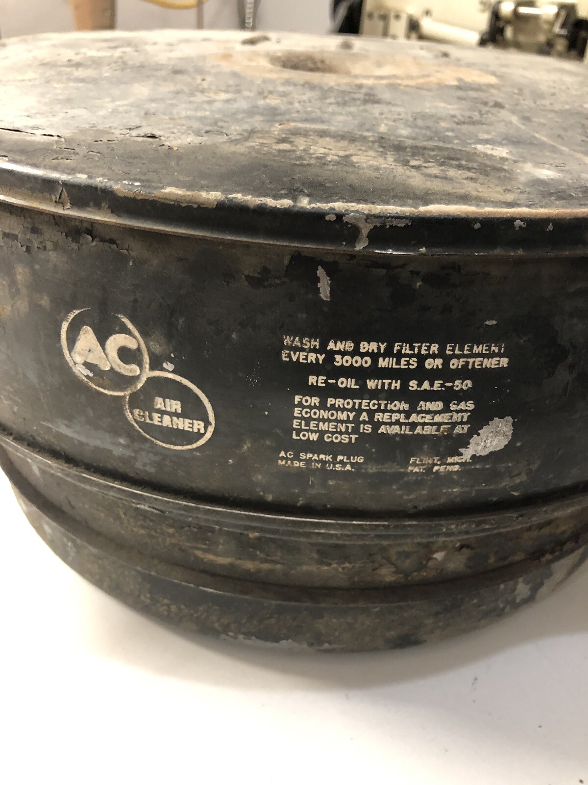

Are you trying to use a real batwing that was intended for a 4gc and adapt it to the 2gc? or are we talking about the regular oil bath filter found on 2bbl carbs. I thought you misspoke and called the 2bbl cleaner a batwing. Though they are both black the 2bbl version doesn't look anything like a batwing.... I have a picture of the decals of a batwing that isn't correct but that won't help you much....Tedd
Yes, I now have an original batwing air filter assembly for my 324 Rocket--which is of course meant for the 4-barrel, to use on my 2-barrel. I want the ability to run a paper air filter. The 2-barrel air cleaner is not really retrofittable to the paper element. The center screen is in 1 piece. I'd have to cut it up to remove the screen.
I'm going to set it up so it looks original, so I need to know where to put the sticker on the batwing.
Here is a picture of the original 2-barrel air filter. the entire center is one piece with the screen in the oil bath.
en integral.

I believe the sticker on the batwing goes on the front of the air cleaner. They come in two colors which are white and orange. I have never seen a batwing on a two barrel but it should not be too hard with a little fabrication.

See if this works

Outstanding, that does very nicely. Thanks very much.
