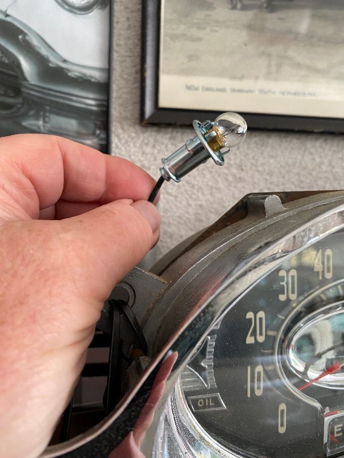

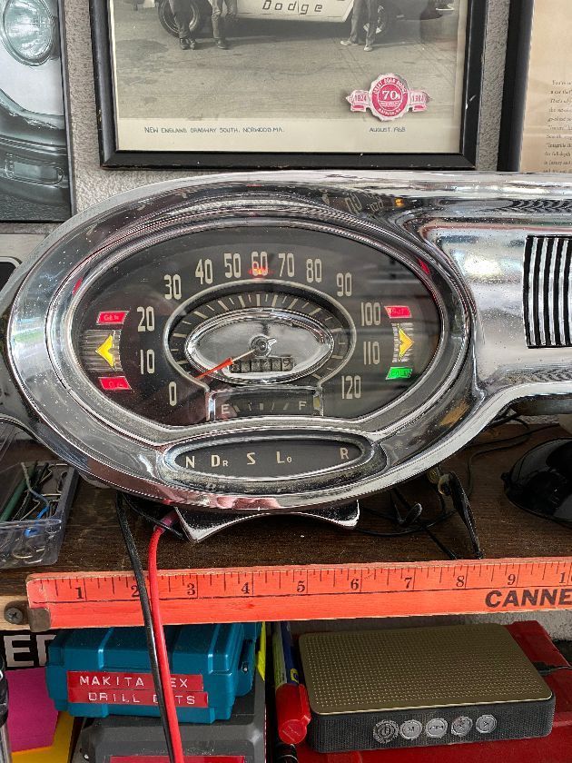

I don't know if this helps you or not, but in one my "retirement boredom" moments, I put together a bunch of spare parts and made a decoration for my garage. See attached. I can't remember where I got the sockets but I'll look later if need be. I know they didn't cost much. #57 bulbs and a 12 volt converter. It all works on 12 volts.

Forgot to mention, the sockets are single wire and the socket is grounded to the dash as Tedd said.

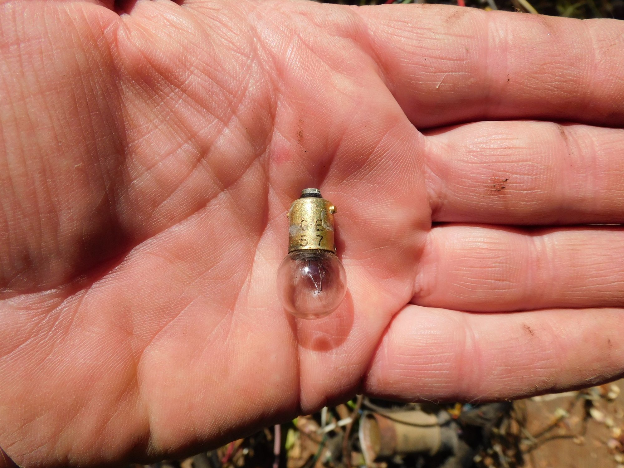

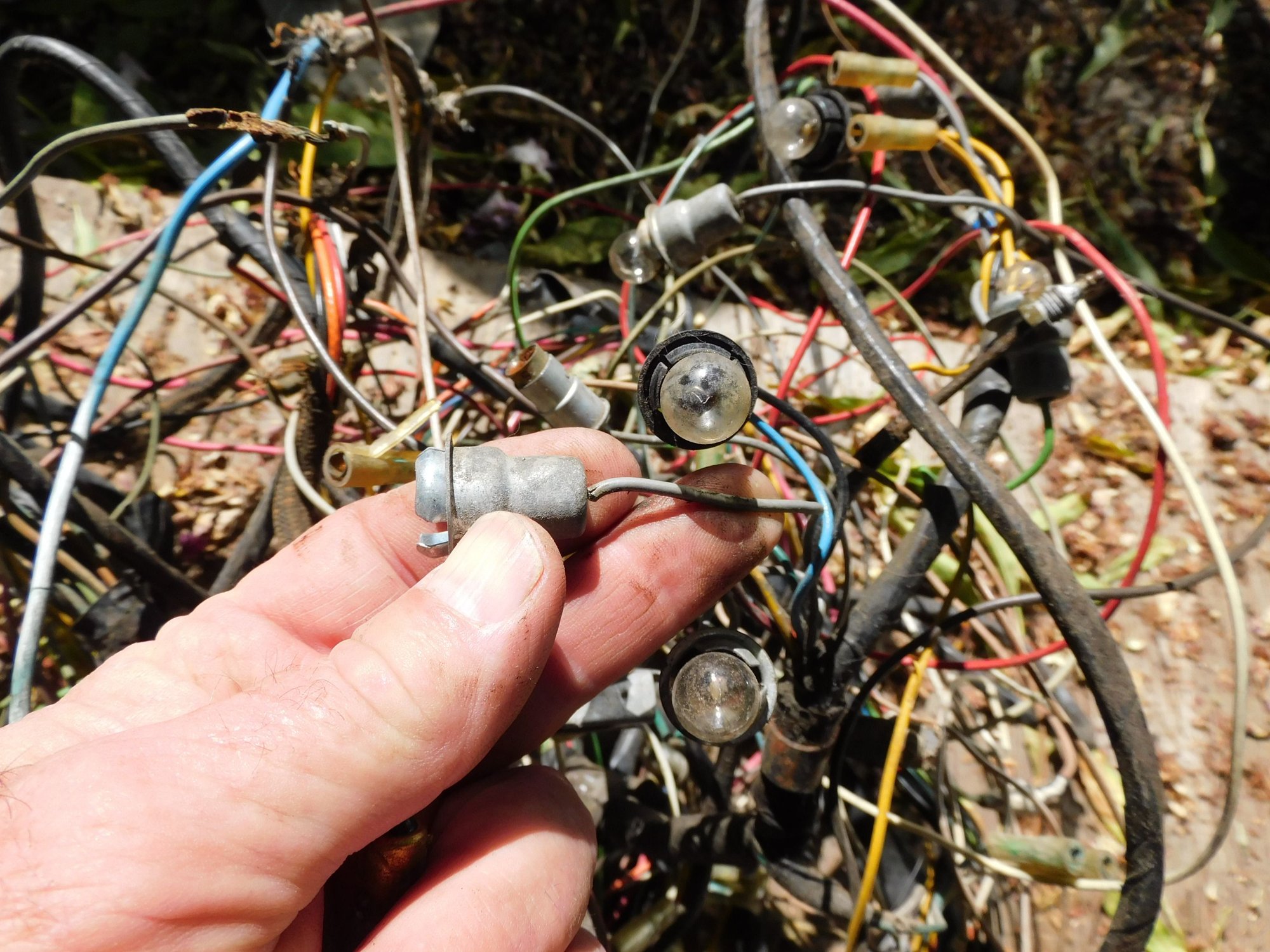

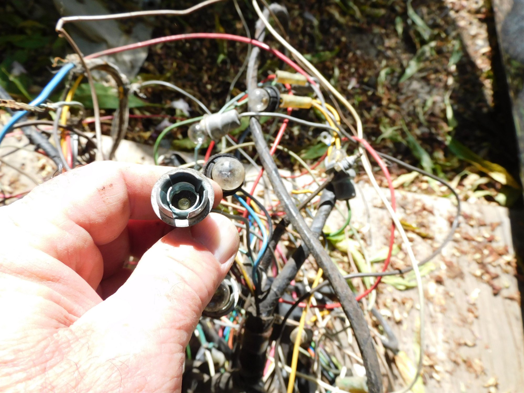

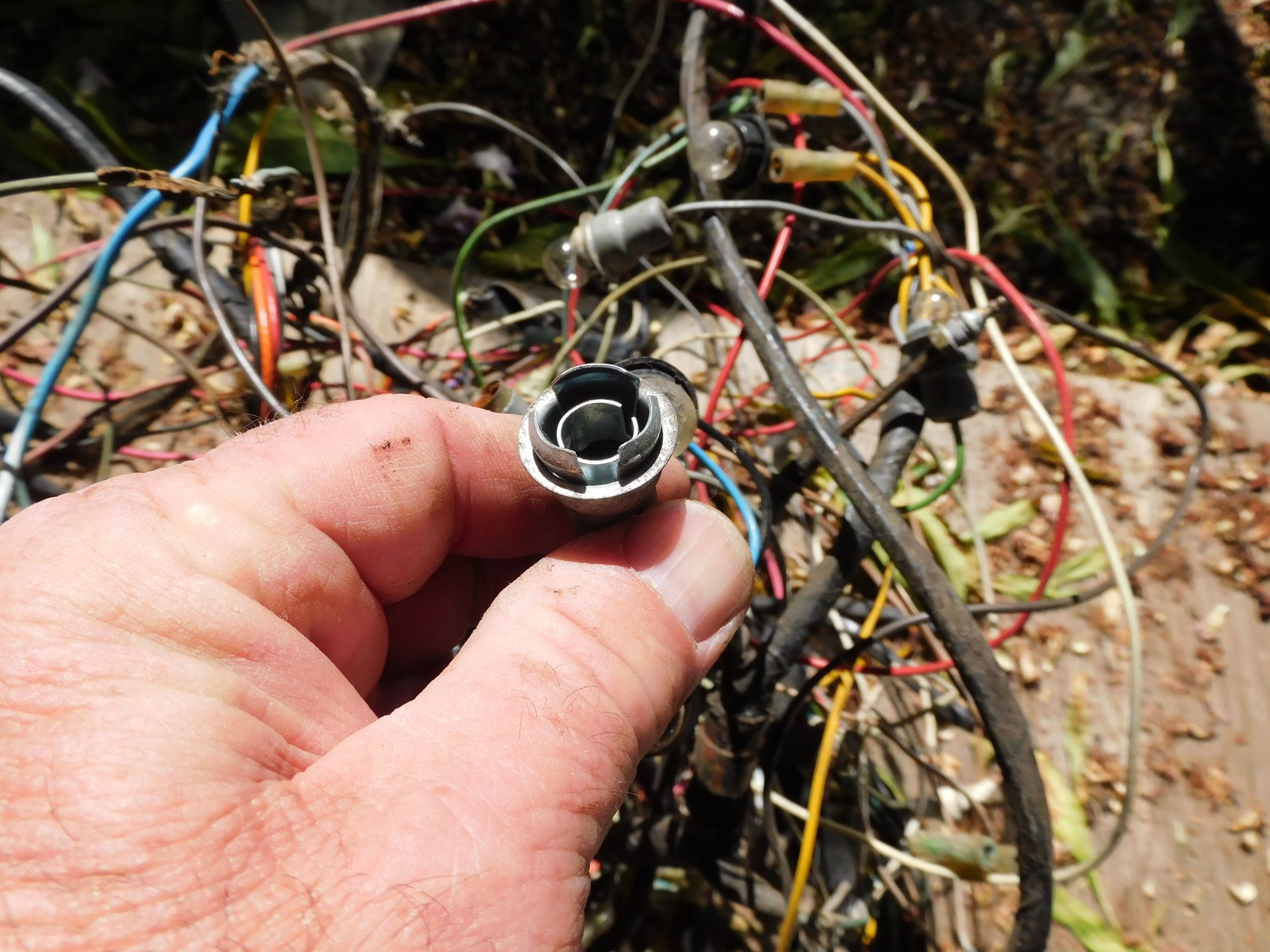

OK, here's the harness I pulled from under the dash on a 1955 4 door with AC, power windows and power seat. I believe these are the lights in question. There are six metal sockets with one wire going to them and two with plastic sockets and two wires going to them. Yes the bulb is a GE 57 as the others said. Let me know if I can post any other pictures that might help. John
