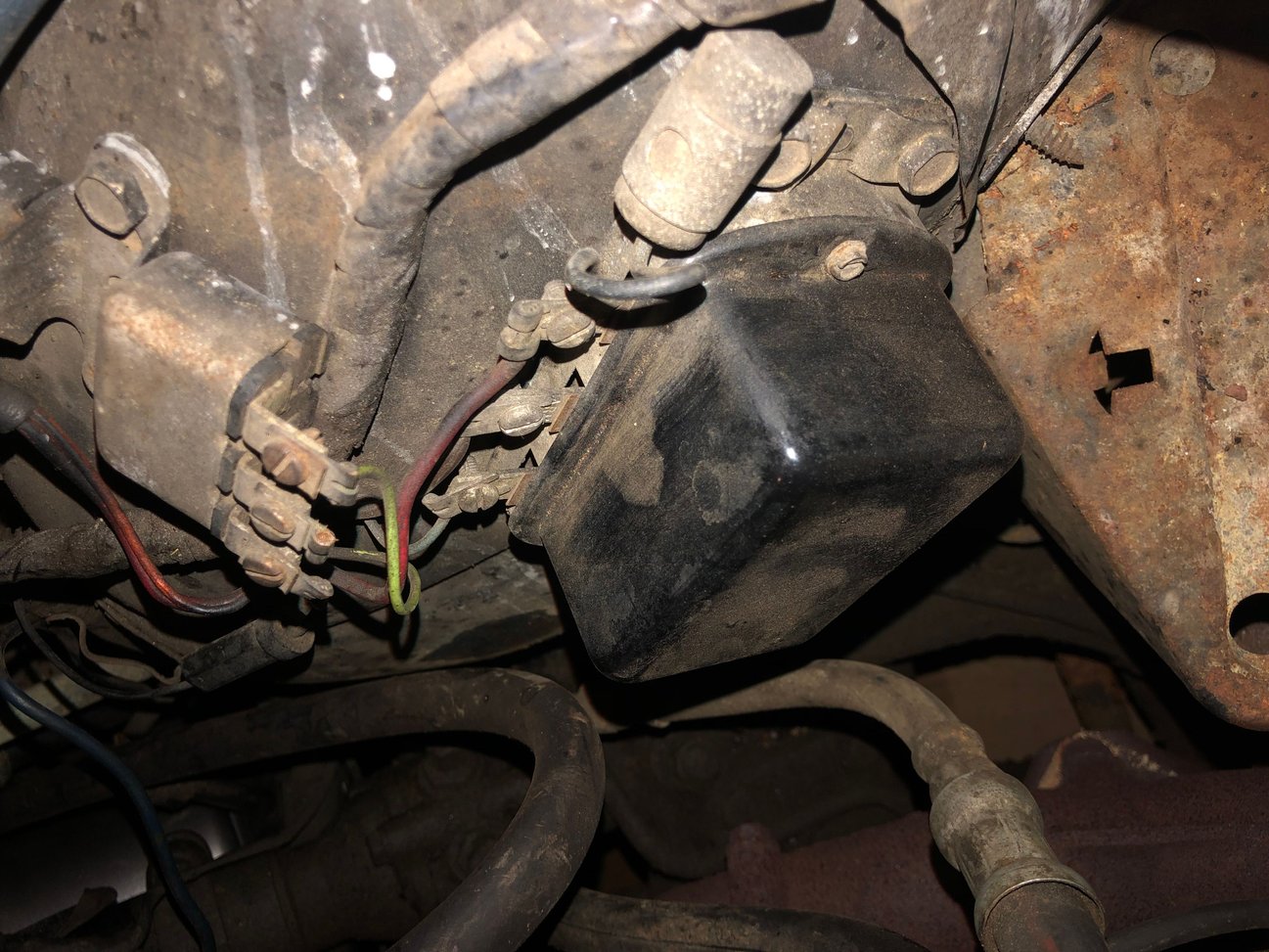

Old Jul 25, 2019 | 11:56 PM
  #45
johnlivo's Avatar
Joined: Jul 2019
Posts: 56
From: Portland, Oregon USA
Is the black box across the way from the horn relay in this picture the voltage regulator? Is that where the power comes from?? If so, can you guys tell me which terminal to use on the voltage regulator to bring power back to that middle terminal on the horn relay???
Appreciate any insights or info you guys can offer
John in Portland, OR

Hi guys, here is an update on my horn restoration for my 1955 Olds Super 88 4 Door Hardtop.
Today I spent almost the whole day working on the horn as well as working on quite a few other areas.
Since the horns themselves are working great, I first tried to replace the horn relay. But that by itself didn't fix it. So, next a friend and I removed the horn button cap, and checked out the rubber donut and all the other working parts. I thought there would be a lot of old dry rubber needing to be replaced, and other obvious issues, but actually it is all in quite good shape.
Getting under the dash and looking around for the switch wire from the horn relay that goes to the steering column didn't turn up too much either. But I did find that the old fuse panel had been swapped out for a new one, and all those wire connections had been cut and wired in to the new fuse panel.
So, I wonder if they lost the horn wire in the process, or miss wired it. Sadly, after all that work, I still don't know where the problem lies.
Seems at this point it might be easier though to run a new wire from the horn relay to the steering column, or something along those lines. Well, I would appreciate your thoughts.
