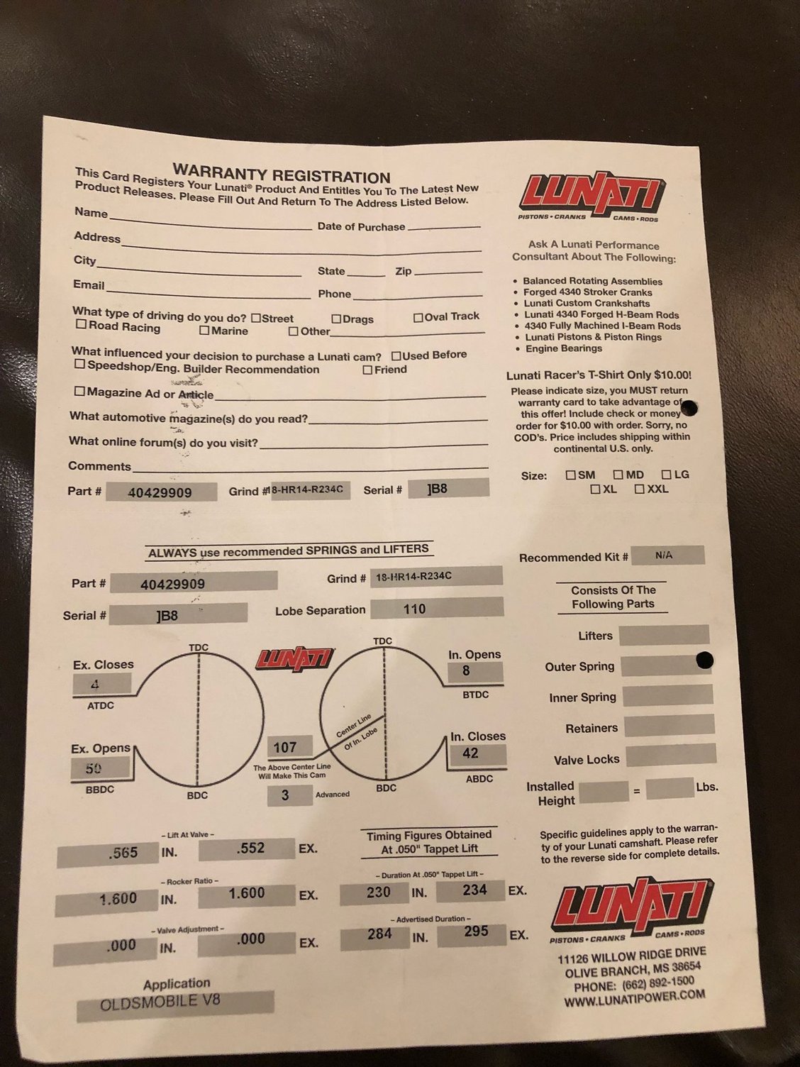

Hi to all,
I need help concerning torque converter stall speed I should order.
Which stall speed will suit best to my engine (455) and cam (please see blow) combo,
have stock diff 2.73 in back but will change sometime to 3.55 and build TH350 tranny.
Car will be driven road only but will doe some stopp light races, starts and burnouts.
I will be very happy/pleased to get some advices ;-)
By the way want to order converter from Freakshow

You will want something in the 2000 to 2500 stall range. You get what you pay for in converters.
