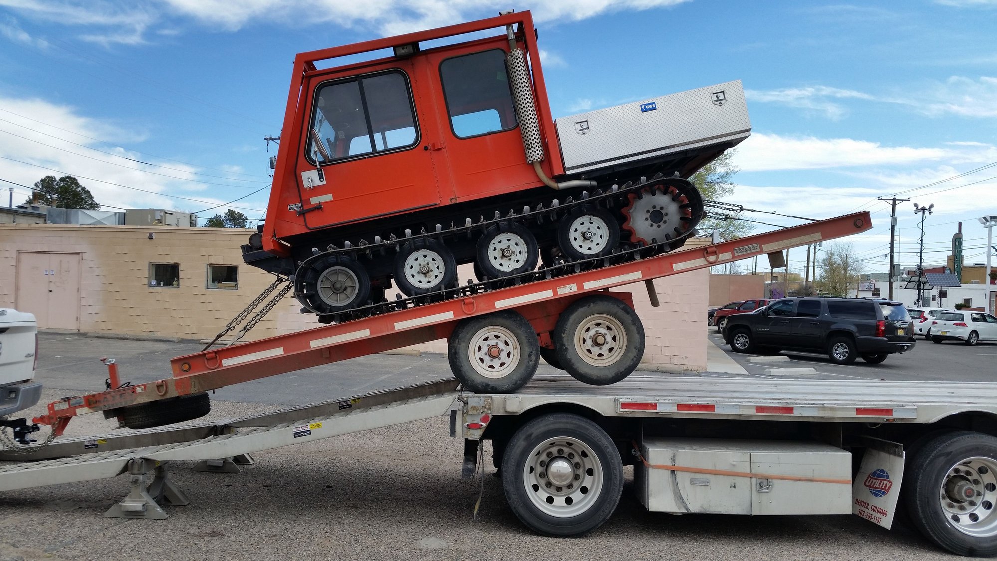

Not a Slum Jim, or even old school, but I could only get my work truck half way up the ramp backwards. The fluid in the trans shifts to the front of the sump/pan and uncovers the filter pickup. You lose fluid, you lose reverse.
