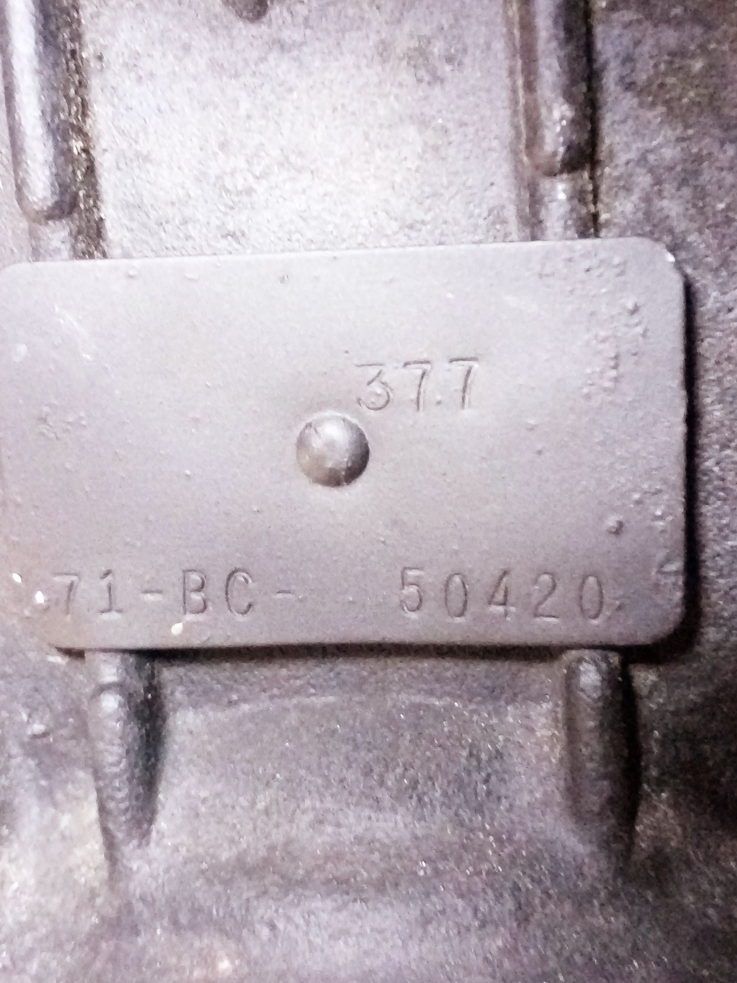

I picked up 2 th400 transmissions yesterday for $100.
Will post a few pictures of tags, could anyone let me know what they are out of and years. Also, what motor they came with.

I think both came out of a Buick Rivirera.
first one 1971
second one 1967

Any chance you bought these off the Vancouver Craigslist? I called on them when he had them advertised as a 1970 442 T400. When he sent me the tag info I told the seller that they were from a 1971 Riviera and a 1967 Riviera. I would be cautious believing that the 71 trans is rebuilt as the seller claimed. He also had no info on the converter for the 71 trans but claimed it was a 2500 stall. $100 is a good price for two cores.

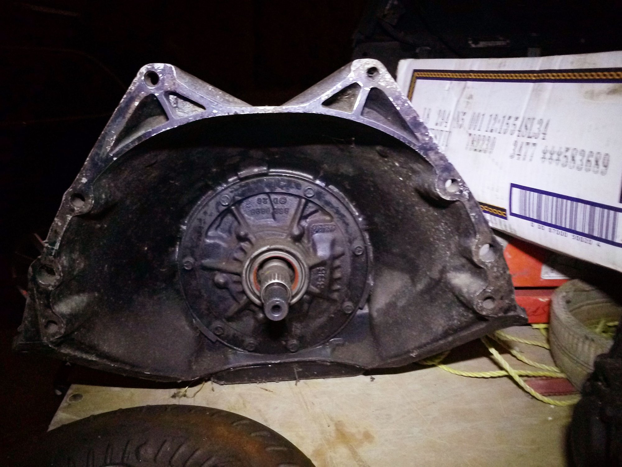

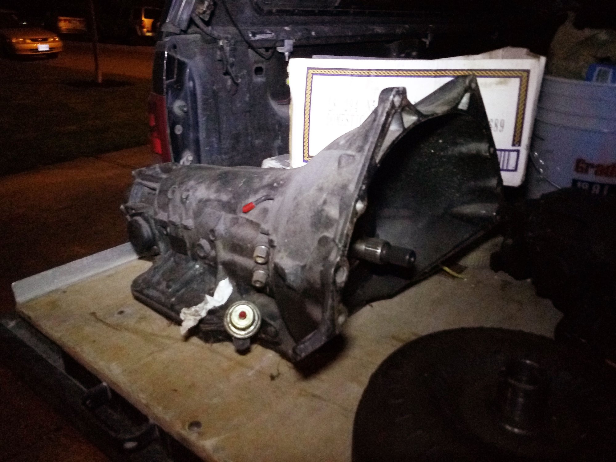

I attached the pics of 71 400, have to rob the small shaft housing from the 67, guess the guy I bought off got it from someone that was going to out a transfer case behind it. thats what he said. going to remove pan and check it out, looks like all new seal wher installed. the stalk looks clean also. who knows what happended over the years. where do I find out what the codes mean on the tags, in case I come across more 400 for sale. thanks.

Those other numbers on the right of the tag are called calibration codes. Refers to internal settings and other things. For example, your trans from Riv's were calibrated differently than say a 400 in a BuickGS.
If you can find this book, you might find it helpful. It has trans codes but not a lot of detail on calibrations specifics. Find a good trans shop and work out your expectations with him, so he can build it right,regardless of core type. #ISBN 0-87938-267-8

One important detail is that a '67 Buick TH400 might well be a Switch Pitch, and that changes a few things.
Shall we find out?
How many electrical terminals?
pics of the fat part of the input shaftage?
