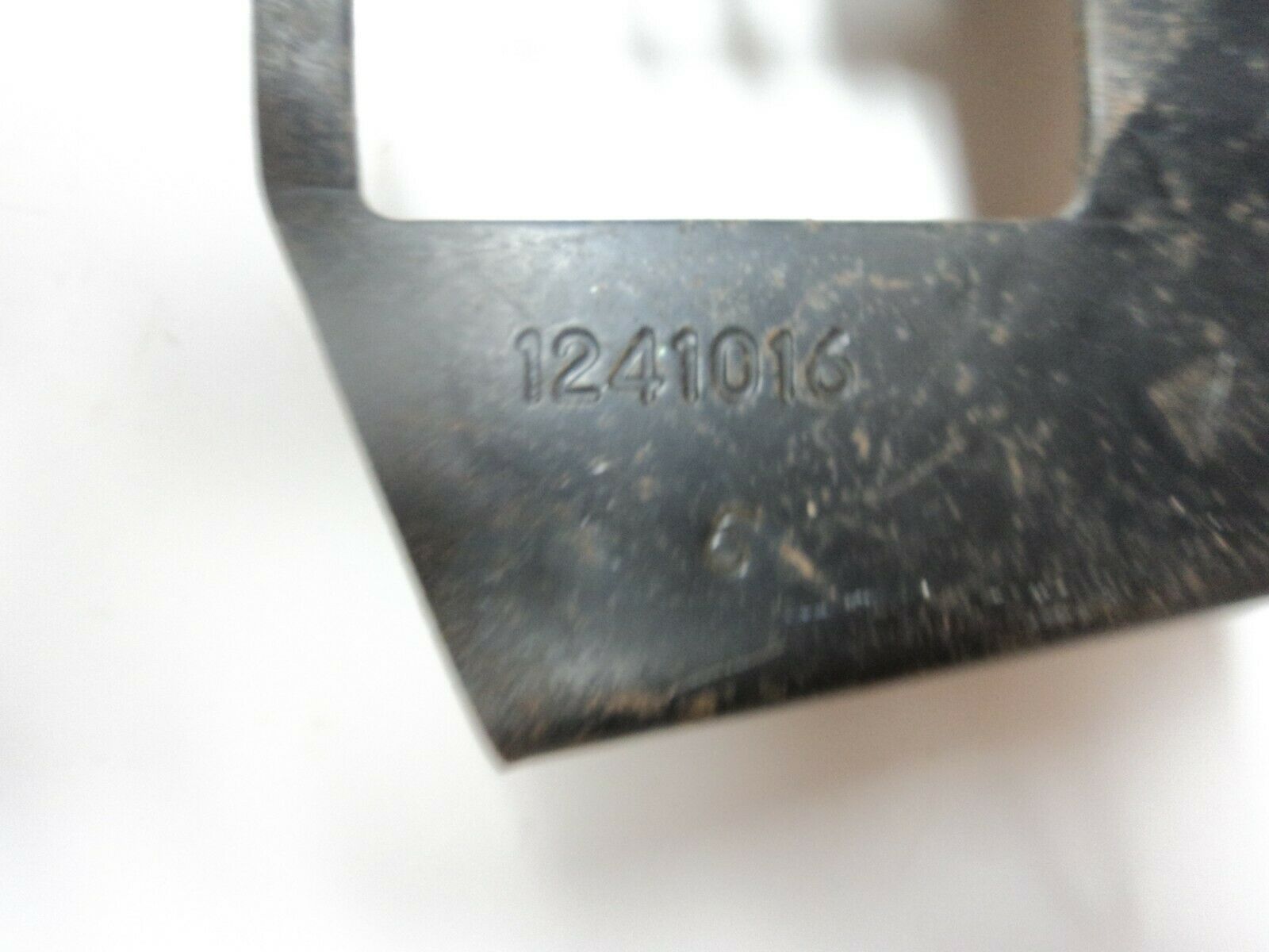

The correct switch is P/N 1242101, which is the same for 1969-1975.
The bracket (called a "reinforcement" in the parts book) is P/N 1241016, used on 73-76 A-body cars, among others. It was also used on the 1980s B-body cars, so a used one should be easy to find. It is not the same as the repros sold for the 68-72 cars.
