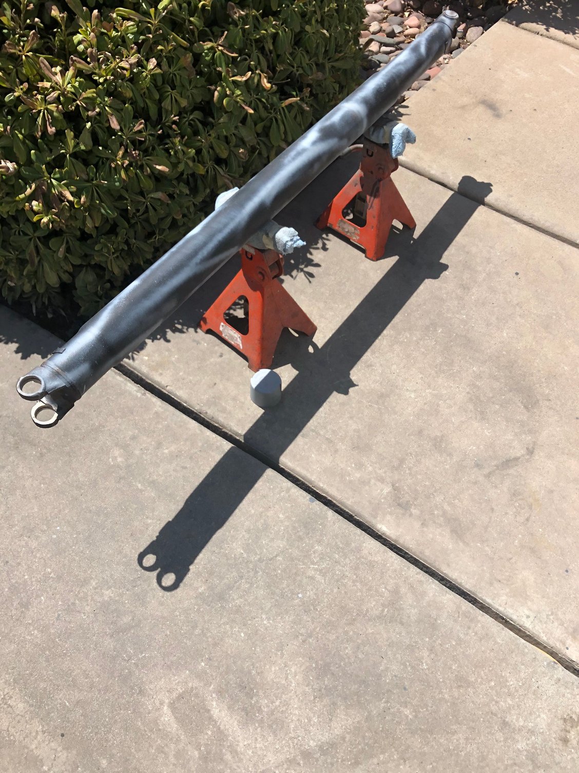

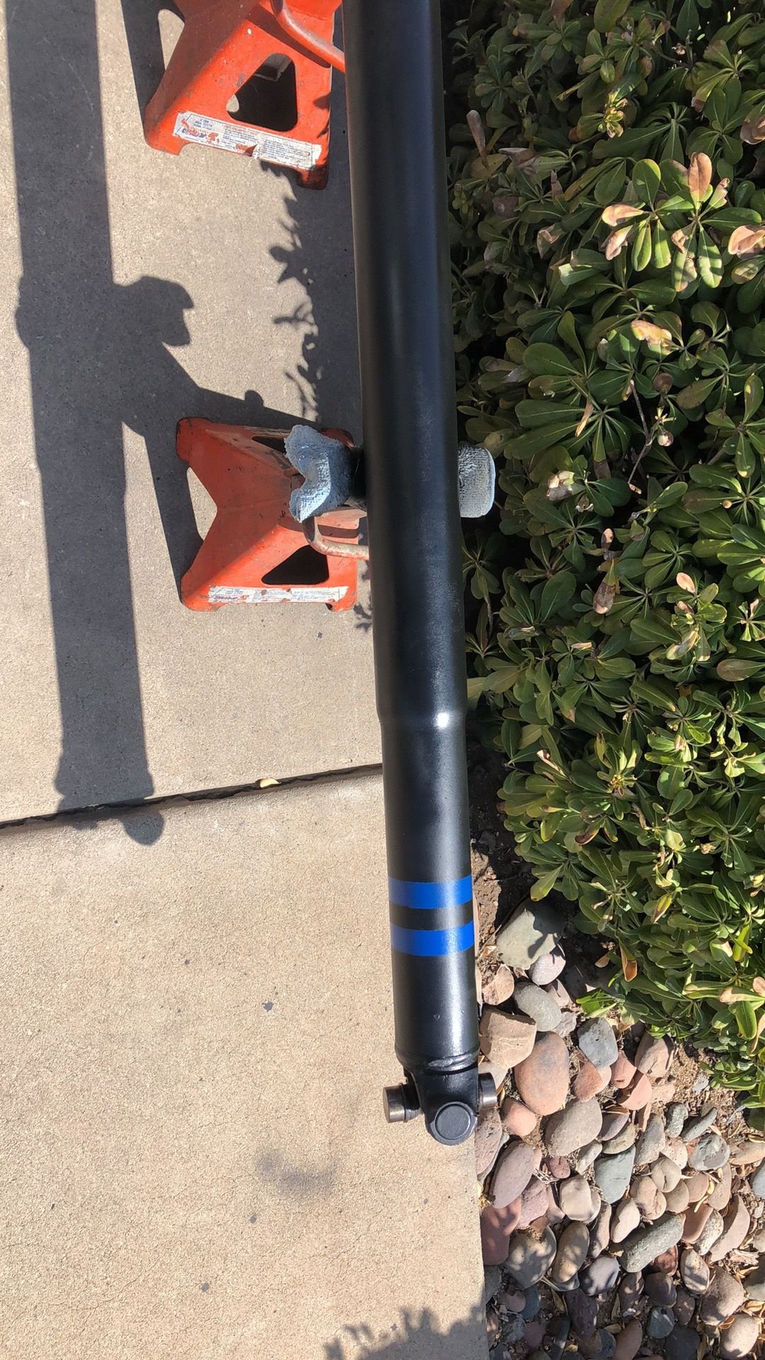

not mine, no grease fitting I J B welded the weep hole. Was leaking trans fluid out on incline.
Cleaned up u bolts
Painted some balancing stripes, yup made my Own colors
Primed a few spots
New universal
