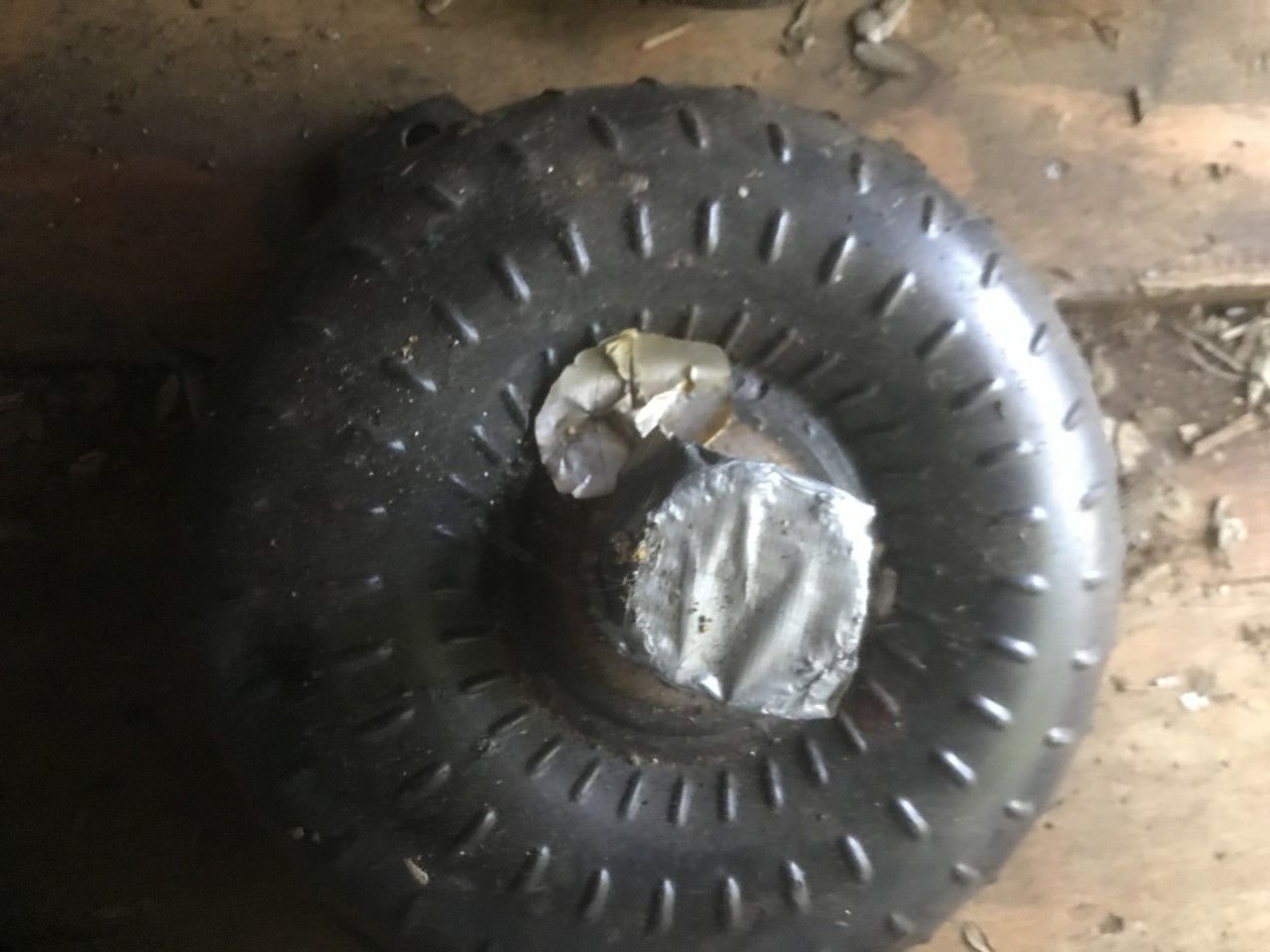

I purchased a 350 turbo performance converter 2500 to 2800 stall years ago and never used it.. its available for 100.00 plus shipping if you're interested.

What make is your torque converter?
not sure but it looks like a 9 inch B& M or TSI was told it is a 3000
stall and has the bolt holes for th350 or th400

Thanks! I’m trying to find out more information on 8742J no luck so far. Jim
