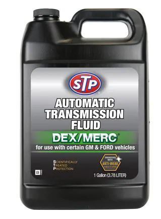

There isn't much to choose from, is there? All they have today for old GM cars is Dex/Merc, and it's sold by several different companies. Go to any auto parts store, and that's all you see. It's designed for use by 2005 model year and older GM cars. It's what I have in my '67 and '78 Oldsmobiles. The latest fluid is Dexron VI, but that's specifically for 2006 and newer cars.

Dex/Merc is about your only option. The original spec was Type A suffix A which has gone the way of the dinosaur and dodo. The original AMT fluid blends contained whale oil which is why it stunk so bad when it burnt, but since the whale savers gained traction that is verboten. Though I've heard newer Honda fluid contains it... hmm, guess the Japanese whaling industry never went away.

The Dex/ Merc stuff works just fine in my 55, it's found everywhere.... Tedd
