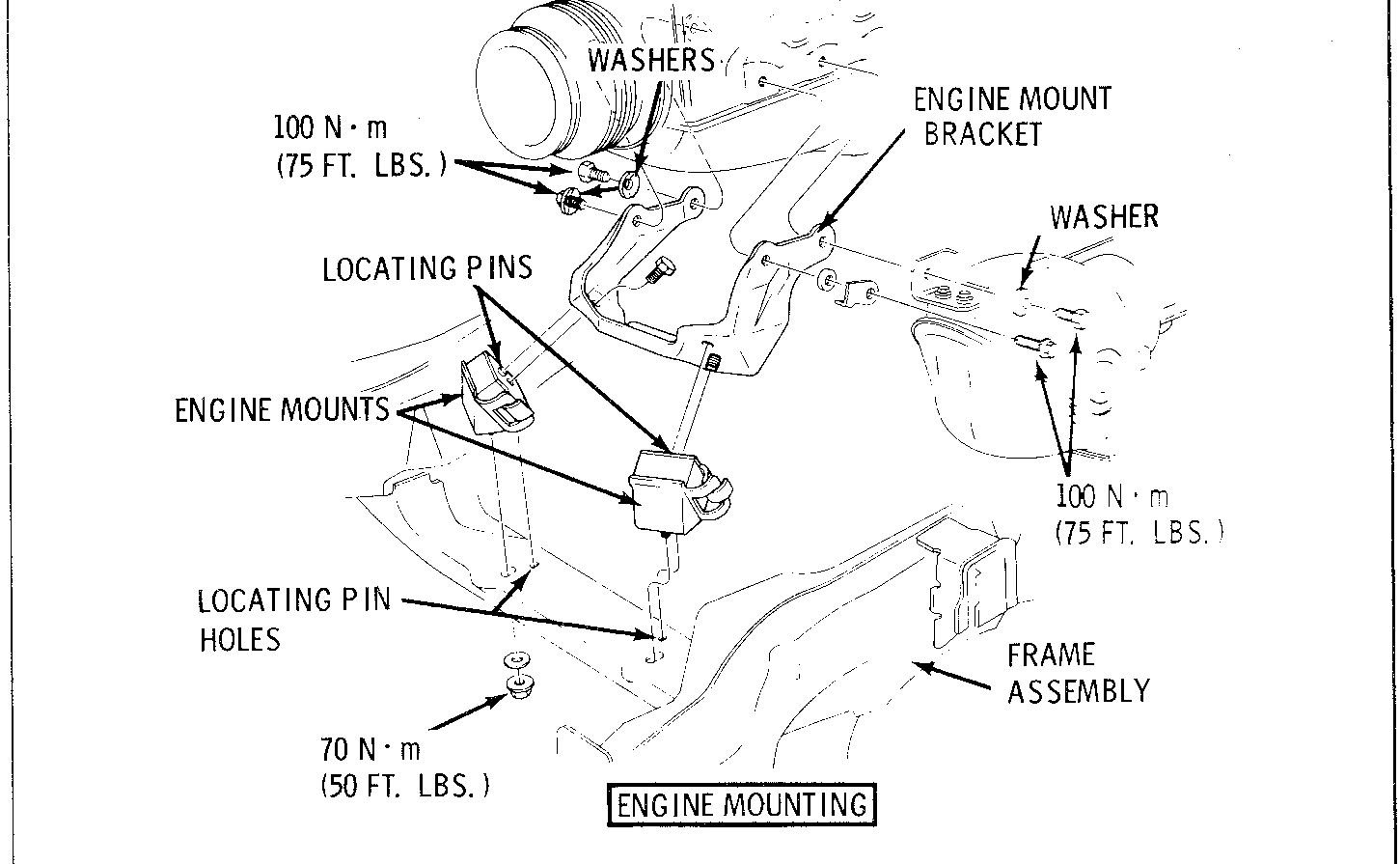

Hi Everybody, looking to swap a 350 Olds carbureted motor into a 1985 Eldorado that has the HT4100 is there something I need to do to the transmission.Some transmissions u can run without the lock up engaged some you can’t. I'm not sure about this one. Please advise? Thank You......

The Olds motor will bolt to the trans, but you will need the correct motor mounts and engine bracket for an Olds 307 in that car. You will also need the correct Olds FWD exhaust manifolds.
