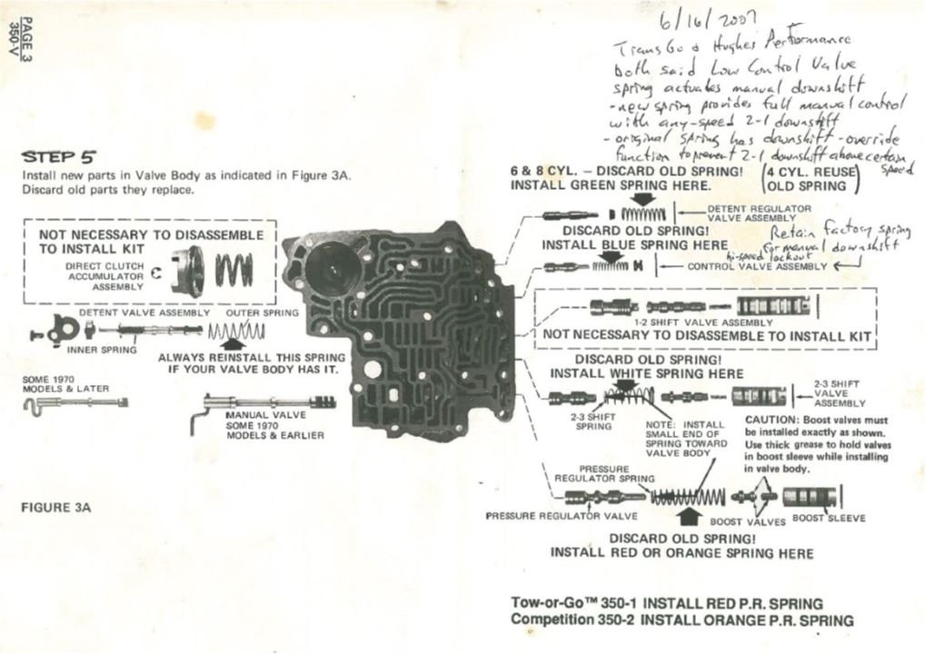

But, my TH350 is still shifting too late for this engine, WOT shifts are around 5000rpm. Kickdown cable clip is adjusted like the CSM says (pulled all the way at WOT).
my guess is, that the Trans detents to 1st at too high speed for a stock engine.
I have the Transgo 1-2 shift kit installed and did NOT installed the supplied "low control clip". Can this be the reason? I thought that this is only to prevent manual shifting to 1st at higher speeds.
Where does the transmission gets the signal from which says "too fast for detent to first"?
I have 3.23 gears in the rear.
I will try to play around with my governor to bring down the WOT shift points a bit when ill find some time.

The low gear spacer (sometimes its a solid spring) in the low control valve once installed will allow the trans to downshift at any speed, or stay in a manual gear until you either move the gearshift lever, or drive over the crankshaft. It’s basically an invisible modification unless you have the shifter in 1st or 2nd gear.
Im wondering if you don’t have a fuel delivery issue or some other concern. A healthy 350 should easily run to 5000 rpm and still make power.
Just a thought, have you verified that the carb will go to WOT while flooring the throttle from the drivers seat? Make sure the floor mat or linkage flex isn’t keeping the carb from going WOT
If the kickdown cable is adjusted to the incorrect WOT, maybe that’s keeping the trans from upshifting because it’s not actually WOT? Maybe the engine is wheezing because the throttle isn’t actually opening all the way, while as far as the valve body is concerned the throttle is.
if the engine is healthy, and everything else is good, I bet your going to need to play around with the governor. Don’t try to tune WOT shift points with the modulator.

Here's an image of the TransGo installation instructions with my notes after talking to TransGo and Hughes Performance about the Low Control Valve.

Fun71, the Transgo Instructions you have show a LOT more details than the Instructions they supply nowadays!
