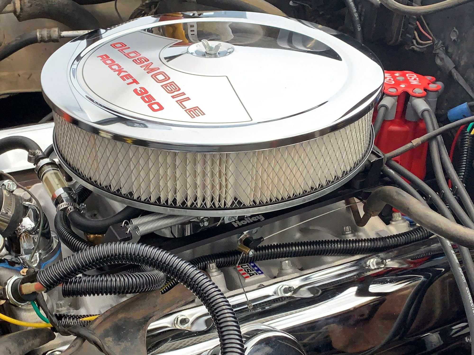

@Rgdickson Here is a photo of the Spectre bracket with the Performer and the TH350 lockdown cable. It worked fine. It flexed more than I wanted, and I wasn't happy with the return spring setup despite trying various setups on both sides of the throttle.
I ended up switching to a Holley bracket which worked much better. It uses two of the carb bolts, so it is rock solid secure, and it is very adjustable.

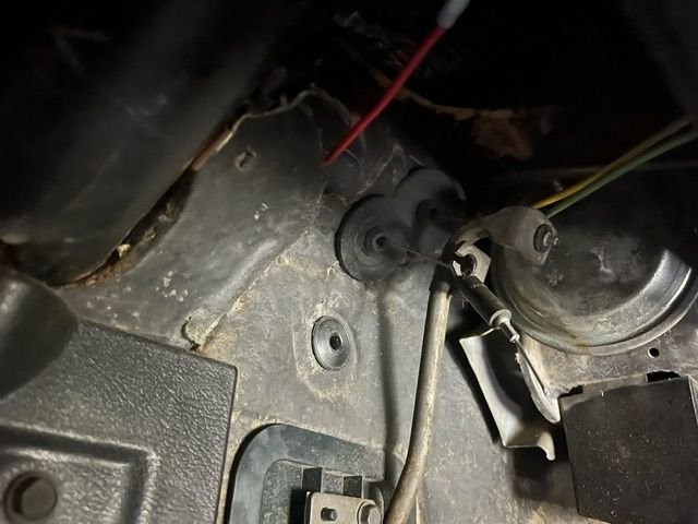

Found that it was already there at peddle but not hooked up, going to get a retainer grommet and try there first thanks
