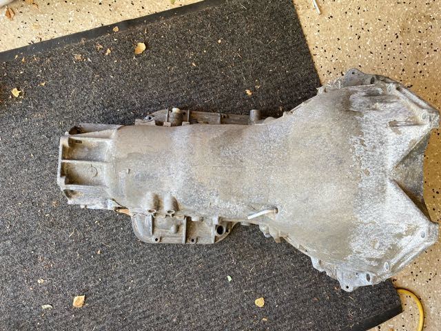

T400 case has been out in the rain for years
Any thoughts on how I can clean this thing up? Or is it too far gone to use as a core for my 1968 442 street rebuild.
The case sat outside yet the guts were safely stored inside.
Any input or ideas appreciated.

I had one that was worse than that. My soda blaster worked wonders on it. Just be sure all the internal passages are clear. I did replace all the bushings.
