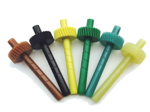

Yes, the cable is seized. And your trans is a 200-4R. There are more than just two sizes of driven gear:
These gears come in 26, 27, 28, 29, 30, and 31 tooth versions. There are also two drive gear version, 10 and 12 tooth. Your best bet is to pull the old gear out of the trans and count the teeth. The driven gear comes out with the adapter (frequently called the "bullet") from the side of the case. Unfortunately, the adapter is steel and the case is aluminum and they corrode together. I just had to beat the hell of of one of mine to get it out during a rebuild. Replacements are available.

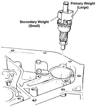

The drive gear is the bigger problem. This is part of the governor assembly, and the only way to access it is to drop the trans pan and remove the governor cover.
Here's the complete set of six driven gears and two drive gears.
