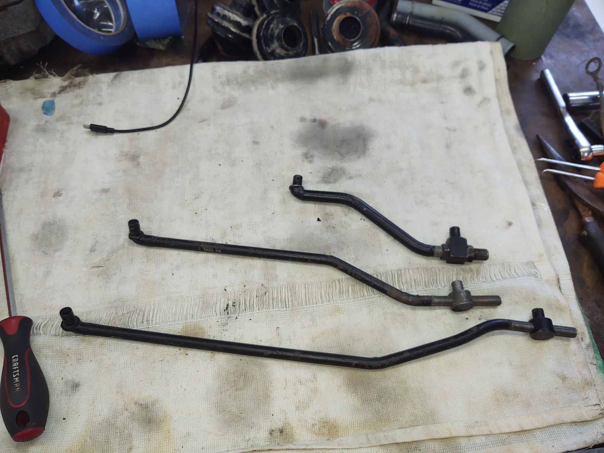

Hello all,
Can any please tell me what vehicle shifter the rods in the picture are for

reverse looks like a 70-72 large rod w correct trunnion and maybe 70 up t-10 it looks too long for some reason for 70-2 a body muncie
1-2 3-4 look like aftermarket rods w weird bends , too many threads, wrong trunnions for factory
just my .02
