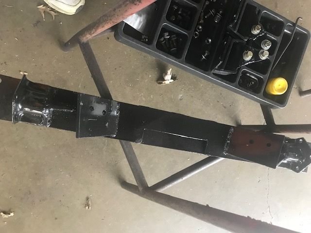

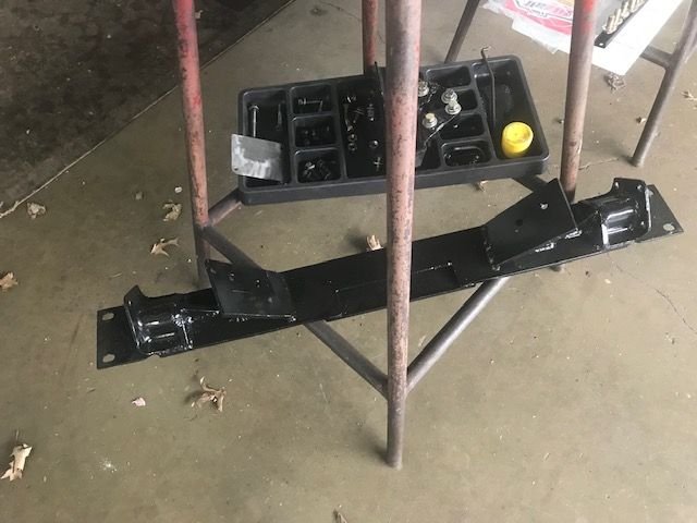

it was not as easy as KQQCAT said it was because theres a big difference between a 61 and 62 olds . I just could not find anyone to fix or tell me why the slim jim after being rebuilt twice would slip in high gear , the car is no good to me if I can't drive it so i did the swap , was lucky to have a great mechanic that figured it out and did the swap , I went with the chevy 350 thinking there would be more room around the trans to work with , the car runs great now , the swap was not cheap , still looking for pictures of cross member and trans mounts we made ,
