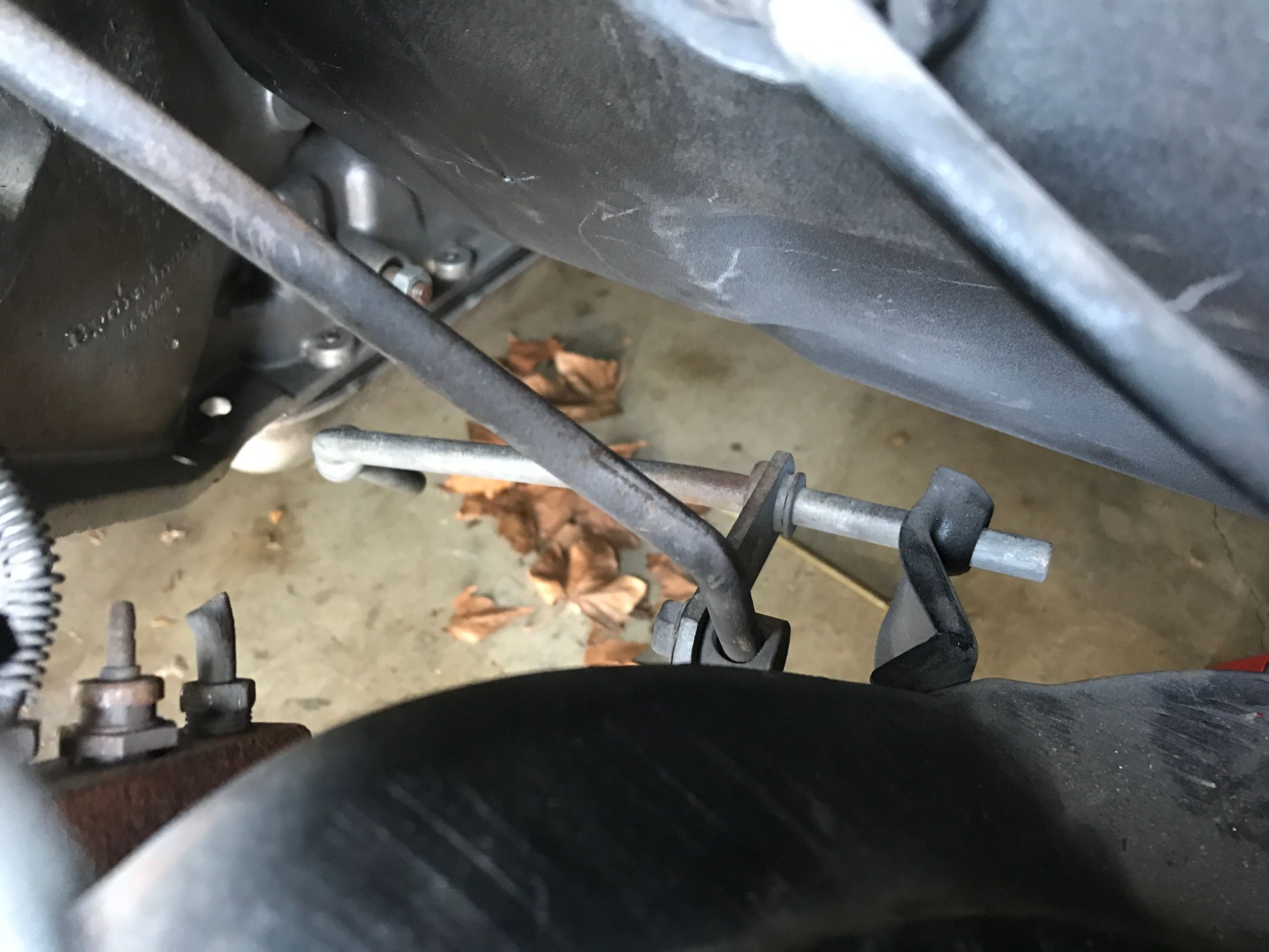

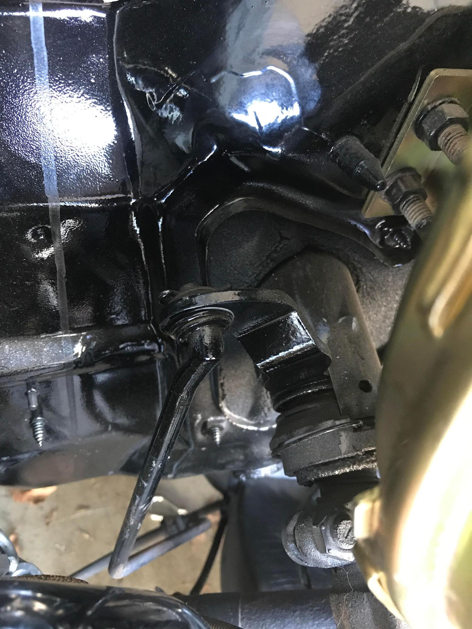

68 with a column shift. I got the trans from bowtie overdrives and they are shipping me the kugel shifter kit.
Below is what is currently connected to the shift lever:

Exactly. The TH350 linkage piece fits right on the 2004R. Unless it shows OD on the indicator and allows low gear.

I have most of the setup intact, but I have had a hard time finding the rest. I need the pieces that actually go to the trans. Also, I can't seem to find the diagram for connecting the factory linkage to the trans. I have all the documentation from wild about cars, but I can't seem to find it.

Page 7-25 of your 1968 Chassis Service Manual. Spend the $15 and buy a real one. That's probably a lot less than the cost of the aftermarket linkage.

Extremely easy. I will take a pic later, the rod just slides into the linkage and a cotter key holds it in place. There is really only one way it can go in.
