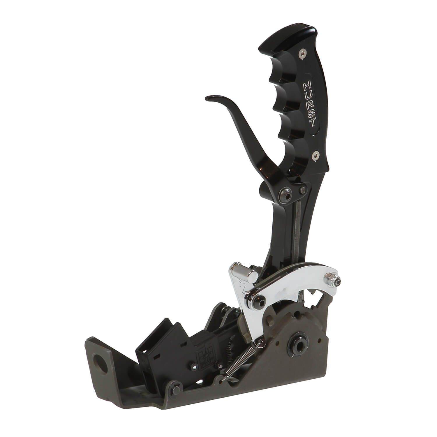

Will the Hurst #3162023 Pistol Grip Shifter for a 4 speed 2004R fit into a 1970 - 1972 Dual-Gate Center Console?

Here are the dimensions of that shifter

I did some measuring and the Hurst Pistol Grip Shifter should fit in the center console area with very limited modifications. Looks like a pretty easy install.

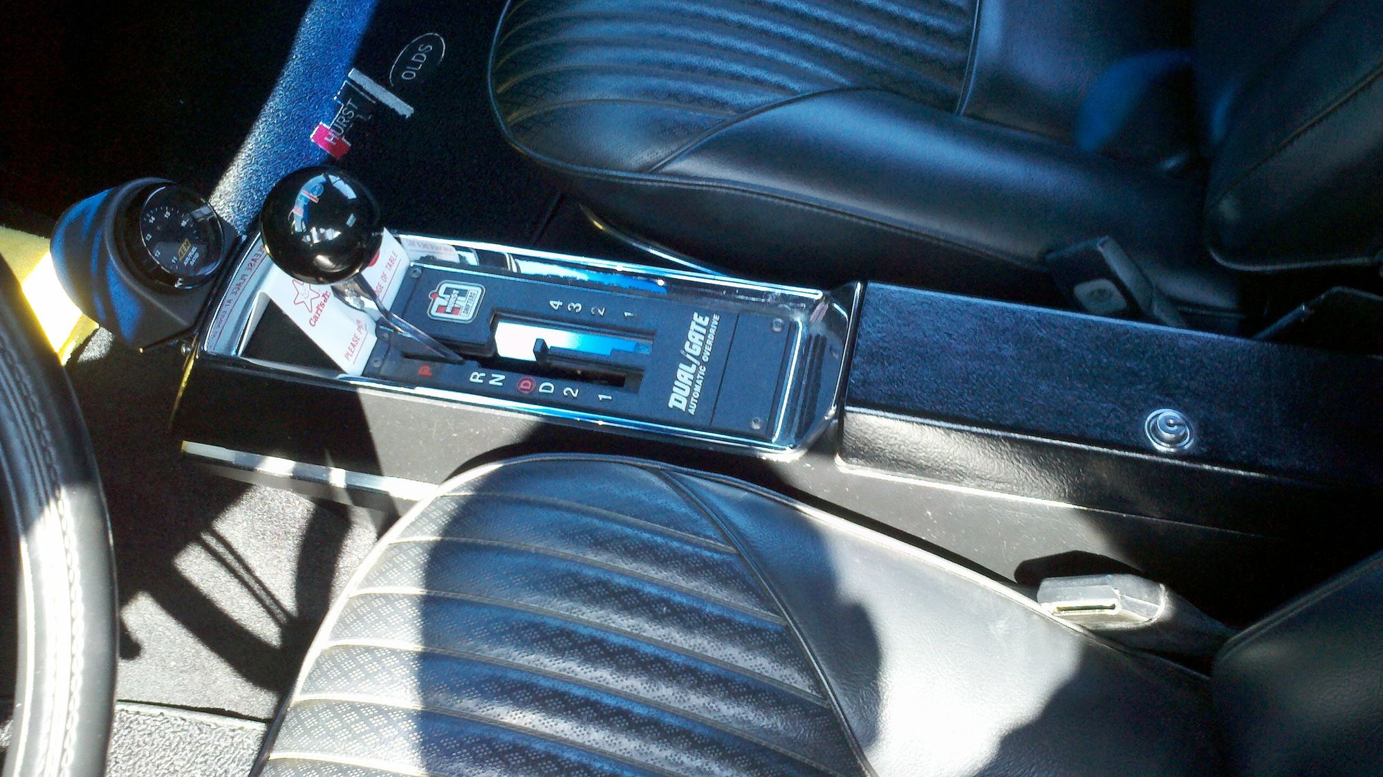

Saw this and thought about this thread. Hurst dual gate 4 speed shifter, not mine.
https://www.ebay.com/itm/Rare-Hurst-...b819%7Ciid%3A1
