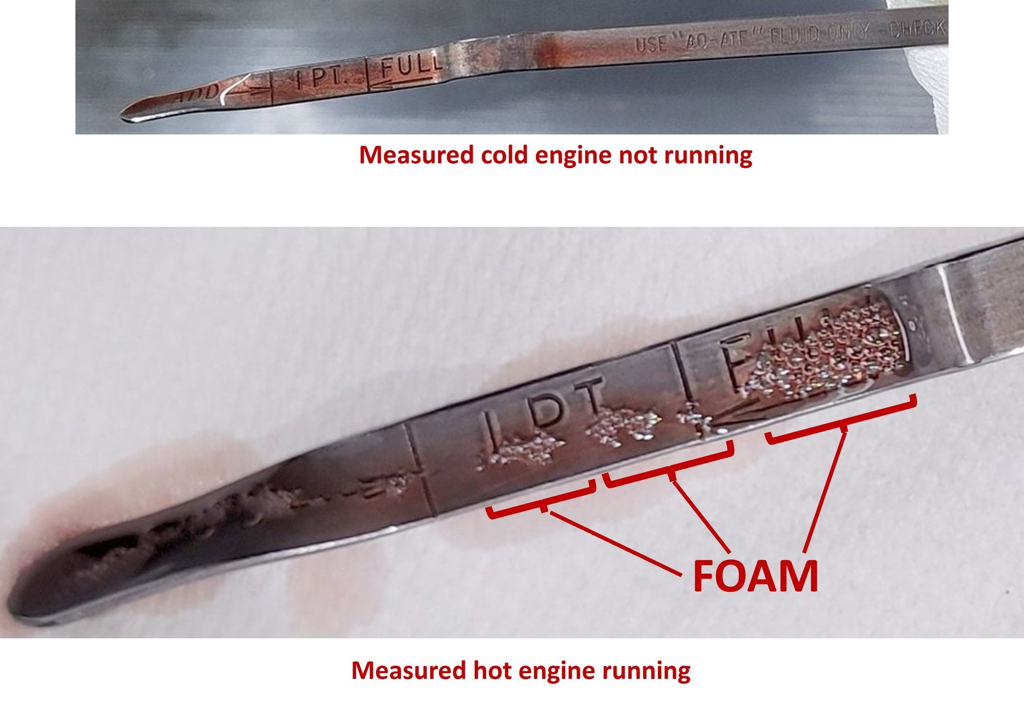

Hi all, on my 67 Cutlass, I've been seeing ATF on the ground when parked. Usually end up seeing it most after coming back from a long drive. Decided to check the level and below pic is what I have. Is this overfilled- I take it it is heh?
I wiped the dipstick clean after this pic and had a similar result. The car has been sitting a good week at least.
I also notice, maybe related or not- when accelerating from a stop it takes a second or 2 before I want to say things "catch" and the car starts moving. No unusual sounds or anything that noticeable that way.

Yeah, it's overfilled. As Eric eluded ATF level is checked w/ engine/transmission at normal operating temperature, car on level surface w/ engine running. Noticing the transmission hesitate/slip from stopped position is also a classic sign of an overfilled condition.
Bottom-line: Eliminate the overfilled condition. Since we're guessing why the transmission is overfilled you have two options:
(1) With a handheld manual pump & hose inserted into the transmission fill tube, suck/withdraw (vacuum) ATF until you achieve the appropriate level; or,
(2) Drop the transmission oil pan cover, collect & re-use the ATF fluid (or start w/ fresh ATF), install a new transmission oil pan cover seal, re-install oil pan cover & follow the procedure exactly as described in the 1967 Oldsmobile Chassis Service Manual (CSM).
NOTE: You can't remove all the ATF since the torque converter retains ATF (you can't drain the torque converter). Therefore, when examining ATF quantity as outlined in the fluid levels of the 1967 Oldsmobile CSM, be mindful if you're considering/thinking about how ATF fluid quantities might appear to not make sense, you can only change fluid which resides outside the torque converter. Just keep this in mind. At the end of the day, car on flat level surface, engine/transmission at normal operating temperature & measured w/ engine running.

To answer one of the OP questions, that is showing way overfilled. Pretty sure the procedure for checking fluid level is stamped on the dipstick. Engine/trans at operating temp, engine idling with the transmission in park.

Well thanks for all the info here... I have a pic of it now when the car was running / warmed up. Went through the gears and back to park and looked at the dipstick. Thinking as others mentioned it is overfilled for sure?

Yes. Additionally, very common to witness foam (air bubbles) when overfilled.
