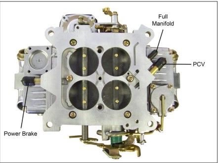

It's hooked up to the port on the carb below the throttle blades.
Old Sep 12, 2024 | 05:20 PM
  #35
Posts: 25,960
Bottom line is the transmission needs to "feel" engine load. This is accomplished via connection to manifold vacuum not ported vacuum. If you're connected below the throttle plates then you're connected to manifold vacuum.
Old Sep 12, 2024 | 05:25 PM
  #36
72455's Avatar
1972 U code Supreme
Posts: 4,088
From: Chesapeake, VA
That's what I thought Norm...and just to clarify, it's the port just to the left and slightly above the port for the pcv hose...not the timed spark advance port.
Old Sep 12, 2024 | 05:29 PM
  #37
Posts: 25,960
Double-check your carburetor manual - I think you have an Edelbrock? I'm not good w/ Edelbrock carburetors. So, I'm not 100% on how a Edelbrock (or any of their models) is/are configured. If it's below the throttle body on a Rochester Quadrajet, it's full manifold vacuum. Double check to be sure, but the modulator line wants full manifold vacuum.
Old Sep 12, 2024 | 05:30 PM
  #38
72455's Avatar
1972 U code Supreme
Posts: 4,088
It's a Holley 770 Street Avenger...hence the diagram I provided above.
Old Sep 12, 2024 | 05:40 PM
  #39
Posts: 25,960
Dave - The diagram you provided doesn't show the full manifold vacuum port - it's hidden; albeit, not a very convincing diagram.
Here is the full manifold vacuum port on the Holley 770 Street Avenger.
Old Sep 12, 2024 | 05:48 PM
  #40
Posts: 25,960
Capisce?
