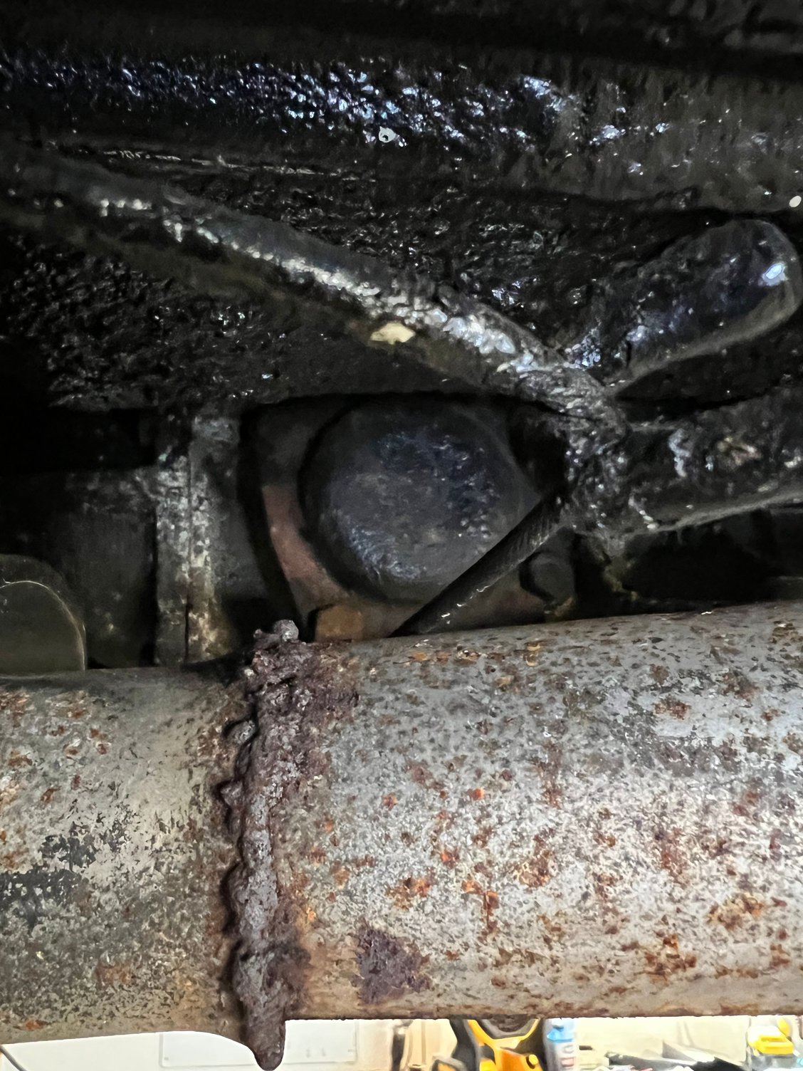

Does anybody know if I pull that governor cover off will all the trans fluid come pouring out ? Thinking about looking at it this weekend

I had the car up on a lift and I think I can get the cover off but not sure if there’s enough clearance to actually slide the governor out with the exhaust . I was doing some other things while it was on the lift so I didn’t try . Gunna take another look soon though and give it a shot . Will update then.

The governor is about 4-5 lunches long. I’m betting you have room to pull it out.
