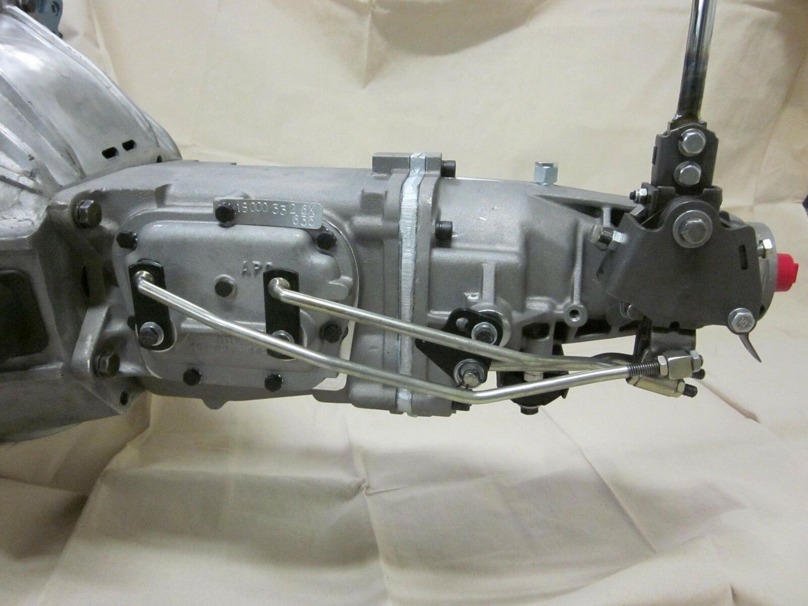

A few weeks ago we got the car from a dealer and he said it has been running for the las 12 years he had it. Got it home and he called us saying it was ready to hit the road. My husband notice the gears were sort of difficult to shift, but he thought it was part or the classic aspect. The problem is, after an afternoon driving around, we put the car in the garage and now it won’t shift to any gear. Is this the transmission oil? And if so, how can I find the opening to check it? The car is behind our daily ride, blocking it, so we can’t get any car out. We called a classic’s car mechanic, but so far no return. Please, help!

Is there any evidence of transmission oil leaking? I would check the linkage first.
Old Nov 10, 2021 | 09:10 AM
Posts: 42,475
There is a pipe plug half way up the transmission case that is used for filling and checking level. Remove the plug and place your index finger into the hole with your finger bent at the first knuckle. You should feel fluid at the tip of your finger approximately 1/4 - 1/2 inches below the fill hole.
Is it just not going into gear or does it grind like hell trying to get it into gear with the engine running? With the engine off it should shift into all the gears with the clutch depressed.

The first thing to do is to get under the car and have someone move the shifter. See if the transmission arms actually move correctly.

If you can't push the clutch in and roll it backwards it isn't a linkage issue, its a clutch issue
