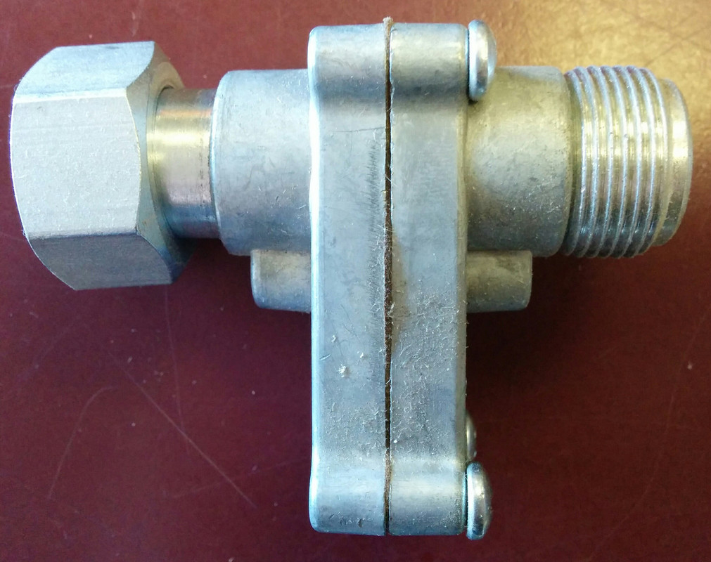

Simple Speedometer Correction

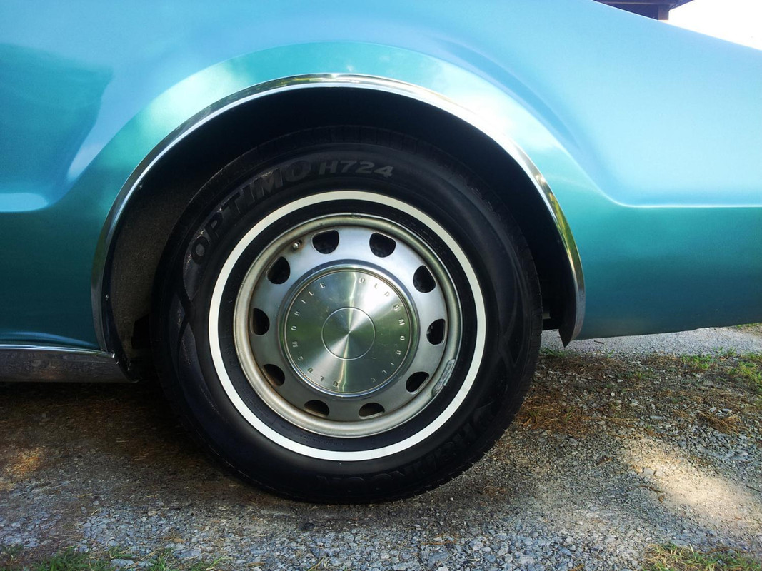

I figured I would share this since most of us have speedometer issues. I purchased Handkook 235 R15 tires. Even though these are the same size of the original tire, they are radial tires. Unlike the original hard nylon or Polly glass tires that came on it new. The radials give with weight making them actually smaller. At a reading of 70 mph my phone GPS showed 63 mph. So, it was off by 10%. I ordered a gear ratio adapter that was pretty much plug and play… I ordered the one that reduces speed by 10%. This pretty much corrected my speedometer.
Ratio is 0.900 (10%)
(Actual Speed)/(Displayed Speed) = Ratio
Here is the link where I got mine. You should be able to get this at other places or at a local speedometer shop. These are very common and mostly used on road trucks to correct for different transmissions.
https://transmissioncenter.net/shop/...ratio-adapter/
