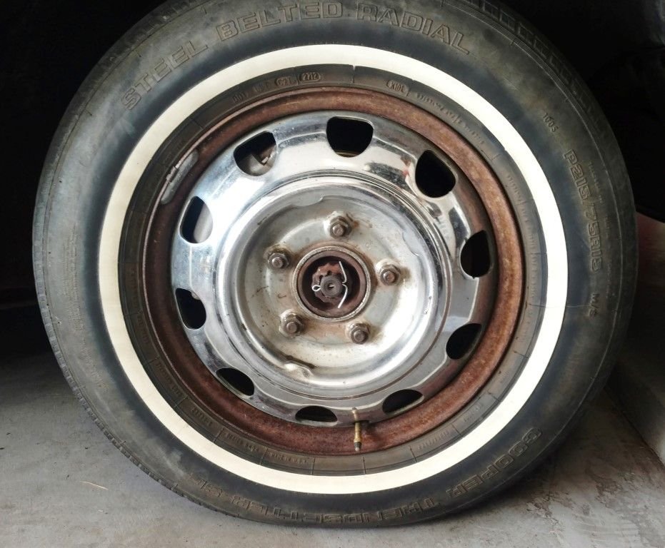

Here's one of the original wheels without the wheelcover. Not pretty. In addition to full-size covers, I also have the smaller, dog dish-size covers that go over the center part, but I don't like to put them on because that leaves the rusty part exposed. I know I won't be able to use them with new wheels, but I can't use them now, so it's not really a loss.

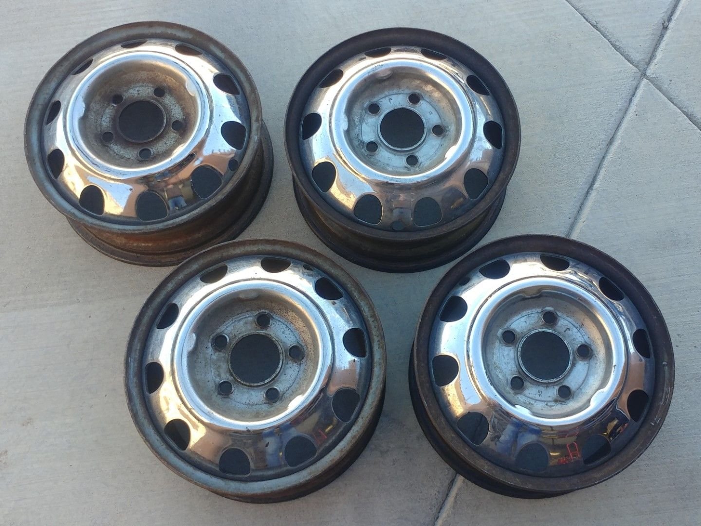

Here's a photo of one of the ones I bought. The others are in pretty much the same condition.
Most of the Toro and Eldorado wheels I found look like this, with seven large openings. The rims on my car have a larger number (10) of smaller openings. It's also chrome plated in the center part but the plating would need to be redone if I want to show the car with these wheels and the smaller hubcaps on. I presume the 10 versus 7 openings is just a cosmetic thing. I have no interest in using the smaller hubcaps as I purchased a few months ago a set of NOS full wheelcovers for this car (there's that "make offer" thing again!). They were never used and look great, and I want to use them as I think the car looks much better with them. So I am not in a big hurry to have the chrome-plated portions of the wheels I have re-plated.
Here's another peculiarity I came across. On this wheel, note the gap between the red arrows. This is apparently from a first generation Toro, maybe a '66. Maybe this wheel is meant to have the "beauty rings?" In any event, the presence of that gap means that the diameter of the inner part, where the decorative openings are (orange line), is smaller than on the wheels above, so that means there's less room underneath for the brake hardware. Note also the different position of the valve stem opening (yellow circle). So even though this wheel has the same number of decorative openings as my wheels, it's not the same wheel. I don't know if this wheel would work on a second-generation Toro.

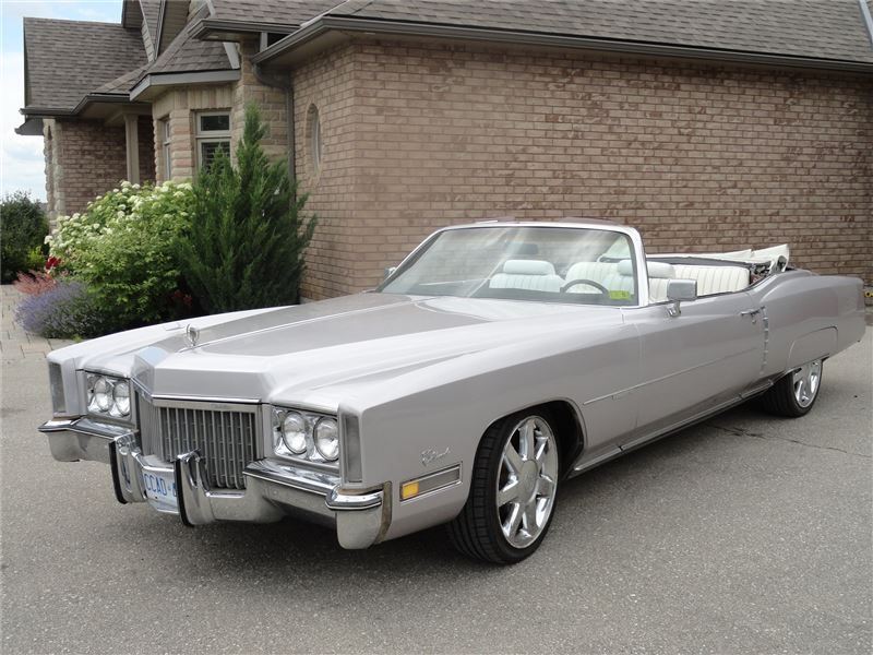

Jaunty, thought I would share with you a photo of my Eldorado with some really neat chrome rims and low profile tires from a later model Cadillac that I tried out. The bolt pattern matched but the offset was wrong. What a big mistake! While it looked great, due to the low profile tires the ride was terrible and hard and you felt every bump in the ride. What was even worse was the wrong offset made it difficult to turn into my own driveway as the tires would scrape the fender lip. I had to have the torsion bars cranked to raise the front about an inch to get clearance ( not done in this picture) and that not only changed the stance but made me feel like I was driving uphill and straining to see the front over that long hood. So best that you stick with stock wheels and hubcaps with decent sidewall height on the tires to preserve that soft plushy ride.
I've always thought this would be the case with these tires and wheels that are not much different from bicycle wheels. Don't you risk bent rims as well if you hit a particularly large pothole, bump a curb, or something like that?
Old Dec 29, 2018 | 10:39 AM
ByronF's Avatar
Joined: Nov 2017
Posts: 278
From: Brighton, Ontario
Quite possibly because with the lower profile tire you feel like you are riding on the rims. And those fancy rims are lighter and aren't made anything like the big heavy steel rims that came with the car originally. My bigger concern however was the wrong offset was according to GM putting undue strain on the front bearings and other front end components on this big heavy FWD car. The last thing I wanted or needed was to create front end problems on a car that is hard enough to find affordable parts for at the best of times.

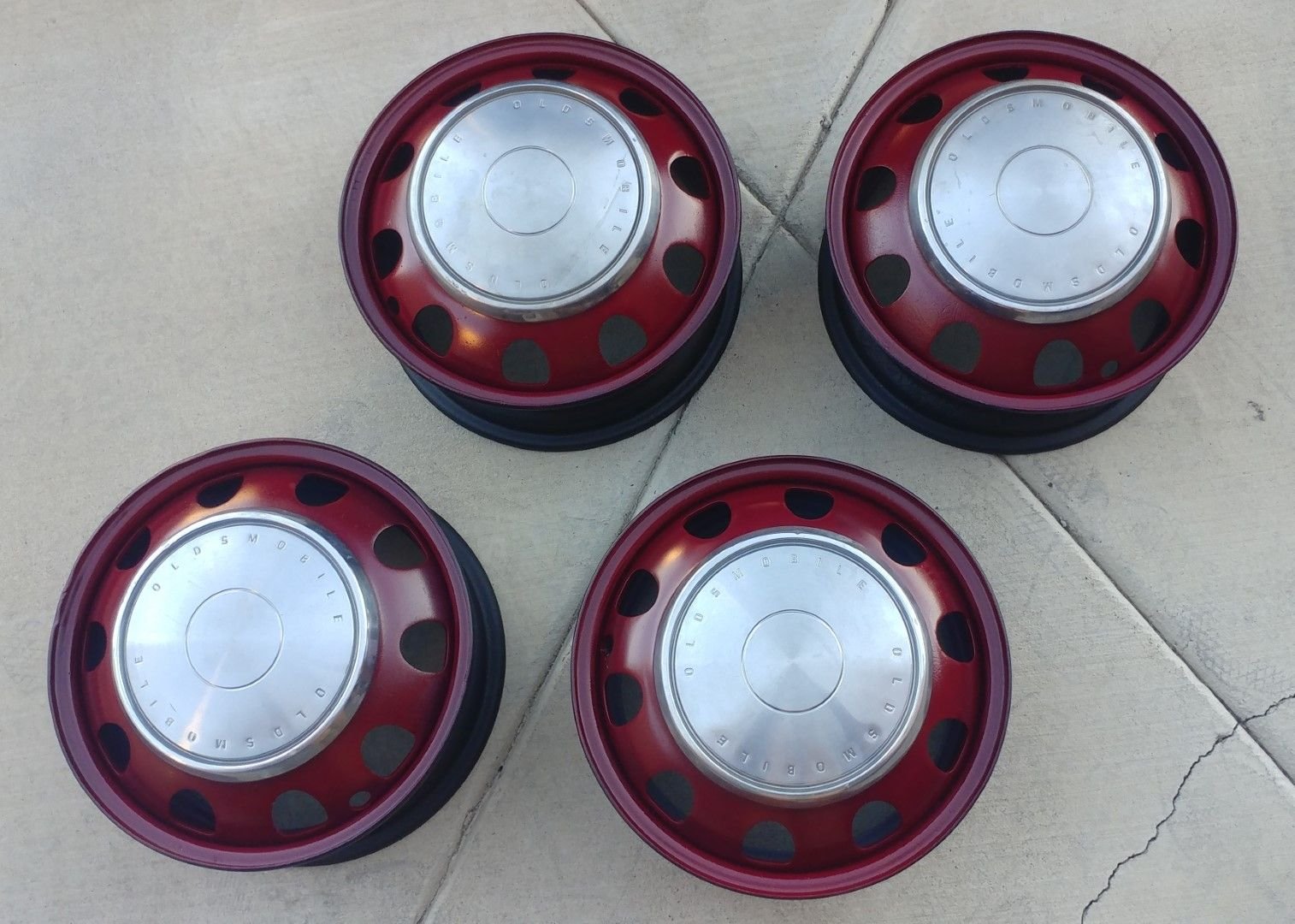

I did finally get all four ebay rims, three from one seller and the fourth from another. Paid about $60 apiece plus shipping for the three and $45 plus shipping for the fourth. I wire-brushed them clean of grit and dirt and then sprayed some paint on the visible side. I think they cleaned up pretty well for 30 minutes work. Later in the week I'll get a chance to have the tire shop swap the tires onto the replacement rims.
Before and after.

The mounting of the tires onto the replacement wheels went off without a hitch, and the placement of the weights turned out to be a non-issue. For my wheels, they just put the weights on the back side. When I was talking about the issue with the fellow at the shop (I went to Big O Tire, which is where I bought the tires that are on the car), he told me that they deal with wheels with restrictions on where weights can be placed all the time. He pointed at the wheels on my truck, a 2013 Nissan Frontier, and told me that the wheels on it have no place to put weights on the front side of the wheel, and they don't easily on the back side, either. He said that in that case they use what he called "weight tape", which is apparently something like lead tape (but probably not actually with lead in it) that they can put pretty much anywhere on the inside of the wheel. The bottom line is that there are all kinds of ways to attach weights to wheels, and they would have no trouble dealing with mine. I just wanted to make sure there were no clamp-on weights on the front side of the rim.
The wheelcovers attach beautifully, and here's a few photos of the finished products. Not that you can see the rims, which you can't, but you know they're there. I scrubbed the whitewalls as best I could, but I don't think they'll ever be white white.
I took a photo of the two front wheels before I put them on the car (and before I washed them) so you can actually see the rims. Exciting, I know. But note, no weights!
The back side of one of them.
Yes, I know, these photos are about as exciting as watching paint dry, but this really is an issue that I am pleased to have finally resolved. I've never been happy with the wheels that came with the car as they are very rusty, and getting a good seal when the tire is mounted is always a concern. But not with these replacements. Well worth the money spent.

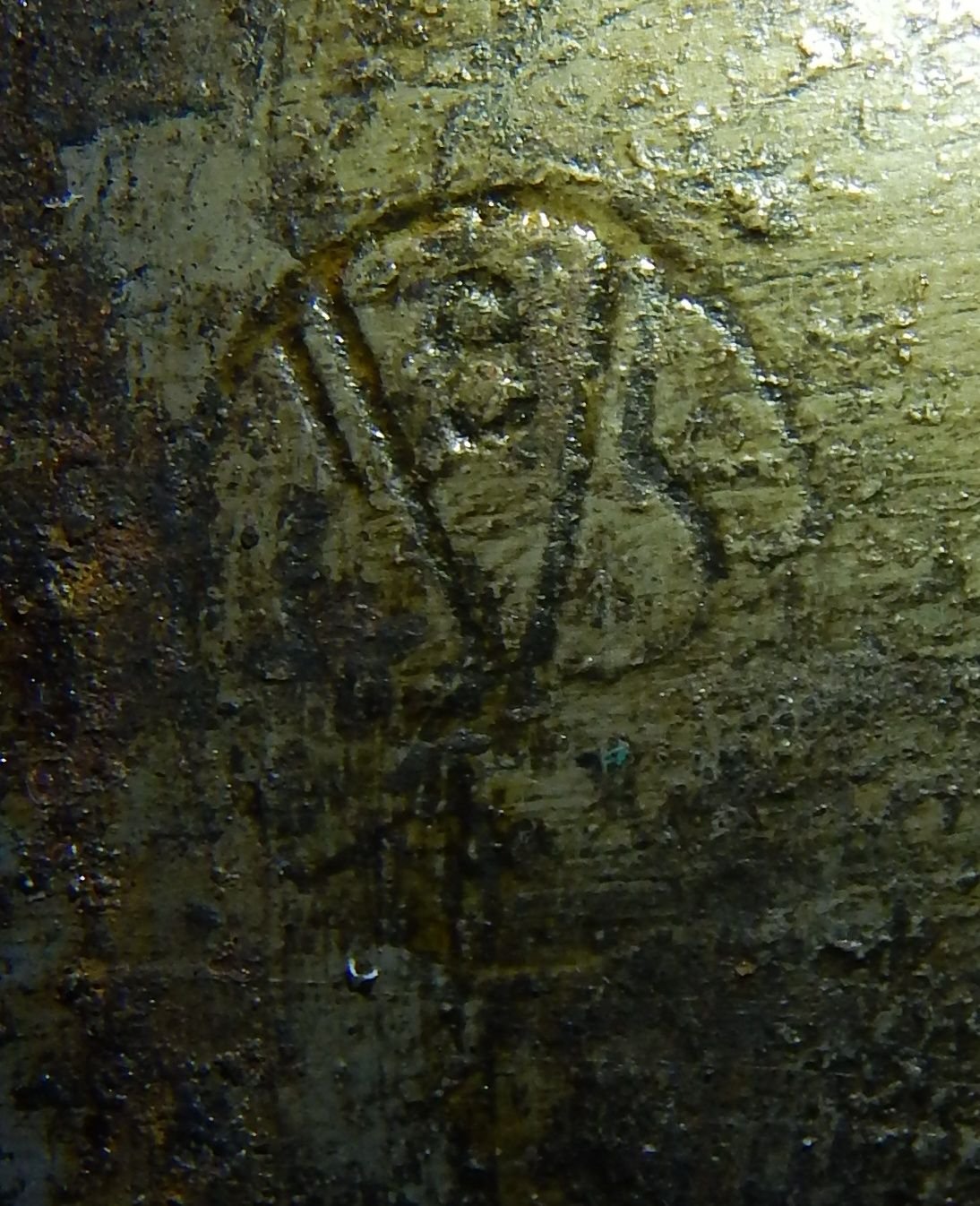

Originally Posted by 2blu442
I'm sure there's a code on those somewhere that would key out what the manufacture year was.
There's not a lot that I can find stamped into these rims. One of them is noticeably less rusty (but still pretty rusty) than the other three, and I can make out a stamping in the center part of the rim. It say "15 x 6 JK" and then below, at an angle "67". Then something to the right of the 67 that I can't make out. This is the only rim of the four where I can make something like this out. The others are too rusty. Does the 67 mean 1967?
The only other markings are on the center parts of the rims by the lug openings. There's a "J" in the lower left and a "K1" with a "7" below it towards the top. All the rims have something like this. One of them has a K1 with an 8 below it instead of a 7.
Then there's this, which is on the same wheel as has the "67." Looks like something from the Da Vinci Code. It's a circle with a V at the top with an 8 inside it, and then a line on each side of the V that starts parallel to the V and then bulges out before curving back to the point of the V. As I say, I'm sure Robert Langdon could figure it out.

Here they are, painted with a maroon gloss spray paint. I painted the insides and edges (where the tire goes) in flat black.
Here the are with the center caps that fit on them. I was thinking a blackwall tire would look good with these. Your eye would then be drawn to the wheel and not the tire. I could have two sets of wheels/tires for this car, one with the newer rims I just got and the full wheelcovers as I've shown above, and a second set of wheels/tires with these rims and the small hubcaps. Then I could switch them out every few months, and it would be like have two pairs of shoes for the car.

Those wheels are actually not the same as mine as they have a gap between the decorative chrome-plated part and the edge of the wheel. Here's another photo of the same wheel showing the gap (red arrows). The diameter of the large, center part that fits over the brakes is thus smaller (orange line), and the valve stem mounting hole is a different design (yellow circle).

My car is a '78, but, yes, those chromed rims that I just repainted red fit just fine on my car which has front disks. They're the wheels that were on the car when I bought it.

Here's a wheel with dog dish and hubcap that's on a 1969 Toronado
Then here's another one off the same car that I popped the trim ring off of. I plan to use these on my car, but just to give you an idea that there out there if you wanted to try a set on your car with the burgundy wheels.
