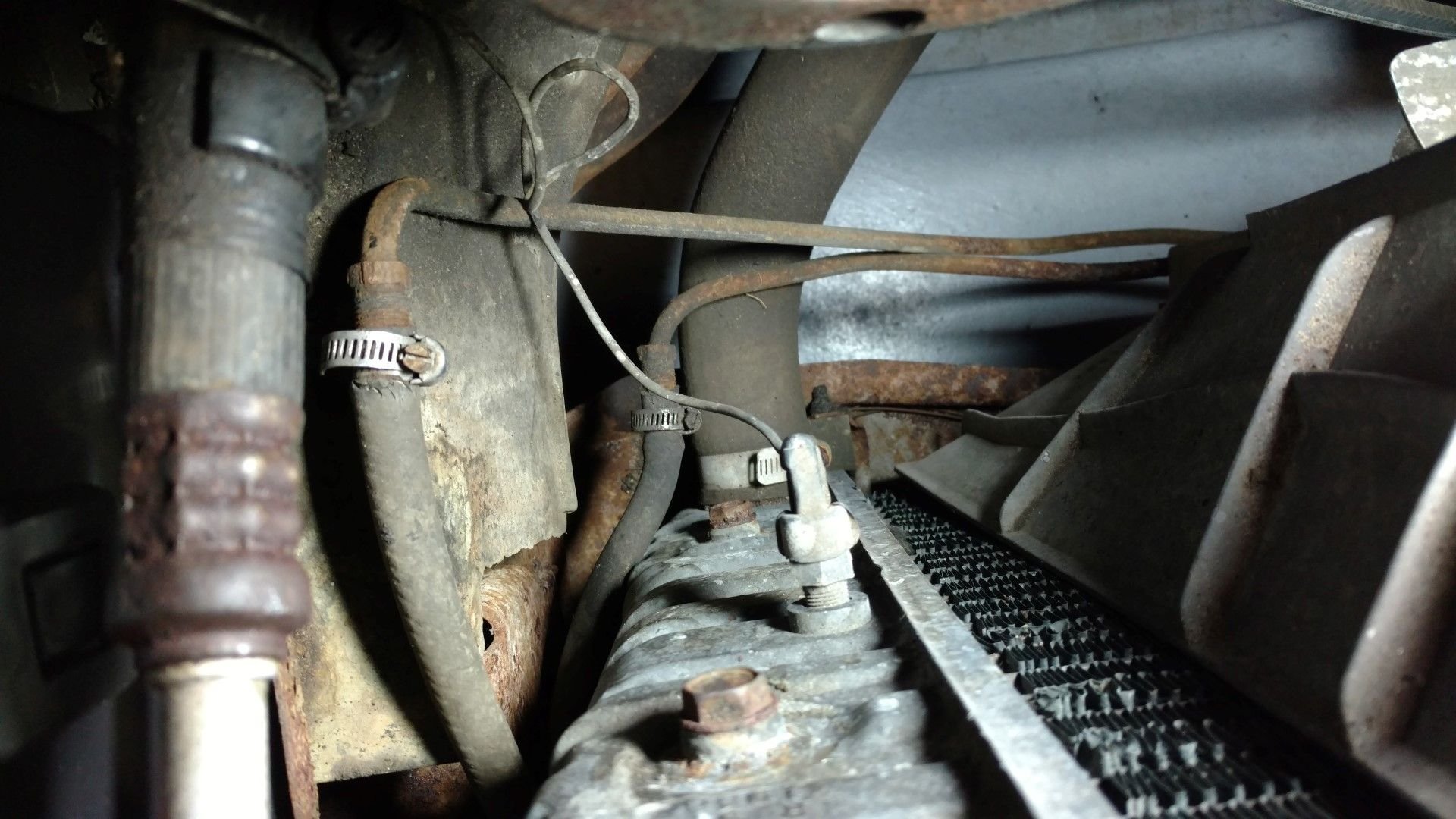

Also, this car looks to have had some sort of aftermarket transmission cooler added. The transmission cooling lines have been removed from the radiator, and rubber hoses have been jammed onto the ends of the lines over the threaded fittings and attached with hose clamps. These hoses attach to a radiator-looking thing behind the grille in front of the radiator.
Here's the situation with the cooler lines. Note that the places where they would attach to the radiator have been plugged with bolts. I'm assuming that those bolts have ruined whatever thread was in those openings so that I couldn't reattach the cooler lines to this radiator if I wanted to.
You can also see, towards the left, how the rubber hoses, which don't leak but do look dried and cracked and probably should be replaced, are attached to the threaded fittings on the ends of the steel lines.
Here's the radiator thingy the rubber hoses attach to.
What is the point of doing this? It certainly doesn't look factory, and the factory did, I'm sure, offer a towing package with heavy-duty transmission cooling which this car doesn't have. Was this a way to get better coolling of the tranmission? Would it actually work better than the normal cooler, which is the radiator? Is there any harm if I did get a new radiator and got rid of this setup and just used the normal transmission cooler on the radiator?

It may have a bad internal to the radiator trans cooler that leaked ATF into the cooling system, or coolant into the trans. Have the internal cooler checked when the radiator is checked. The external cooler probably does a much better job in the hot climates than the internal radiator cooler.

Pull the bolts out and see if it leaks. They are very short (flare fittings) and possibly did not damage the fittings. If there is no leak then see if the lines can be threaded back in. Either way if your keeping it as is, those nasty cracked hoses need to be changed.

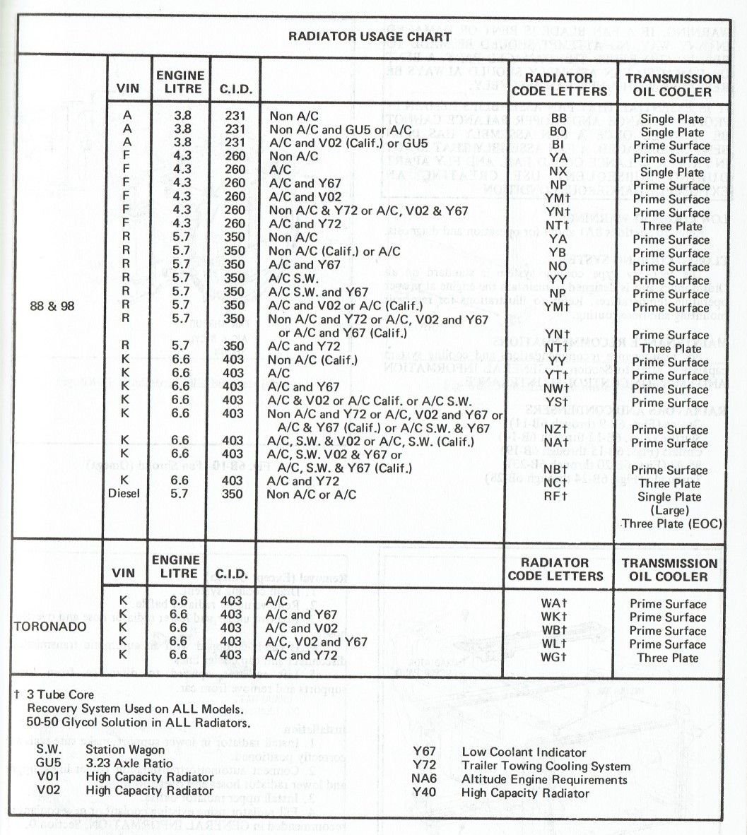

Here's the relevant portion of the radiator usage chart from the '78 service manual.
I'm pretty certain I have the second case down there in the Toronado section, A/C and Y67 with radiator code letters WK. The car does have a low coolant indicator, which is what Y67 indicates, and it does not have a high capacity radiator (V02) nor a trailer-towing cooling system (Y72), at least according to the dealer invoice on this car I obtained from the GM Heritage Center.
If you now go look at the various 88 & 98 radiators, the third one listed under VIN K is the same thing, A/C and Y67, but it has a different radiator code, NW. Both are 3-tube core radiators (what the little dagger means). So the radiators apparently ARE different, but how? Width? Length? Height? Color?
The other thing I notice is that there are a total of EIGHT different radiators shown for the 88 & 98 with the 403 depending on options, all with different code letters. But when you go to a site like Rockauto or NAPA, they don't give you a choice of eight different radiators depending on which of these options you have. These sites just show ONE radiator for a '78 98 with the 403 engine.
If ONE radiator will fill the bill for all of eight different possibilities for the 98, maybe that same radiator will work on my car. I'm tempted to buy one from Amazon, which gives you no hassle at all in returning something and who also pays for the return shipping, just to see if it would substitute.

Possibly, the internal cooler is basically a coiled tube with an inlet and an outlet. It is surrounded by coolant. If there is a leak in the tube which I have personally witnessed before, a lot of coolant winds up in the transmission. Remove the bolts and check it both cold and hot when the radiator builds pressure.

I did a little more checking just now regarding the 98 radiator. According to Autozone's site, the replacement radiator is 30.5 inches between tanks. I measured mine just now, and it's 35 inches between tanks. #@$%!

The plugs look like the ones used/supplied when a rad is put in a manual transmission car without a cooler. The point is that they may be the correct thread and not have damaged the threads in the radiator.

I tried to search for a radiator GM part number to cross reference it with other GM models, but the parts catalog does not list the E-Body (unless I am over looking something)... There are four PN's for B & C Body but not the E-Body and all references are leading to use the radiator production code which consist of two letters as shown in your post illustrations... If you list the code of your radiator (located either on a tag, or stamped into the fill tank), I may be able to find a GM part number thru my system and cross reference it to all other vehicles that radiator may fit...
Are you referring to the two-letter code in the chart above, or to a part number? I'll see what I can find.

OK, some updates. I told the relatives to excuse me, I'm going into the garage for a few minutes. I grabbed a socket and ratchet and removed one of the plugs. Sugar Bear is correct. It is a correct plug for this fitting, and the threads are not damaged. It appears that I could reattach the coolant lines to the radiator if I wanted to.
When I removed the plug, no fluid of any kind came out, and everything looked dry, so I'm assuming the add-on transmission cooler was installed as a precaution against an overheating transmission and not because of any problems with the radiator.

The hose doesn't go over the threaded flare nut. It slips over the flared end of the metal line and is clamped in place. The flare nut doesn't seal to the tube anyway. As configured, it's fine, as the flare on the end of the steel tube provides a retention feature for the clamped hose, but if you want to change to the barb fitting, you must use a fitting with a female inverted flare, not pipe threads. I can't tell for sure, but the fitting in the photo appears to be pipe threads.
It should be one of those listed in your chart if the radiator is factory and hasn't been changed with a replacement some time in the past...

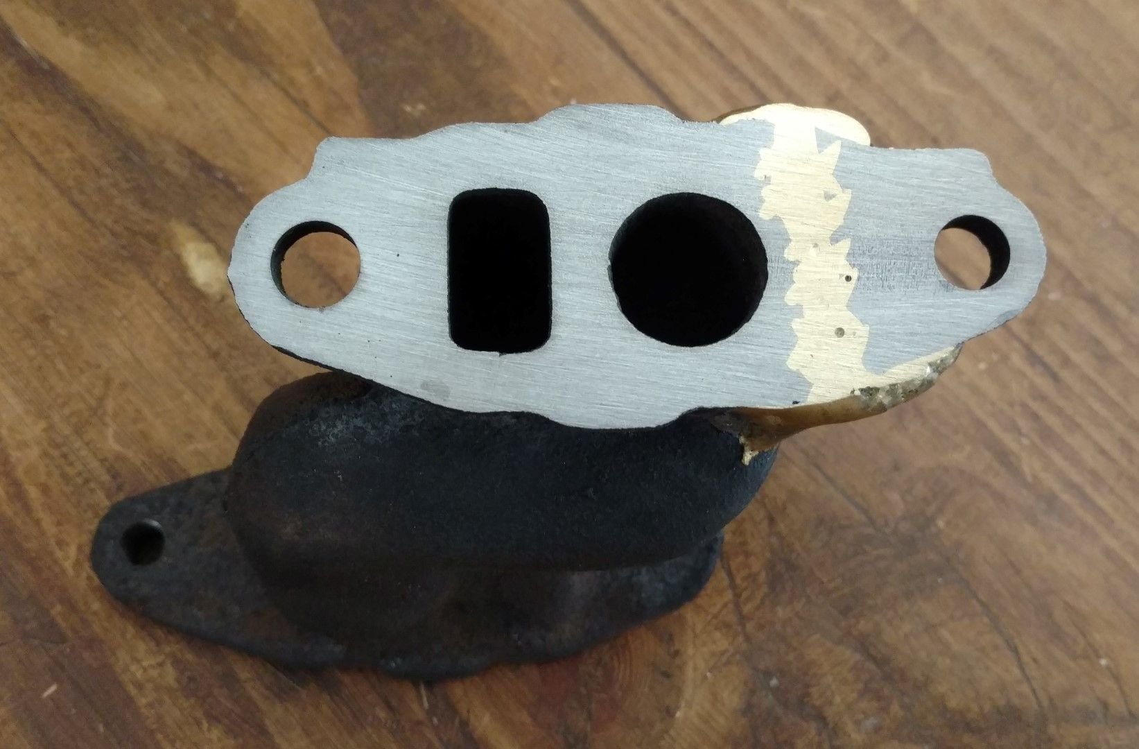

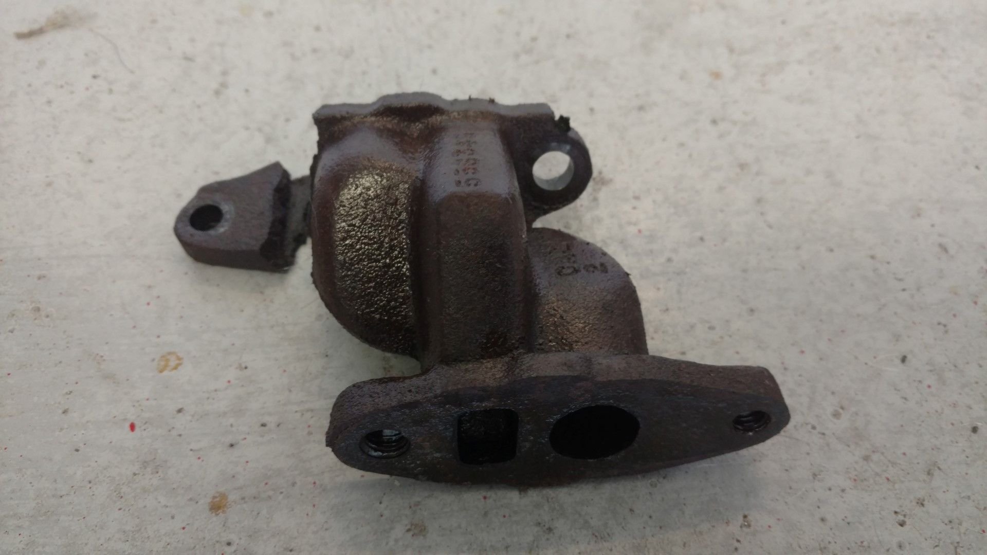

The other two problems that arose concerned the EGR valve and the choke stove. The two pipes coming out of the choke stove both broke off when I tried to remove the stove from the engine, and I broke both of the bolts that hold the stove on the intake when I tried to loosen them with a breaker bar. I have since drilled those out and re-threaded them, so I think I'm good to go on that. Just waiting for a new stove and pipes from Fusick to arrive.
The EGR problem concerned the mounting for it. This car has an unusual adapter that sits on the intake and that the EGR mounts to, and it broke into two pieces when I removed it. One of the mounting ears broke off.
I've since had it repaired at a local welding shop followed by a machine shop to deck the mounting surfaces, but this took a week to get done (plus $75).
But we are now close to having everything ready to put back on the car and try again. I still also have to connect the 7.5 miles of vacuum hose, but progress is being made.

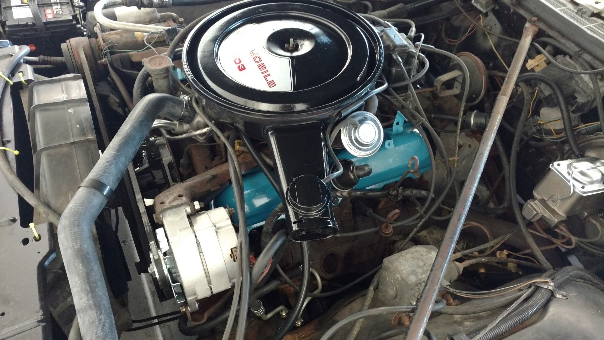

To conclude this story, I put what vacuum hoses I could (more about that in a moment) back on the car and started it up. Success. It started fine and ran smoothly, even at low idle. Drove it around the neighborhood with no problems. No stalling, no coughing and stumbling, no black smoke, required only minor adjustments to the idle mixture screws.
But I still have vacuum line issues. The entire air cleaner vacuum system ("Thermostatic Air Cleaner") is disconnected and cannot be reconnected because the vacuum hose barbs on this temperature sensor/vacuum switch thingy (stop me if I'm getting too technical), which is attached to the air cleaner on the opposite side from the snorkel, are broken off (second photo below). One of our moderators has been helping me with this car by selling me parts off of a '78 Toronado parts car he has, and I'm in the process of acquiring this part if it's good, which it looks to be in a photo he sent me.
Obviously the car runs and seems to run fine without any of this air cleaner vacuum system functioning, but it just seems that if I can get it back to factory configuration as much as possible, so much the better.
Here's a couple of photos of the broken piece. Exciting, I know. But stories are always better with pictures!
Here's a photo with the air cleaner reinstalled. While I was idling away the time waiting for EGR valve adapters to be welded and so forth, I painted the air cleaner cover, the snorkel, and the valve covers, and I put an "Oldsmobile 403" sticker on the cover. Yes, I know, that's not correct for a Toronado as there should be a blue "Toronado - Front Wheel Drive" sticker on there. The sticker that was there was a deteriorated mess, so I pulled it off. I have not been able to find a replacement sticker at any of the usual sticker sources (Fusick does not have it, but they don't have much for 1978 model year Oldsmobiles--what they DO have that fits '78 Oldsmobiles are things that are listed as fitting earlier cars but just happen to also fit '78s).
"Oldsmobile 403" stickers are available, and since it IS a 403, I thought that this is better than a blank cover. If I ever do come across the correct Toronado sticker, I can replace this one.
Here's a view from the side showing the new EGR valve on its repaired adapter. There's just enough room for it.
Yes, I used yellow tie-wraps to hold down the coolant overflow hose and to hold the fan shroud in place. I could have used black ones, so you'd hardly notice them, but yellow makes a statement, don't you think?
I had to use tie-wraps because the plastic part of the shroud that holds the nut in place when you insert the bolts broke off when I removed the shroud to get at the water pump, etc. I'll have to look around for a replacement shroud, but that's a low priority.
There is supposed to be a small metal tube that connects the grommet on the side of the air cleaner visible just above the EGR valve to the grommet on that valve cover filter or whatever it's called just below the EGR valve. I have that tube, but I've been removing and installing the air cleaner so much that I didn't want to have to keep connecting and disconnecting it. It will go on once I get all the air cleaner vacuum hose issues dealt with.
And, no, I don't have the spark plug wires attached to those little loom mounting points on the valve covers because all of the looms are broken. More little pieces to be on the lookout for.
