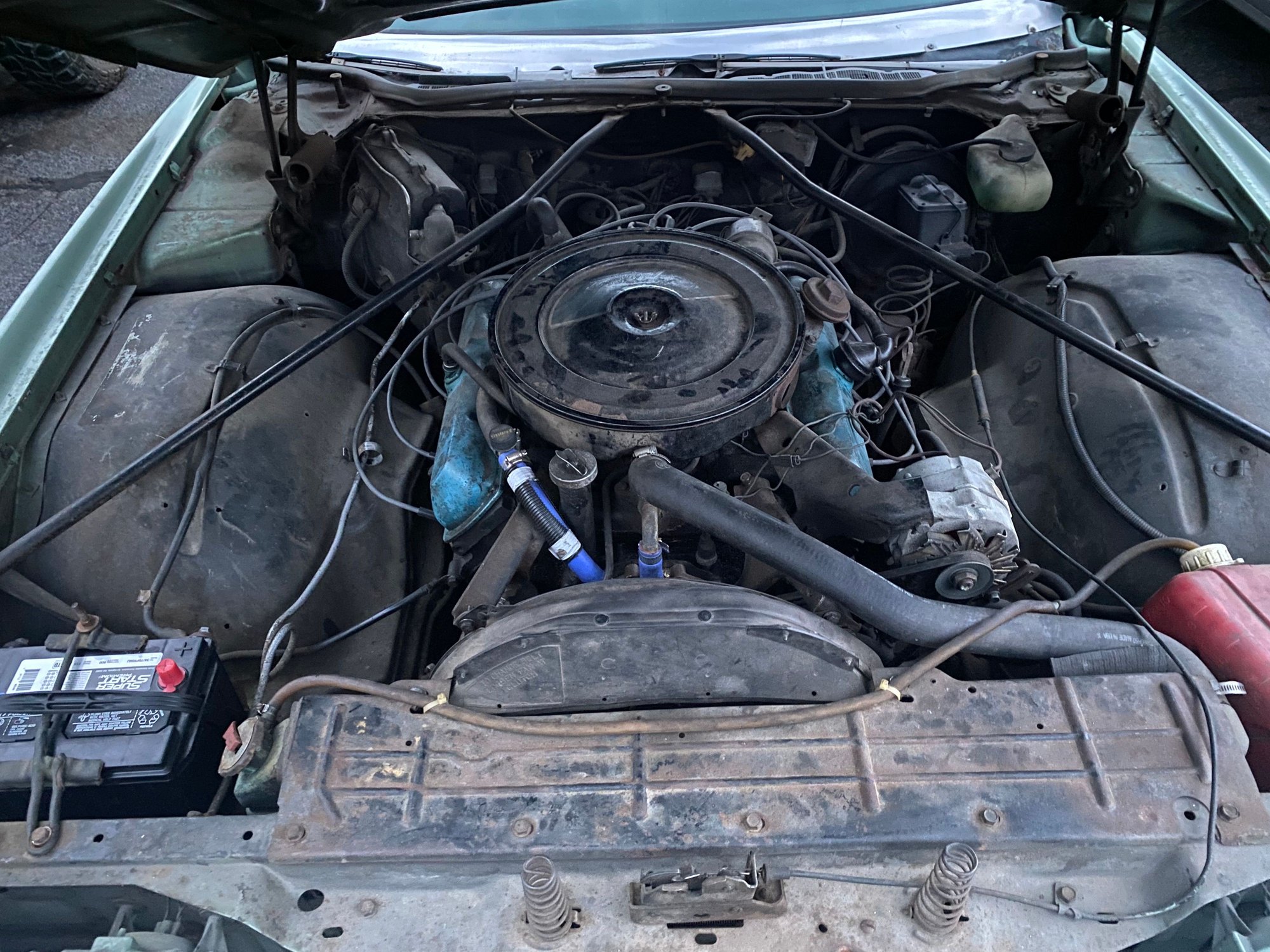

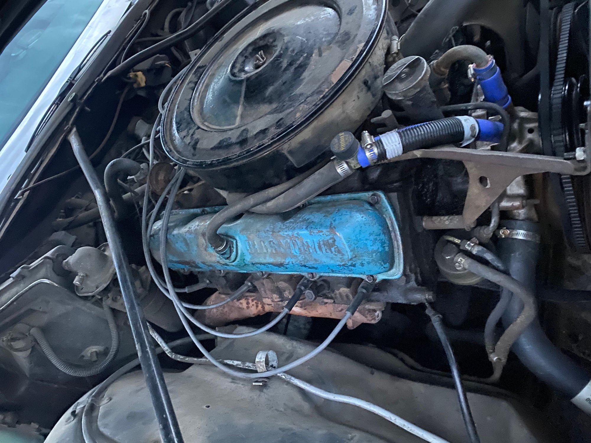

Hello! I’m a young man who just bought a toronado that’s older than my father. I thought it would be a fun car to work on and learn everything I possibly can about these 70s big blocks. It runs and drive nicely, and I’ve had a few of my more knowledgeable friends look at it and they’ve told me a number of things about the vehicle. It’s a 455 rocket, 70,000 miles, mostly original with some modifications I couldn’t specify myself. I might have bit off more than I can chew with this one. I’d like some ideas about how I could possibly learn more about this great car. I was also wondering what kind of manual I should get, as the cars original manual has been lost permanently. Please ask any questions and I’ll give you the best answer I possibly can.
edit: I’ve added some pictures for your viewing pleasure:

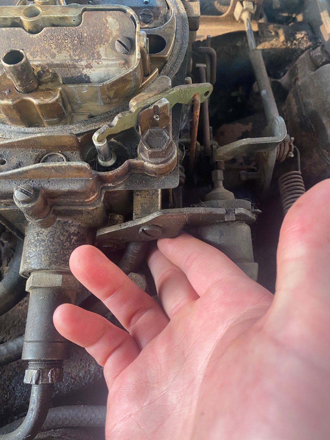

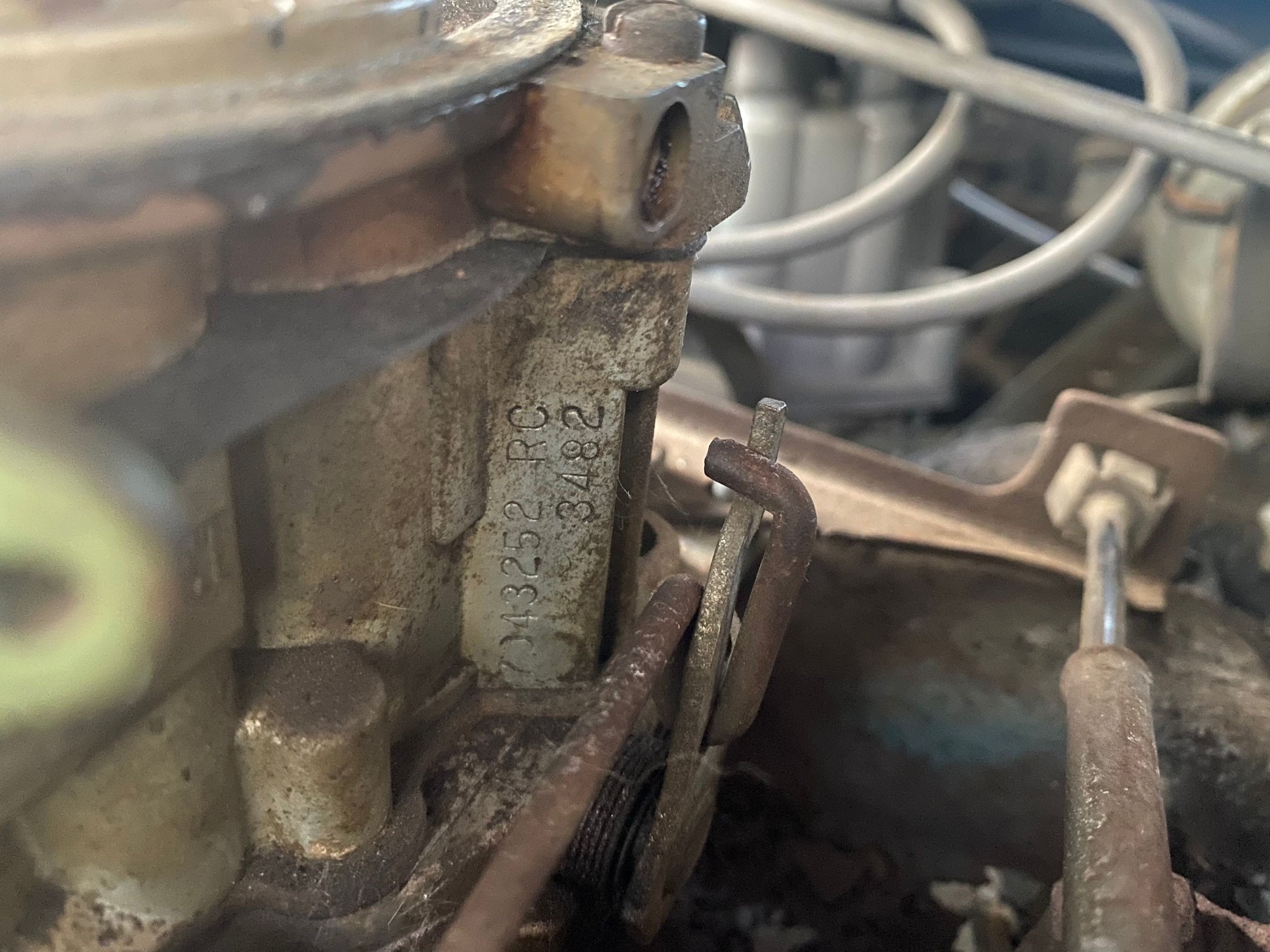

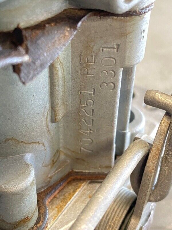

Carb Identification and Leak
After due consideration and thought on what everyone has said. I’ve decided to go through and find my carb stamp. 7030785 is the stamped number I found and it’s the number the guide I followed was pointing towards.
Also, I’m this is where I noticed liquid pooling under the carburetor, smelled like gasoline, I believe this area is under the vacuum break. the float bowl assembly may be the issue. Okay

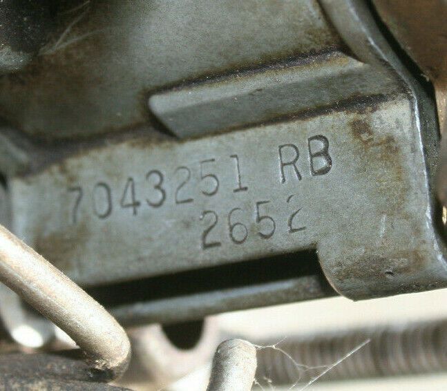

The carburetor number is located on the LH (driver side) towards the back of the carburetor. The numbers run (align) vertically (see red ellipse image below and several others by example). I believe that is the date/clock time stamp of the forged casting number you have posted.
BTW, I am NOT demonstrating the actual number of a 1973 Toronado 455 Rochester Q-Jet carburetor - only the LOCATION of the carburetor number.

You're close. That's the air horn casting number. Look at the driver side rear corner of the carb's float bowl. You should see a number like 7043252 stamped into it vertically. That's the carb application number and you need it to order the new carburetor kit and float.

Figured it out. Sorry about that I guess I mixed up the numbers 7043252
First, see if you can snug the hex head bolts and the slotted screws any. That might slow a leak, but my money says that carb hasn't been touched since 1973.
The thing you have your finger on is an idle stop solenoid. It increases idle speed or allows throttle plates to close off further depending on year and application. It should not be subjected to any carb cleaner or solvent.
The lever and shiny vertical shaft above your hand is the accelerator pump. Possible the rubber seal might be leaking a little.
Your little finger is on the fuel filter housing. Looks like someone's used vise-grip pliers on the flare nut. You need to be careful with the housing to avoid stripping out the inlet threads, which can quickly ruin yer day as well as the carburetor.

I don't disagree with snugging the hex bolts but don't over tighten them. I've seen many Qjets damaged from too much torque on those bolts.
